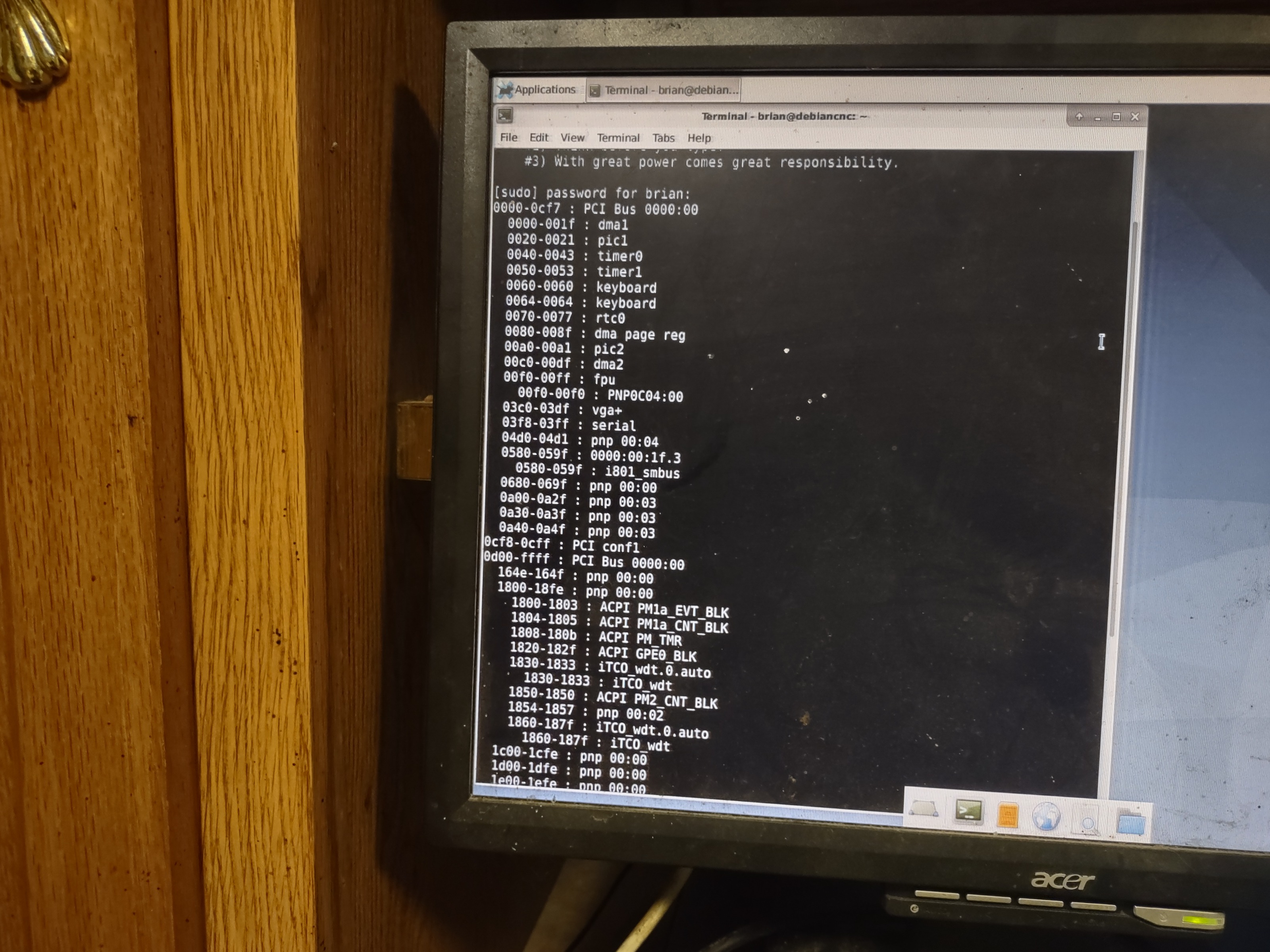

I am using a new to me I5 computer with very few ports, I have a USB to DB25 adapter and a sain smart 5 axis breakout board driving my CNC. I was using an older version and a computer that had a printer port on it. Now trying to set up the new system. I can't even figure out how to see if the new port is active, tried lsusb and got error. Does not seem to be recognizing the controller at minimum, and maybe not even the port. The Sain Smart I have uses USB for power but also a DB25 for data. I did put the DB25 straight to the Sain Smart, with no cable in between at this time.
Not sure if it's settings, the USB port, or the DB25 wrong and won't work.
Thanks for any help available. BTW I downloaded and installed the 2.8.2 - buster if that helps

In a terminal,
sudo lspci -v
What does it return? Look for parport.
If you can start LinuxCNC and it does not complain about missing port, check the header on the motherboard, it some cases it can be inserted in reverse.
sudo lspci -v

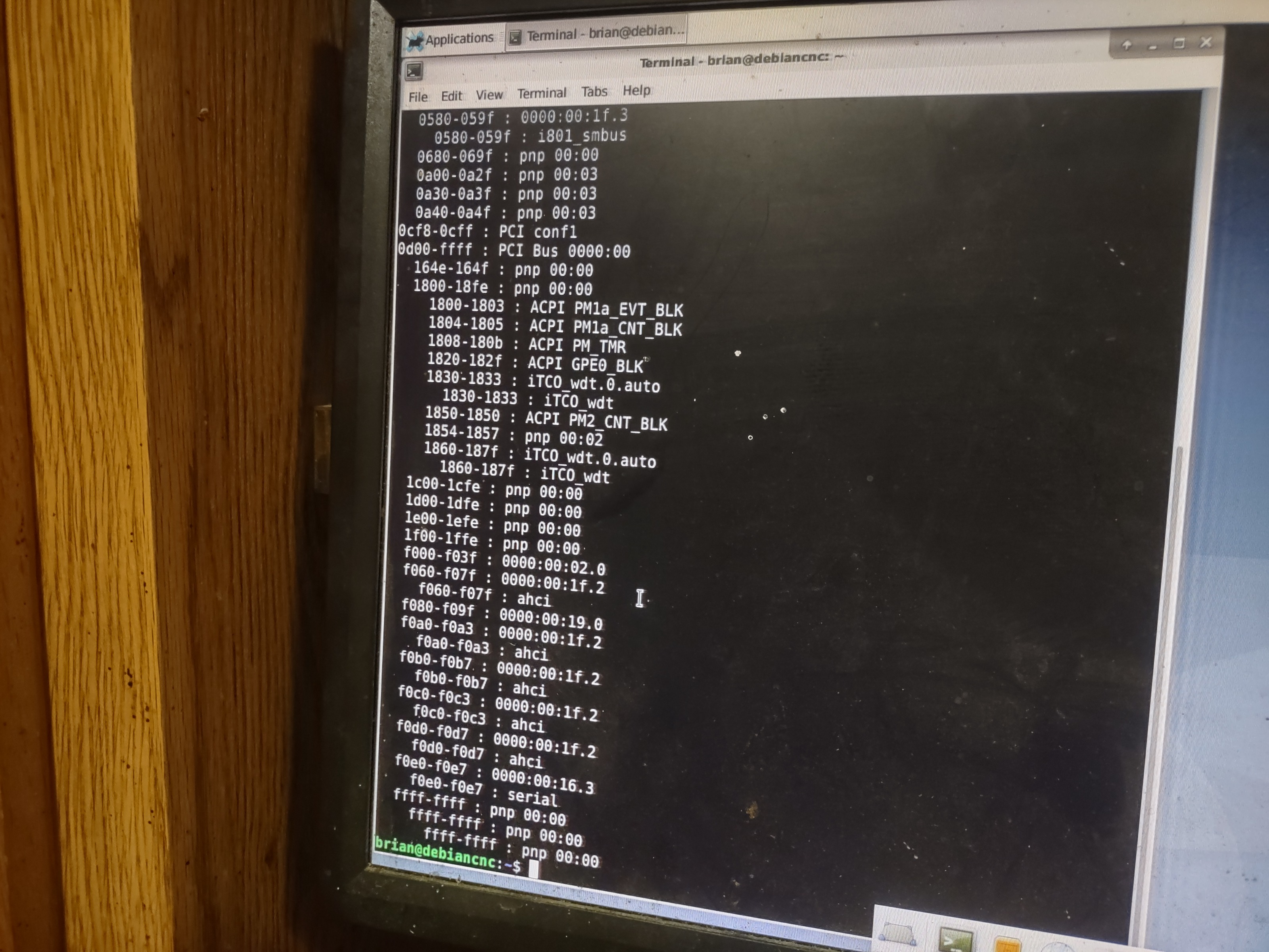

lspci won't (typically) show an onboard parallel port header, so try also
Sample output:
So this PC has a motherboard parport normal 0x378
But, also:
So the same PC also has a PCI parport at e030 (and I think that the PCI Express to PCI bridge is the 5i25 card that is also in this machine)
sudo cat /proc/ioports
Sample output:
andypugh@rm-one:~$ sudo cat /proc/ioports
[sudo] password for andypugh:
0000-0cf7 : PCI Bus 0000:00
0000-001f : dma1
0020-0021 : pic1
0040-0043 : timer0
0050-0053 : timer1
0060-0060 : keyboard
0064-0064 : keyboard
0070-0077 : rtc0
0080-008f : dma page reg
00a0-00a1 : pic2
00c0-00df : dma2
00f0-00ff : PNP0C04:00
00f0-00ff : fpu
0378-037a : parport0But, also:
andypugh@rm-one:~$ lspci -v
02:00.0 PCI bridge: Texas Instruments XIO2001 PCI Express-to-PCI Bridge (prog-if 00 [Normal decode])
Flags: bus master, fast devsel, latency 0
Bus: primary=02, secondary=03, subordinate=03, sec-latency=64
Memory behind bridge: f7d00000-f7dfffff
Capabilities: <access denied>
04:00.0 Parallel controller: Oxford Semiconductor Ltd OX9162 Mode 0 (parallel port) (prog-if 03 [IEEE1284])
Subsystem: Oxford Semiconductor Ltd OX9162 Mode 0 (parallel port)
Flags: medium devsel, IRQ 16
I/O ports at e030 [size=8]
I/O ports at e020 [size=4]
I/O ports at e000 [size=32]
Memory at f7c00000 (32-bit, non-prefetchable) [size=4K]
Kernel driver in use: parport_pc
Kernel modules: parport_pcSo the same PC also has a PCI parport at e030 (and I think that the PCI Express to PCI bridge is the 5i25 card that is also in this machine)
Last edit: 07 Aug 2022 23:29 by andypugh.

08 Aug 2022 23:21 #249375
by brian.heath
Replied by brian.heath on topic Got a newer computer, downloaded Linuxcnc, have to use a USB to DB25 adapter
- brian.heath
- Posts: 19
08 Aug 2022 23:33 #249376
by brian.heath
