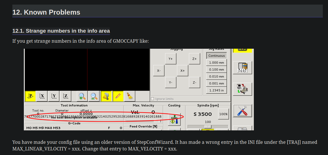

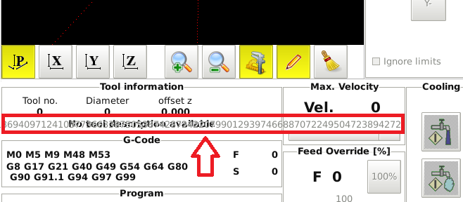

04 Jun 2025 04:50 - 04 Jun 2025 05:35 #329653
by dinkata
long string of numbers was created by dinkata

04 Jun 2025 05:00 #329655
Replied by Aciera on topic long series of numbers
please give a clearer description of the issue. A screenshot would also be helpful.

04 Jun 2025 05:04 - 04 Jun 2025 05:10 #329656
by dinkata
Replied by dinkata on topic long series of numbers
There is a screenshot, but it won't attach.

04 Jun 2025 05:29 #329659
Maybe describe the steps to reproduce the issue.

04 Jun 2025 05:37 #329660
by dinkata
I edited post 1, I was able to attach a photo

04 Jun 2025 05:41 #329661
The following user(s) said Thank You: dinkata

04 Jun 2025 05:54 #329663
by dinkata
exactly that, thank you

03 Jul 2025 06:48 #331146
by HansU
Replied by HansU on topic long series of numbers
Did that solve it for you?

03 Jul 2025 14:15 #331159
by dinkata
Yes
