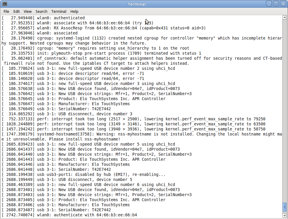

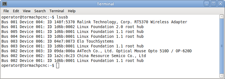

I use a monitor 15" HP Compaq L5009tm with PathPilot 2.0
I installed a driver Linux 64 bit APR Driver (AMD64/Intel - x86_64) from
www.elotouch.com/support/dow...eQckECOQACuyoW
by instruction
/etc/opt/elo-apr
sudo cp /etc/opt/elo-apr/setup/99-elotouch-ubuntu.rules /etc/udev/rules.d/
Touchscreen works, but periodically refuses .
In PathPilot MDI "ADMIN TOUCHSCREEN"
.. could not find any touchscreen device
How do I ensure normal operation on touchscreen HP Compaq L5009tm ?
...lsusb ....
.....dmesg....
