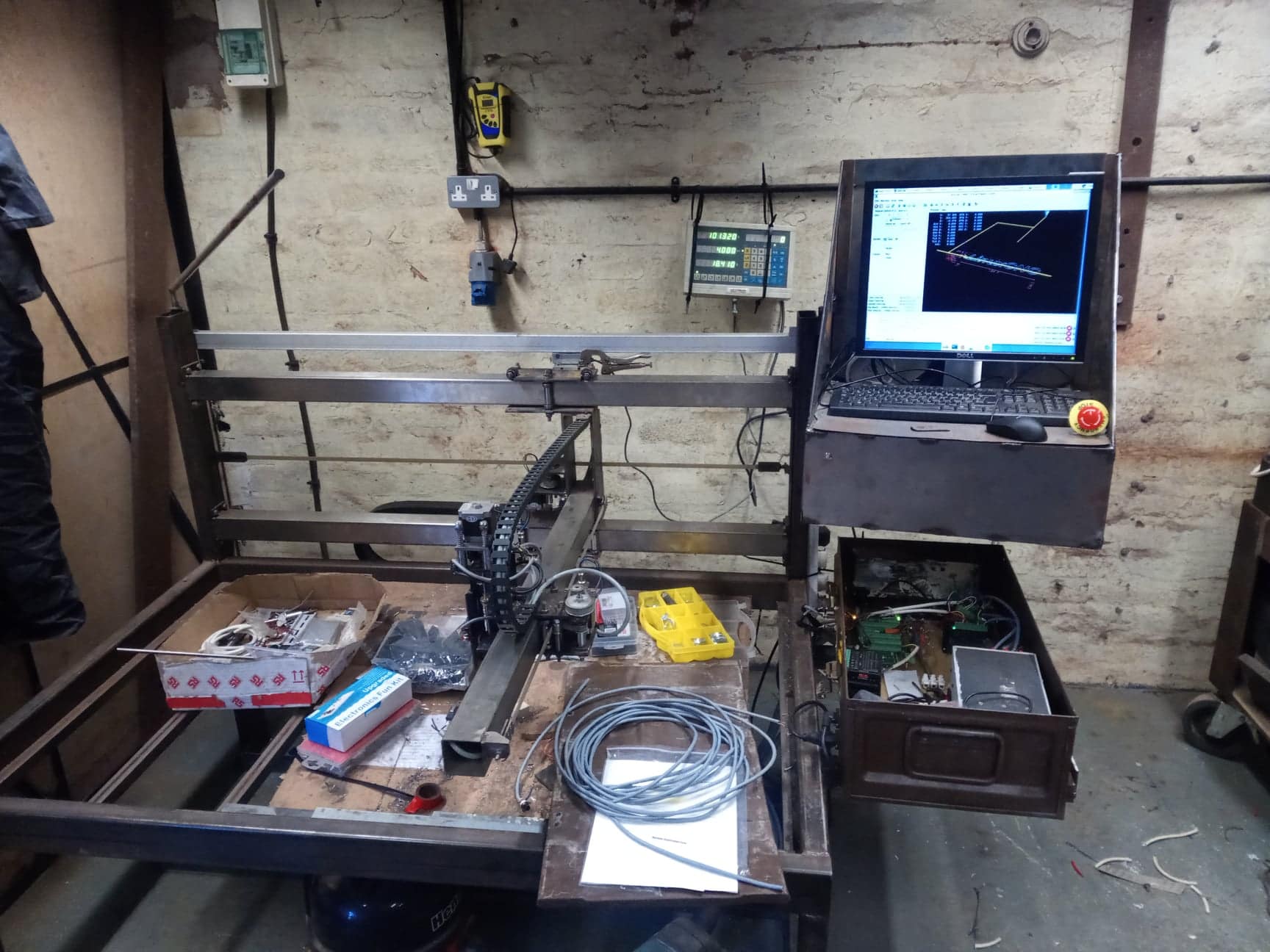

Hi fabricator, that was a quick response!
I have done this for the X axis using the DRO shown in the picture. I get 61.227 steps/mm.
I should have added to my initial post that both X and Y axis have the same timing belt setup and gearing, so theoretically should move the same distance per step.
My Y axis is moving half the distance that the X axis is, so if I put 122.454 steps/mm in it moves the correct distance and have verified that with a steel rule.
I was just wondering if there was something else going on which needs to be put right as I don't understand where the discrepancy comes from
Sam

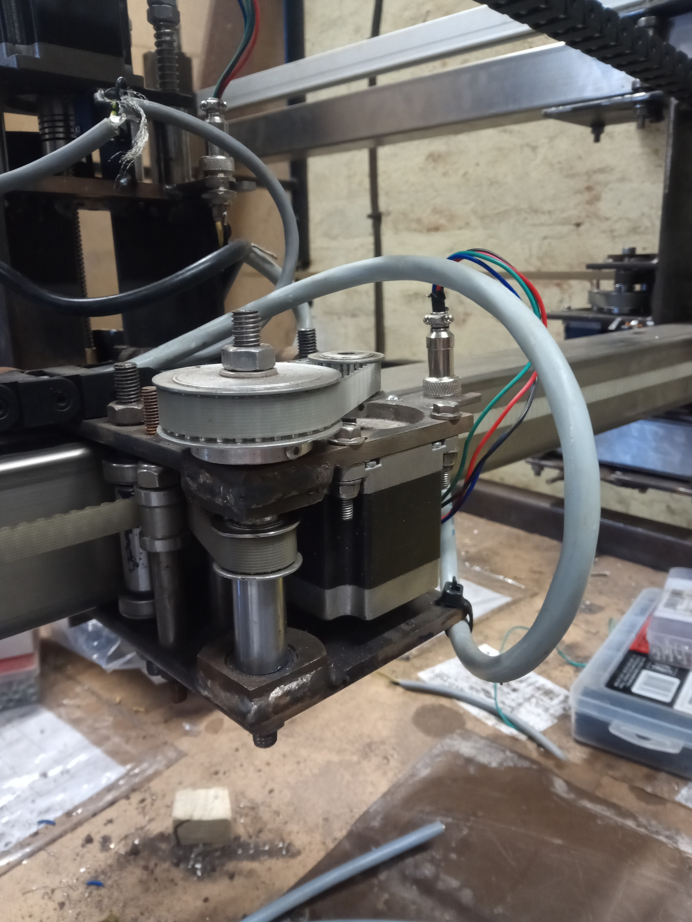

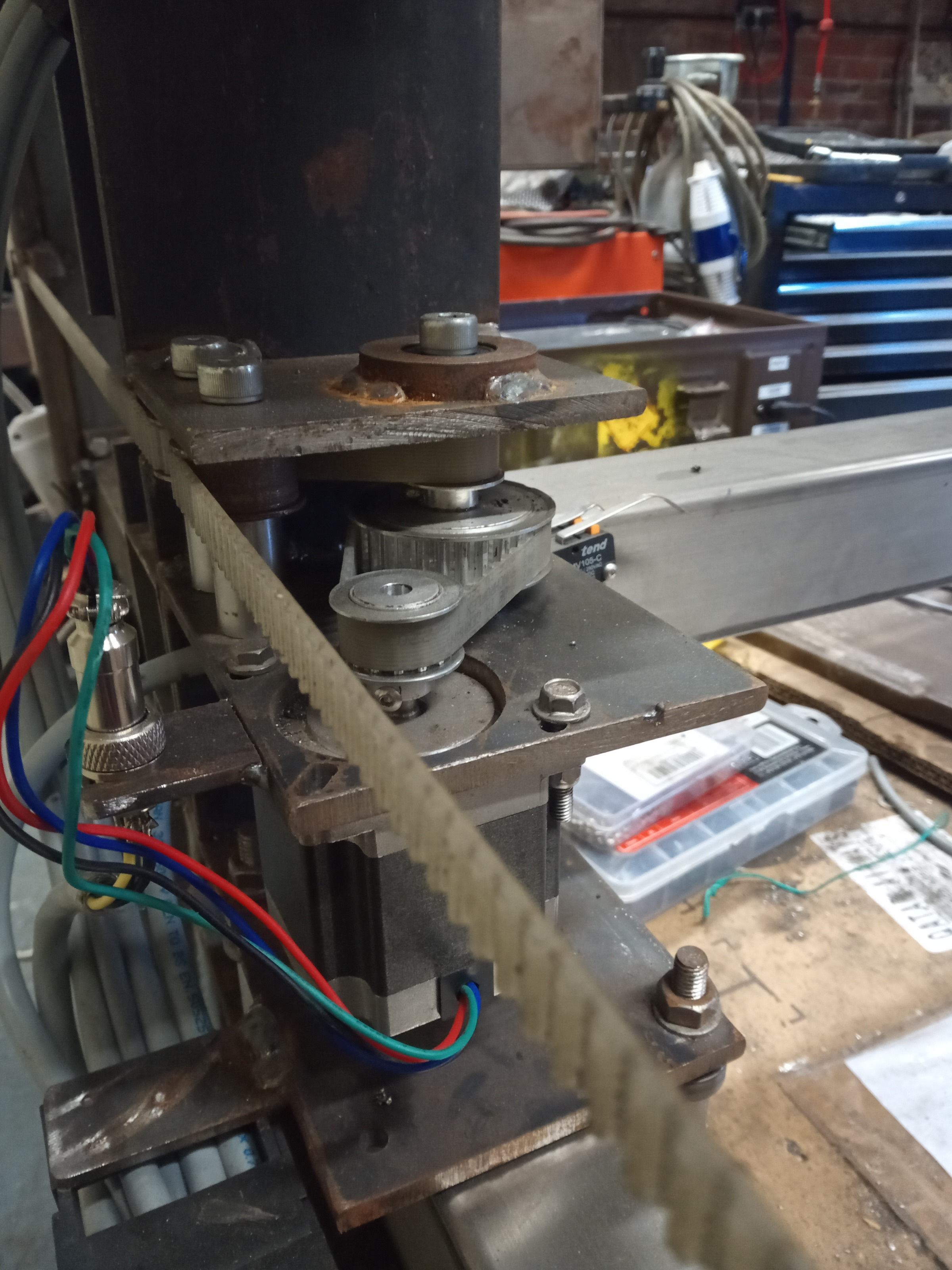

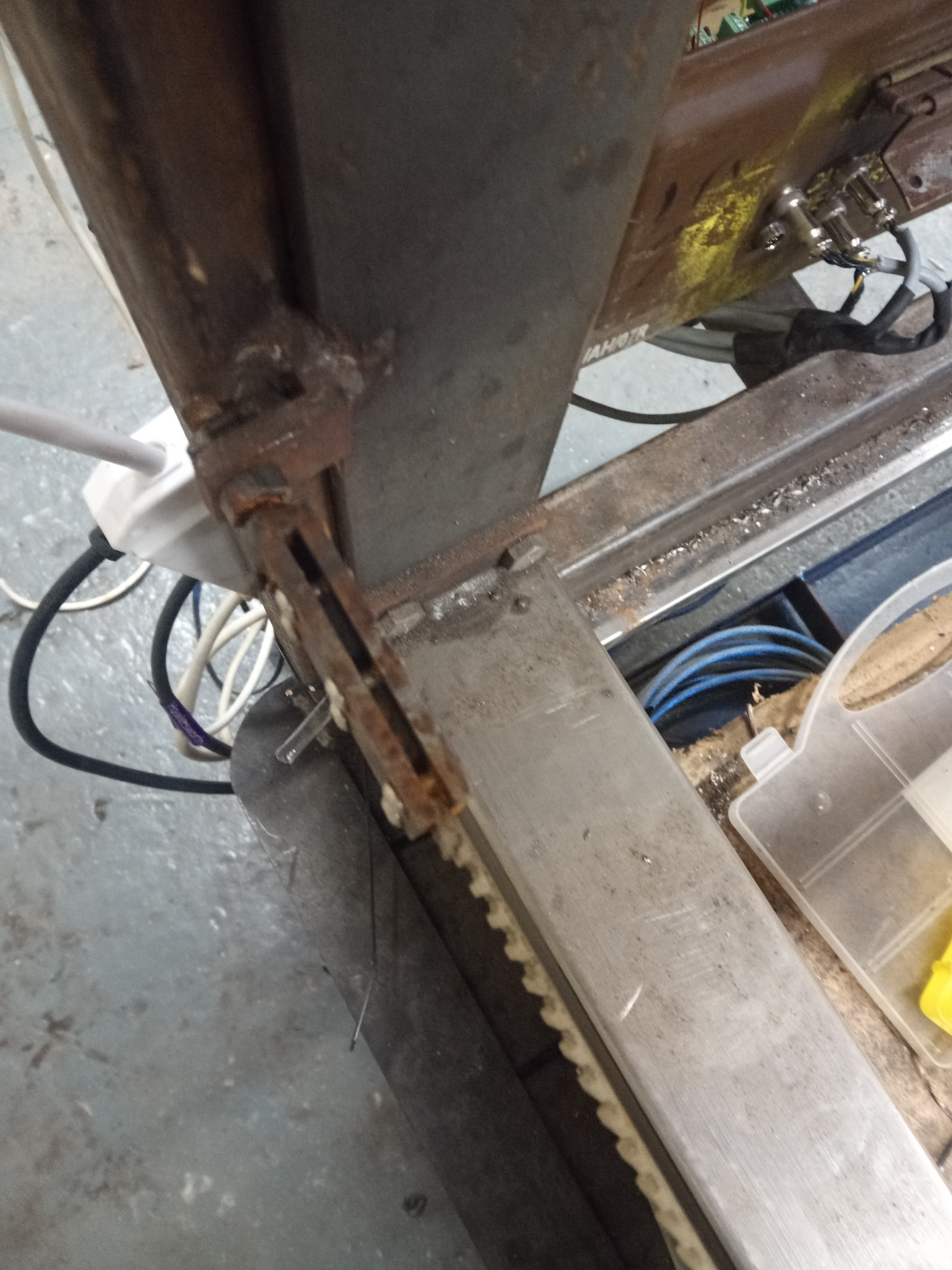

For all intents and purposes they are the same. The drums which create the wrap around the drive pulley are different sizes but this shouldn't affect distance moved.
Your bewilderment makes me think it's probably not software related. The labels on the stepper motors are the same and I bought them as a kit from eBay, but perhaps one has been labelled incorrectly and one is only 200deg/rev and the others are 400deg/rev (as they should be).
Attached some pics for interest anyway! It's a bit rough and ready but doing this at home for fun!
