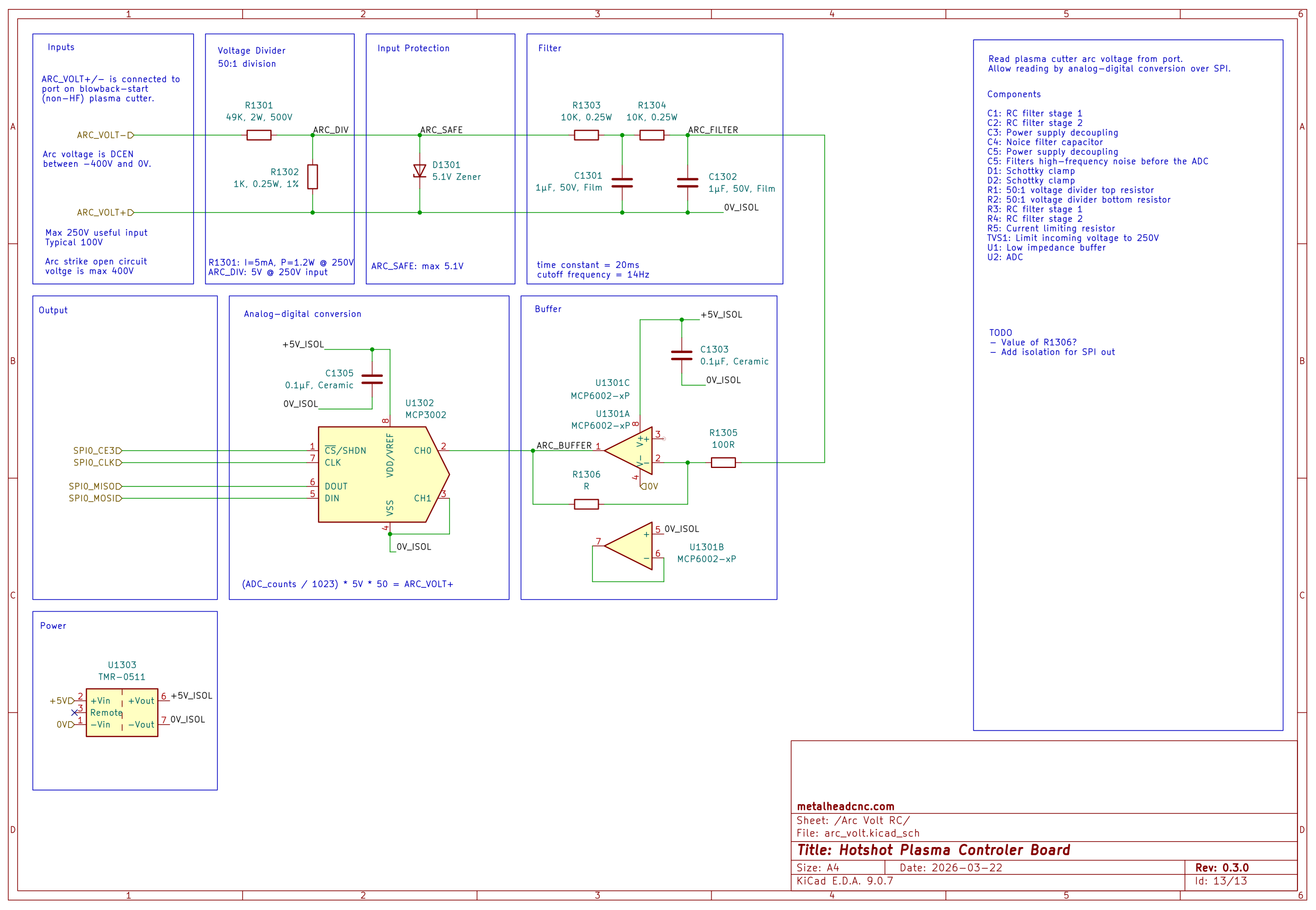

Hi all. I've been playing with a design for a board that will allow me to read arc voltage with a Raspberry Pi. I think I've got something that will plausibly work. I'd appreciate a review of the attached schematic because circuit design is not my core competency.
Here's a quick tour:
1. Inputs are expected to be connected to the arc volt port of a blowback-start plasma power supply.
2. Input voltage is limited to 250V by a TVS diode
3. Voltage is divided 50:1
4. RCRC filter limits frequency to 14Hz
5. Raspberry Pi reads divided voltage via ADC
Thanks!

It says 400V Open Circuit Voltage, but you have a 250V TVS.
Maybe the TVS can go after the voltage divider? Or have a 500V one and a second lower voltage one after the divider. I think that with the TVS after the divider the divider would limit the current through it, which might work better.
You should probably put an optical isolator on the SPI lines from the ADC, just in case things do go wrong on your HV board.

Arc voltage is DCEN, that is, between -400V and 0V.
The torch is negative, ground is positive.
Not saying that the below is correct. It has worked for me for many hours though.

My intention with the TVS was to limit input voltage to 250V. The ADC expects 0-5V range, and voltage division is 50:1, so anything above 250V is out of range.
In reality 250V is way high for a cutting voltage. I just came up with it by working backwards from the ADC voltage range.
Does that make sense?
OK, but you must also add resistors in front of it, or it will blow up the first instance the voltage goes above 250V.
Personally, i have a strict policy of doing the voltage divider using 3 resistors, always, saves a lot of headache in case of mishaps or wires shorts or any of plasma wires touching ground or machine.
Example, in case of Hakan's schematics, i would use a 2K7 in the middle of two 50K. The other side of both 50K would go to plasma arc voltage, and the measuring would be done on the 2K7.

Replied by alangibson on topic Review Request for Arc Volt Sensor Schematic
I moved the voltage divider to the first stage and put a zener after it for overvoltage protection like Hakan.
@tommylight: Do you have a schematic you can share that shows how you use 3 resistors for voltage division. I'm having trouble visualizing your description.
Here's where I'm at right now. I need to add SPI isolation. That's going to be the biggest stage of all because there aren't any good through-hole all in one solutions like there are for SMD.
