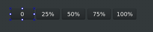

Hello,
I am working on a Linux Mint 19.1 Gtk interface. I like the default Mint Dark styling better than Mate (Gnome) interface. That said, I decided to walk down the path of creating some functionality that is more mainstream in comparison to Fanuc, Mitsubishi, Siemens, and Heidenhain in regard to how a user would recognize how to use the UI based on experience with these controls.
Although RS274 GCODE is the standard, Linuxcnc tends to lean more toward a standalone paradigm making it a challenge for even the most experienced to just walk right in. That said, as I begin my journey I will share with all in hopes that I may help you on your journey or inspire you to help in mine. Either way, happy VCP'ing.
This is my latest creation. The code is crude as I am just learning the deeper parts of Python. I know Lua, some C, but for the most part have always used Ladder, Functional Programming, Sequence, etc. based on my 30+ years in the CNC machine tool engineering business. I own a small but reasonably successful CNC machine tool service, consulting, retrofitting, and integration company out of Texas.
I needed a method by which to create a series of buttons to select percentages of the max_velocity. aka... Rapid for those familiar. Borrowing from the fine example QtPyVCP numberKey tutorial I created a sloppy but fully function Rapid OVR setup with 0,25,50,75, and 100% values. It will draw from the INFO.maxVelocity() imported into the machineactions.py file. The file is located in /home/yourusername/.local/lib/python2.7/site-packages/qtpyvcp/actions folder. Make a copy and then edit. Lol. Go figure, I didn't.
Here is my crude but function actions I added to the Max Velocity section under def set():
EDITED:
You may be wondering why I chose to have a hundred() vs. using the reset() to set the maxVelocity back to 100%. The reason is that the button defaults to disabled if you do until the machine is ready. This was goofy as the rest did not and not really needed as max_velo does not need to be a protected UI point. Regardless for simplicity I named everything pretty clear for myself and anyone who may follow. I know it is not efficient but it does work.
No rules are required for the buttons. Everything for setting the max_velo is in the actions file. The UI part is in the mainwindow.py file in your vcp folder created by you when you created your VCP.
So, follow the instructions and add the GridLayout. Then right click the layout and morph to a Group Box. Then add action buttons for each %. I did 0~100% 25% increments. My preference. Then just as instructed select them all and make them a New Button Group (May not be required). Name the button group (Should be last object in the browser after statusbar) rapidButtons. I did this just in case there was a more efficient code base for what I want. I will improve it over time for sure. Make sure ALL are checkable.
EDITED:
Name each button like so,
rapidZero
rapidTwentyFive
rapidFifty
rapidSeventyFive
rapidHundred
Then for each you can add styling individually for checked like so, ActionButton::checked{background-color:rgb(0,255,0)} and ActionButton{background-color:rgb(0,128,0)}. This will act like an indicator light for each as they are toggled.
In order to get them to act like radio buttons where only one can be on at a time, I created the following (sloppy) code for the mainwindow.py located in your VCP folder: (yours should look the same)
EDITED:
This will toggle the selected button to on and indicating while turning any of the others off. Works great.

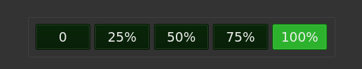

Save the file and VCP and then start Linuxcnc with your VCP config as normal. Thats it. Easy peasy.
Here is the button group in QT:
Here it is in Linuxcnc working:
If i missed something or you have issues please feel free to ask. I am currently working to fix the nasty QScintilla GcodeEditor. I have attached a screenshot of where I am at on styling that below:
Happy Hunting,
Don

# BEGIN MAX VEL OVERRIDE actions
# Added MV actions for 25,50, and 75 perecent values
class max_velocity:
"""Max Velocity Group"""
@staticmethod
def set(value):
"""Max Velocity Override Set Value"""
CMD.maxvel(float(value) / 60)
@staticmethod
def zero():
# Sets MAX_VELO to 0% of max from ini file settings
"""MAX_VELO_0%"""
c_val = (INFO.maxVelocity() / 60) # Get current MV static param from ini
set_val = 0
CMD.maxvel(float(set_val))
@staticmethod
def twentyfive():
# Sets MAX_VELO to 25% of max from ini file settings
"""MAX_VELO_25%"""
set_val = c_val * .25
@staticmethod
def fifty():
# Sets MAX_VELO to 50% of max from ini file settings
"""MAX_VELO_50%"""
set_val = c_val * .5
@staticmethod
def seventyfive():
# Sets MAX_VELO to 75% of max from ini file settings
"""MAX_VELO_75%"""
set_val = c_val * .75
@staticmethod
def hundred():
# Sets MAX_VELO to 100% of max from ini file settings
# Used because reset disbales the button when not ready. Preserve UI look and feel for the group.
"""MAX_VELO_100%"""
set_val = c_val * 1
@staticmethod
def reset():
"""Max Velocity Override Reset Value"""
CMD.maxvel(INFO.maxVelocity() / 60)
def _max_velocity_ok(value=100, widget=None):
if STAT.task_state == linuxcnc.STATE_ON:
ok = True
msg = ""
else:
ok = False
msg = "Machine must be ON to set max velocity"
_max_velocity_ok.msg = msg
if widget is not None:
widget.setEnabled(ok)
widget.setStatusTip(msg)
widget.setToolTip(msg)
return ok
def _max_velocity_bindOk(value=100, widget=None):
# This will work for any widget
STATUS.task_state.onValueChanged(lambda: _max_velocity_ok(widget=widget))
try:
# these will only work for QSlider or QSpinBox
widget.setMinimum(0)
widget.setMaximum(INFO.maxVelocity())
try:
widget.setSliderPosition(INFO.maxVelocity())
STATUS.max_velocity.onValueChanged(
lambda v: widget.setSliderPosition(v * 60))
except AttributeError:
widget.setValue(INFO.maxVelocity())
lambda v: widget.setValue(v * 60))
pass
except:
LOG.exception('Error in max_velocity bindOk')
max_velocity.set.ok = max_velocity.reset.ok = _max_velocity_ok
max_velocity.set.bindOk = max_velocity.reset.bindOk = _max_velocity_bindOk
# END MAX VEL OVERRIDE actions
# -------------------------------------------------------------------------You may be wondering why I chose to have a hundred() vs. using the reset() to set the maxVelocity back to 100%. The reason is that the button defaults to disabled if you do until the machine is ready. This was goofy as the rest did not and not really needed as max_velo does not need to be a protected UI point. Regardless for simplicity I named everything pretty clear for myself and anyone who may follow. I know it is not efficient but it does work.
EDITED:
rapidZero

what did you name the buttons?
rapidZero ect?
they check correctly but are not affecting the rapid
and could the existing rapid slider affect the buttons?
rapidZero ect?

Yes.
rapidZero

mainwindow.py in the connects shows you. Just under super...
rapidZero
rapidTwentyFive
rapidFifty
rapidSeventyFive
rapidHundred

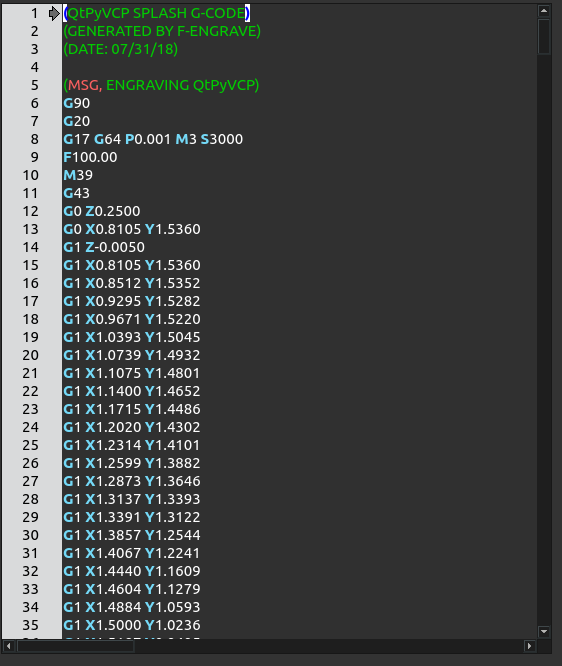

I am still researching QScintilla. Man is that a complicated code base. Lexers and regex are the things of nightmares. My goal is to 1. have G's one color, M's one color, and O's another.
Not sure if it is Linux Mint 19.1 but for some reason I cannot get the current line to highlight during runs. In axis QScintilla picks up the lexer and highlights the running(current) line during runtime.
I will figure it out and do a solid step by step for that too. Seems there is very little info on how. But I am ruthless bastard.

Here is a cutout: Note the function defs are the same but prepend button to the button name. Tried to keep it simple. KISS!
self.rapidZero.clicked.connect(self.buttonRapidZero)
self.rapidTwentyFive.clicked.connect(self.buttonRapidTwentyFive)
self.rapidFifty.clicked.connect(self.buttonRapidFifty)
self.rapidSeventyFive.clicked.connect(self.buttonRapidSeventyFive)
self.rapidHundred.clicked.connect(self.buttonRapidHundred)
