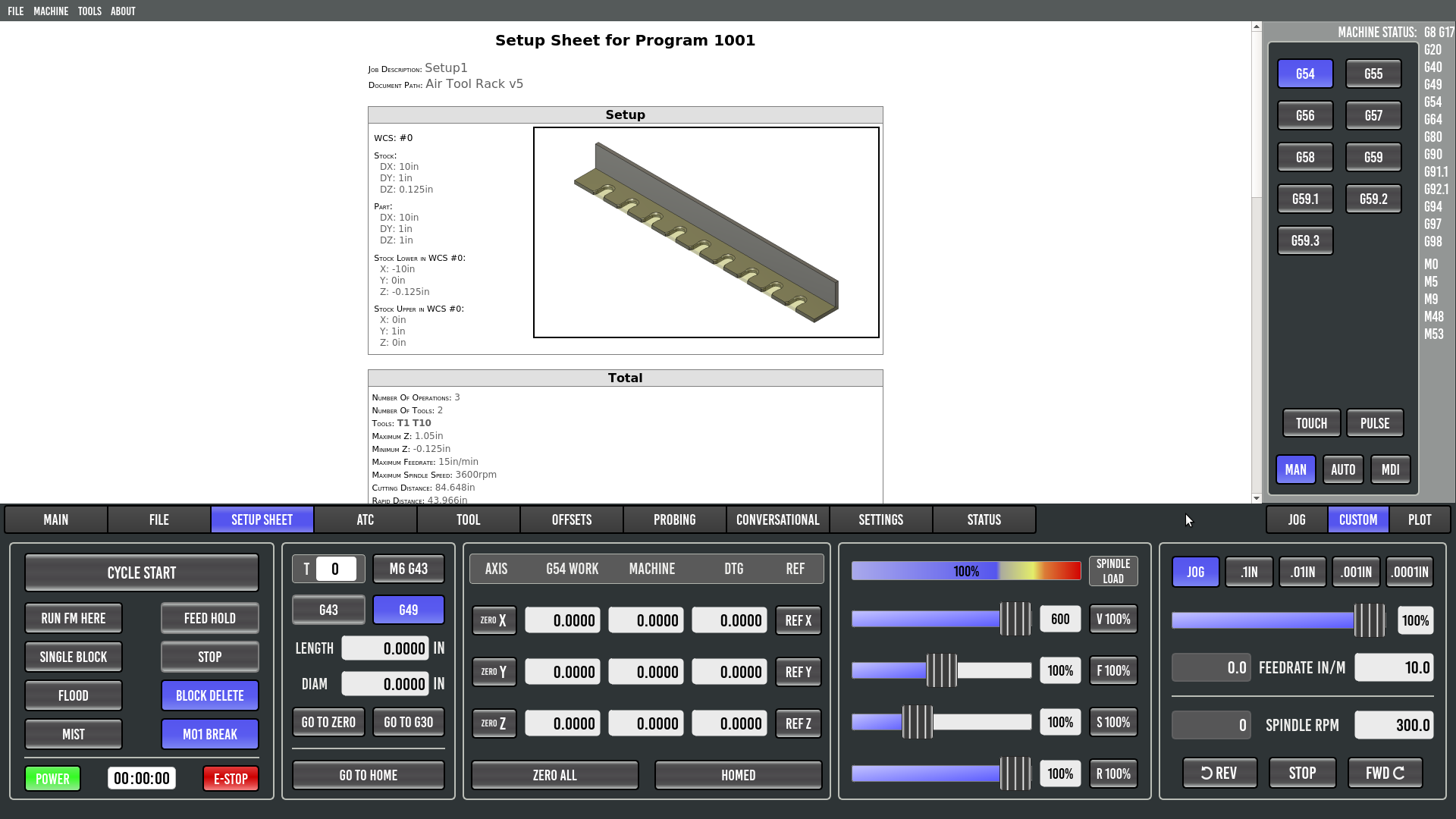

Hello,
I use fusion for cad and cam and thought it would be useful to be able to show the setup sheets in probe basic. So I added a setup tab with a Webview widget.
I always rename the setup sheets like the nc-files (and hope fusion will do this automatically one day). now I only need to find a way to load the sheet together with the nc file.
For this I would need to read path and name, change the ending and parse this to the webview widget.
Or simply add a filechooser to the setup tab
Can anyone help me to make the changes?
I have never worked with python or qt.
Thanks Patrick

Here is a quick and dirty example of how to add the setup sheet tab to ProbeBasic, without having to modify any if the PB source files.
  1. Place the attached custom_probebasic.py file in your config directory.
  2. Add a custom_config.yml file to the config directory with the following content:
    # use custom probe basic main window class
    windows:
      mainwindow:
        provider: custom_probebasic:CustomProbeBasic
  3. Specify the YAML file in the INI:
    [DISPLAY]
    DISPLAY = probe_basic
    CONFIG_FILE = custom_config.yml
Run LinuxCNC as usual. A new tab will be inserted in the main tab widget containing a QWebView for displaying the setup sheet. Each time a GCODE file is loaded it will look for an HTML file with the same name as the gcode file and display it in the webview.
Cheers,
Kurt

18 Aug 2024 11:39 #308059 by anfänger
Replied by anfänger on topic Display setup sheet
Short question, I updated all my machines now to 2.9.3 and moved my modifications to the user tabs.
I thought also adding the setup sheet to my lathe using probe_basic_lathe.
With the mill it is still working on the lathe i get following error:
File "/usr/bin/probe_basic_lathe", line 8, in <module>
sys.exit(main())
File "/usr/lib/python3/dist-packages/probe_basic_lathe/__init__.py", line 19, in main
qtpyvcp.run_vcp(opts, VCP_CONFIG_FILE)
File "/usr/lib/python3/dist-packages/qtpyvcp/__init__.py", line 26, in run_vcp
run(*args, **kwargs)
File "/usr/lib/python3/dist-packages/qtpyvcp/app/__init__.py", line 129, in run
launch_application(opts, config)
File "/usr/lib/python3/dist-packages/qtpyvcp/app/launcher.py", line 78, in launch_application
loadWindows(config['windows'])
File "/usr/lib/python3/dist-packages/qtpyvcp/app/launcher.py", line 228, in loadWindows
window = _initialize_object_from_dict(window_dict)
File "/usr/lib/python3/dist-packages/qtpyvcp/app/launcher.py", line 208, in _initialize_object_from_dict
return obj(*args, **kwargs)
File "/home/ditte/linuxcnc/configs/ditte/custom_probebasic.py", line 15, in __init__
super(CustomProbeBasic, self).__init__(*args, **kwargs)
File "/usr/lib/python3/dist-packages/probe_basic/probe_basic.py", line 47, in __init__
self.vtk.setViewMachine() # set view to machine at startup
AttributeError: 'CustomProbeBasic' object has no attribute 'vtk'

I solve the issue by making a custom tab and adapting the code snippets KCJ wrote four jears ago.
