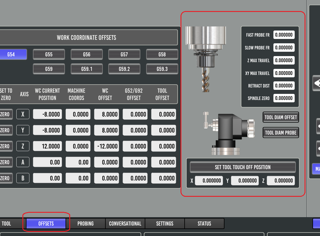

I would like to call tool_touch_off.ngc subroutine from my remapped M6 subroutine, but I am missing parameters:
#<fast_probe_fr> = #1 (set from probe screen fast probe feed rate)
#<slow_probe_fr> = #2 (set from probe screen slow probe feedrate)
#<z_max_travel> = #3 (max z distance the tool travels before erroring out if not contact is made)
#<xy_max_travel> = #4 (max xy distance the tool travels before erroring out if not contact is made)
#<retract_distance> = #6 (distance the tool retracts after making contact during fast feed mode)
#<spindle_zero_height> = #5 (G53 distance from home to spindle nose triggering point on touch plate)
#<tool_diameter_probe_mode> = #8 (activates the tool diameter probe subroutine section)
#<tool_diameter_offset_mode> = #9 (activates the tool diameter offset position for probe subroutine section)
#<tool_diameter> = #10 (current tool's diameter used for offseting probe position in x axis)
Where those parameters are stored? Is there any chance I could access them from subroutine and and use them when I call tool_touch_off.ngc?

those parameters are set from the offsets page in probe basic.Hi,

Yes, I know, but if you want to use tool_touch_off.ngc outside it didnt work.
o<tool_touch_off> call [#<fast_probe_fr>] [#<slow_probe_fr>] [#<z_max_travel>] [#<xy_max_travel>] [#<spindle_zero_height>] [#<retract_distance>] [#<go_back_to_start_pos>] [#<tool_diameter_probe_mode>] [#<tool_diameter_offset_mode>] [#<tool_diameter>]
runs the tool_touch_off subroutine, and this one will have parameters.
with #1 #2 #4 etc. you will get the error that Parameter missing
with value like I did it works
How can I use the parameters from Offset page? will have more handling instead of using 2 times parameters

That is correct and tool_touch_off.ngc works fine as far as it is called from UI and I guess when it is called from UI parameters are included, but in case if I call tool_touch_off.ngc from subroutine parameters are missing that is the main problem that I have.
Any ideas how I could get parameters from UI that you listed in picture?
Replied by gunrak on topic Calling tool_touch_off.ngc subroutine from another subroutine - Probe Basic
[/quote]those parameters are set from the offsets page in probe basic.

If you look at the tool_touch_off subroutine, the tool touch-off position values appear to be stored as persistent variables in the .var file.
Specifically #5181, #5182, & #5183 (X/Y/Z).
I don't have a linux machine in front of me right now, so I can't open the UI and see exactly how the 'set tool touch off position' button works, but I suspect it just writes the values of the three fields to the appropriate variable numbers without any super-complicated backstage stuff. It also (probably) reads those values at UI launch.
I'm not sure what the value is of using the INI file to store the location vs. just using the .vars file... but far be it from me to challenge someone wanting a 'peculiar' feature or change; I'm guilty of fiddling with all sorts of stuff like this.
If you want to store & retrieve the values from your INI file, I think you could do it like this:
Edit INI file:
Edit tool_touch_off.ngc:
I think that should work, but please be careful to test at really low speeds. Note that this 'hack' has nothing to do with the on-screen tool touch-off locations which are managed through the GUI. You can still enter the location on-screen, but you've essentially hijacked the tool setter subroutine so it ignores the on-screen values (which are still stored are variables).
Further, if you update Probe Basic your 'hack' is likely to get overwritten and will need to be re-done. The subroutine will need to be edited again, and if you've made any changes to the UI those will also need to be re-added to the updated version.
Possibly you could create a new 'touch off location' display field and stick it in a new user tab - those shouldn't get over-written if you update PB.
