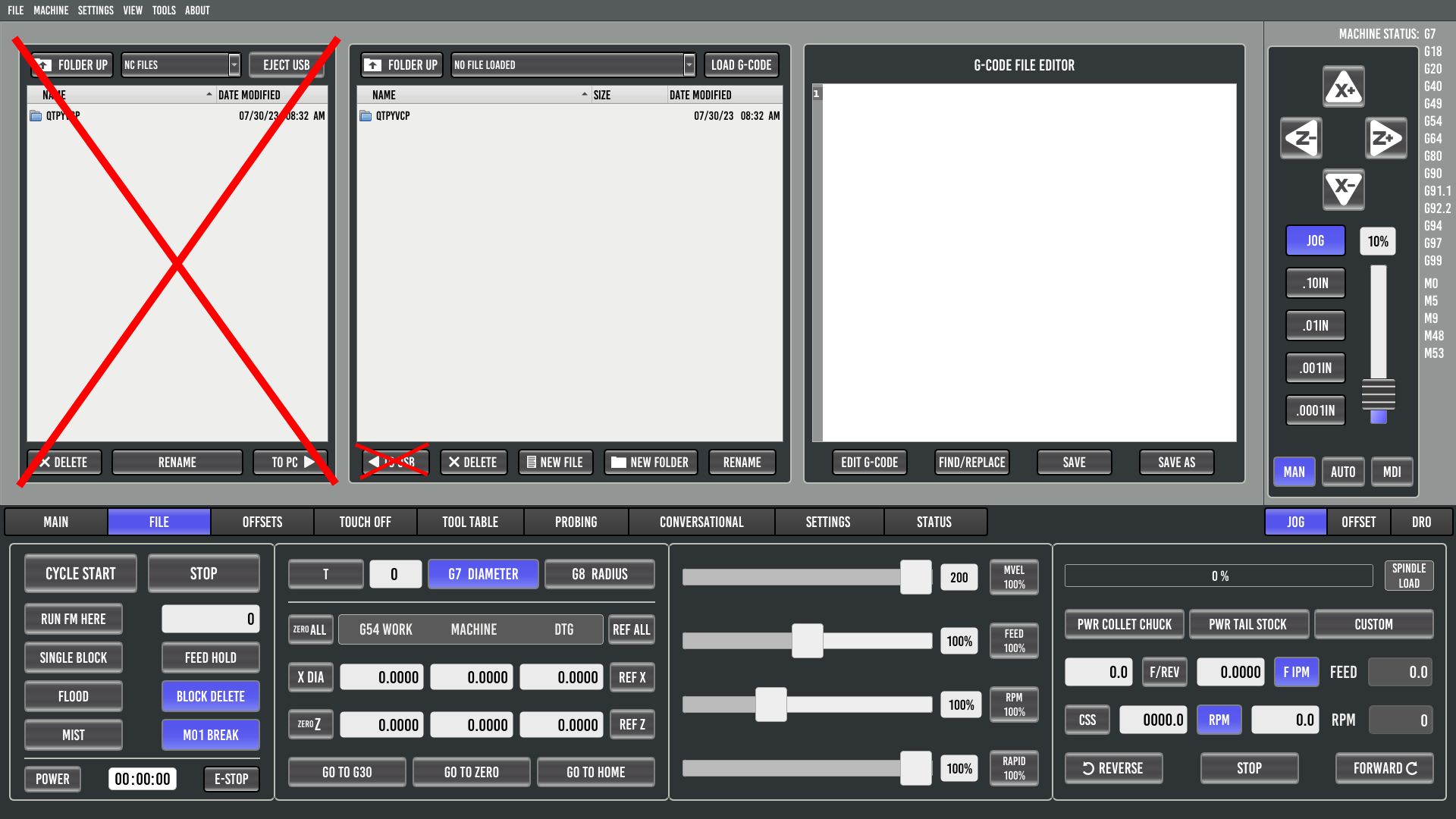

I recently came across this video on YouTube where author has modified the ProbeBasic UI to hide one of the two file managers.
Gave this some thought and I realize that their are two distinct use cases for the File tab in ProbeBasic.
The use case which ProbeBasic currently seems to be designed for is the use of USB-drives and similar physical media to copy the files to and from the CNC machine in question. In this case two file managers is great as it simplifies the copying/moving of files.
The second use case is when a network share is used to load the files from. In this case the second file manager is of no use as no files are copied or moved. In this case having one larger file manager instead is very helpful as it allows for more information to be displayed.
There is no right or wrong here as both use cases are valid and fairly common. But maybe a configuration setting could added to toggle the display of one or two file managers?
If the the setting is set to display only one file manager the elements crossed out on the screenshot above are hidden and the remaining file manager is enlarged to fill the whole screen.

I have considered this before, but i cannot find a good reason to do so as there is plenty of room for the file display and the additional space could not be utilized for something else since it would still be a placeholder for the second file window.
I utilize syncthing which auto updates my programs to the defined shared directly on posting from fusion360 and rarely use the usb window so i can see your point of argument. but there have been times where my internet has been out that i was glad to have the usb transfer ease, especially when proofing out a new part run that requires some tweaks to get dialed in for production.
That said lets see what others think, if im in the minority I will add it to the list of things to do.

Thanks for such a quick reply Lcvette.
My idea was to enlarge the remaining file editor when USB file manager is hidden or removed.
It would help greatly with long file and folder names in the g-code file library which grows with each day.
I made a crude screenshot of how I thought it might look.
However I realize the this approach would require some logic based layout changes depending on the value of the setting.

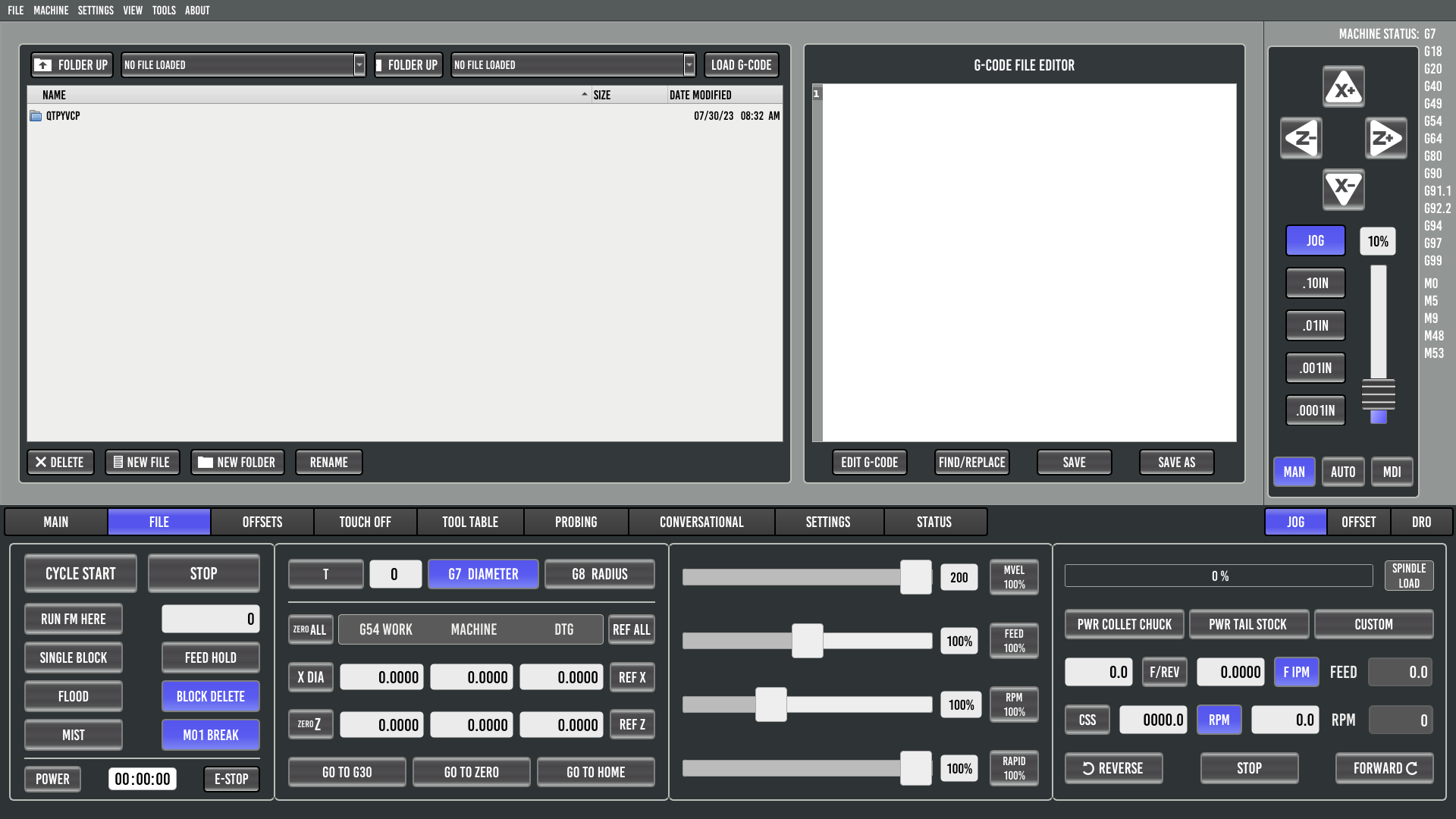

I would also like it, if the there were just 2 larger windows for the code and the files instead of 3.
I never use the left window becouse i did like @rodw said and use a shared network-folder as workfolder.
So i can export my file directly from fusion and have it in my Probe Basic. (with one litle problem, i have to go into a folder and back, after this the new file is there - sadly there is no F5 or Fileupdate-funktion or i don`t know..
Further more, for me it would be much better, becouse me Filenames are very long, becouse i write some important infos, sortnumbers and Version into the filename. This leeds to that i can`t read the full filename at the Fileexplorer.
Best regards
Jens

I think this topic revolves around “comfortability” and is not something that is urgent right now. For this reason, I don't think anything needs to be moved here.

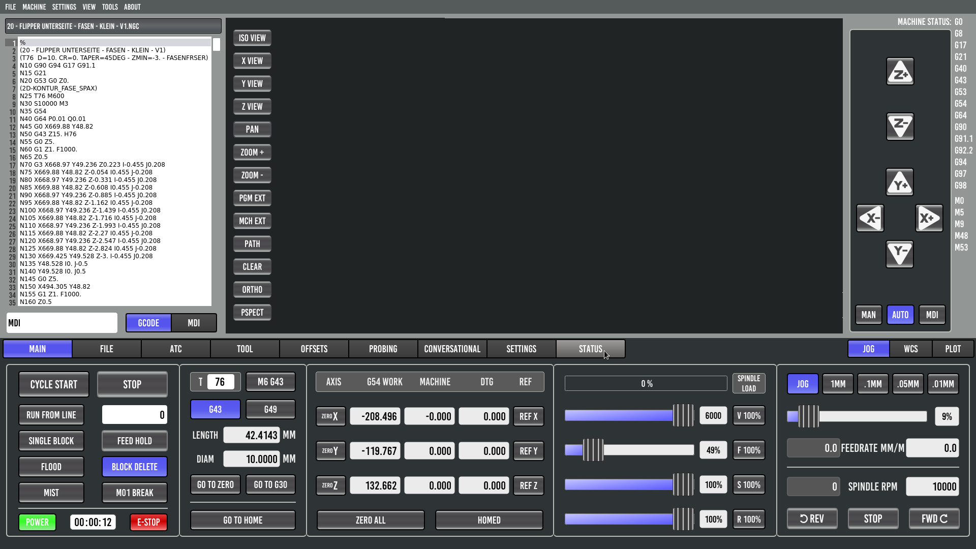

But while we're on the subject of the window layout. Is there a possibility, via the Custom_config.yml or custom_probebasic.py, to make the code window a little narrower and the preview window wider, e.g. in the main mask?
Something like this:
