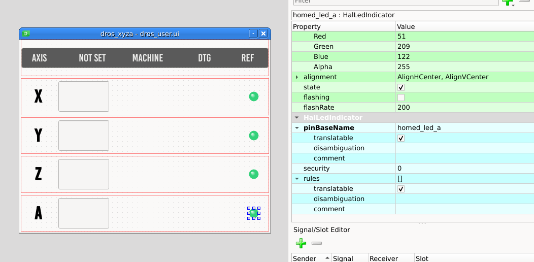

Now that I've got the user tabs, ATB buttons, and user DRO showing up, the next snag is creating hal pins.
I added some hal LED indicators to my custom DRO panel, but they aren't being created when LCNC/PB is started. At least they don't appear in halshow.
Dragged & dropped a HalLedIndicator in the panel
edited the object name
edited the pinBaseName
Just trying to get an on-screen indicator of an "is-homed" status.

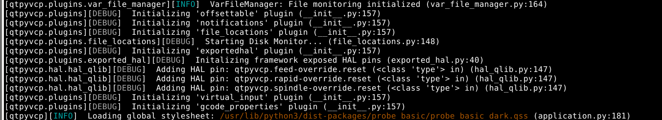

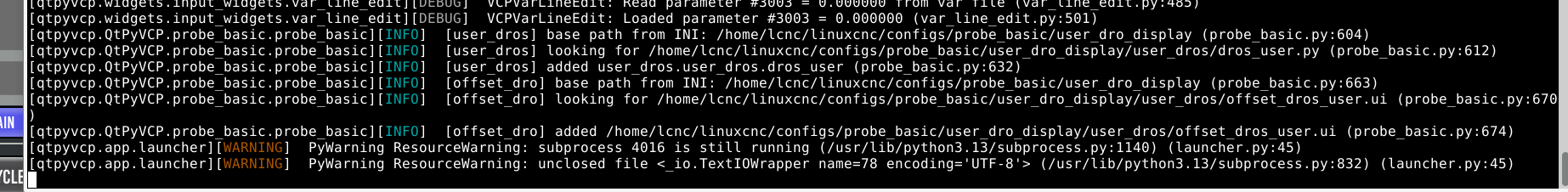

Reviewing the terminal output during PB startup, it looks like 'exported hal' is working, or at least not throwing a warning:
Not sure what this warning is:

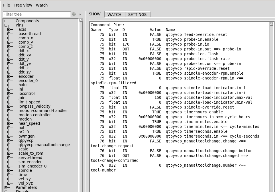

Attached the full terminal output during startup, halshow showing no pin being created, as well as a screenshot of the hal led indicator I'm trying to connect.

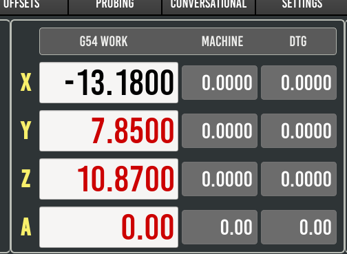

Still can't get halpins to show up, but I used the widget rules to cook up a workaround...
DRO is now sorted. Red = unhomed, black = homed
Personal preference is not to have anything that can zero out my DRO with one click. And since I've got a physical 'home-all' button and no need for a 'go-to-zero' function, those could leave the chat, too.
I can keep going for now, but I'd still like to figure out the missing hal pins if anyone's got an idea.

I did not add the pins to post-gui.hal. I was under the impression that qtpyvcp created the halpins outside of the user-config HAL process.
I see pins like qtpyvcp.probe-in and qtpyvcp.timerhours.in in the demo post-gui hal file but there is no loadrt or addf statements present.
I hadn't bothered trying to connect the new qtpyvcp pins until I could see them in halshow. All the 'standard' probe basic or qtpyvcp pins are present in halshow... just not the new ones I'm trying to create.
