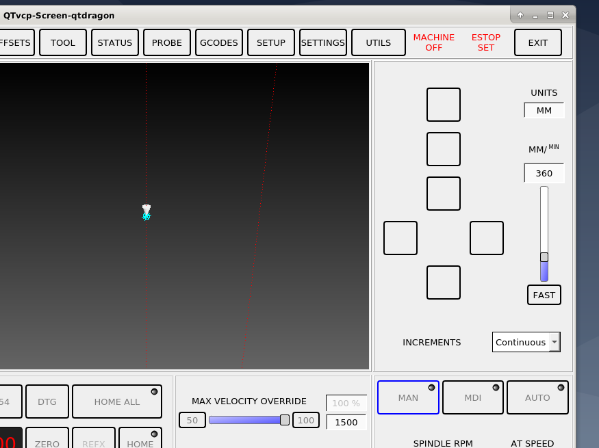

Hello, I've been working on a machine using the qtdragon interface. Nicely done I must say to all those involved but I'm not sure why the jog button graphics appear blank or how to change.
Debian 10
Linuxcnc 2.9
thanks
Debian 10
Linuxcnc 2.9
thanks

13 Mar 2021 15:31 #202144
Replied by cmorley on topic qtDragon Jog buttons
Is this an installed or compiled version ?

13 Mar 2021 15:39 #202145
Also are you using custom modified files or just the standard one.

13 Mar 2021 15:50 #202146
by mb_cnc
Replied by mb_cnc on topic qtDragon Jog buttons
The config was created with the Pncconf Wizard. No file mods other than the ini and hal files.

13 Mar 2021 16:13 #202151
by mb_cnc
I just created a basic qtdragon sim config using the Pncconf wizard with no post file mods and the result is the same.

- Posts: 7368
- Thank you received: 2181
13 Mar 2021 16:15 #202152
I'm asking how you got _Linuxcnc_ not the configuration.
Buildbot? ISO ? compiled from source?

13 Mar 2021 16:20 #202155
by mb_cnc
used synaptic package manager. set the repository to buildbot.linuxcnc.org/ - buster - master-rtpreempt

13 Mar 2021 16:25 #202156
ok thank you.
That's an installed version.
Installed versions put the file in different places and adds some restrictions to those files.
I use a compiled version for development so some times miss those problems.
I have noticed an error message in some posted debug messages that indicate there is a problem with installed version creating a needed file.
I'll be working on this in about a week or so.
Thank you for the report.

01 Apr 2021 11:01 - 01 Apr 2021 11:02 #204400
by robertspark
Replied by robertspark on topic qtDragon Jog buttons
+1 on this
buildbot master originally installed from iso
the background graphic and button images are all missing
played around with F12 and selected other themes but no dice, expect it's looking for files in the wrong places
(I have QtPlasmaC running fine so presume it's not QT dependencies)
