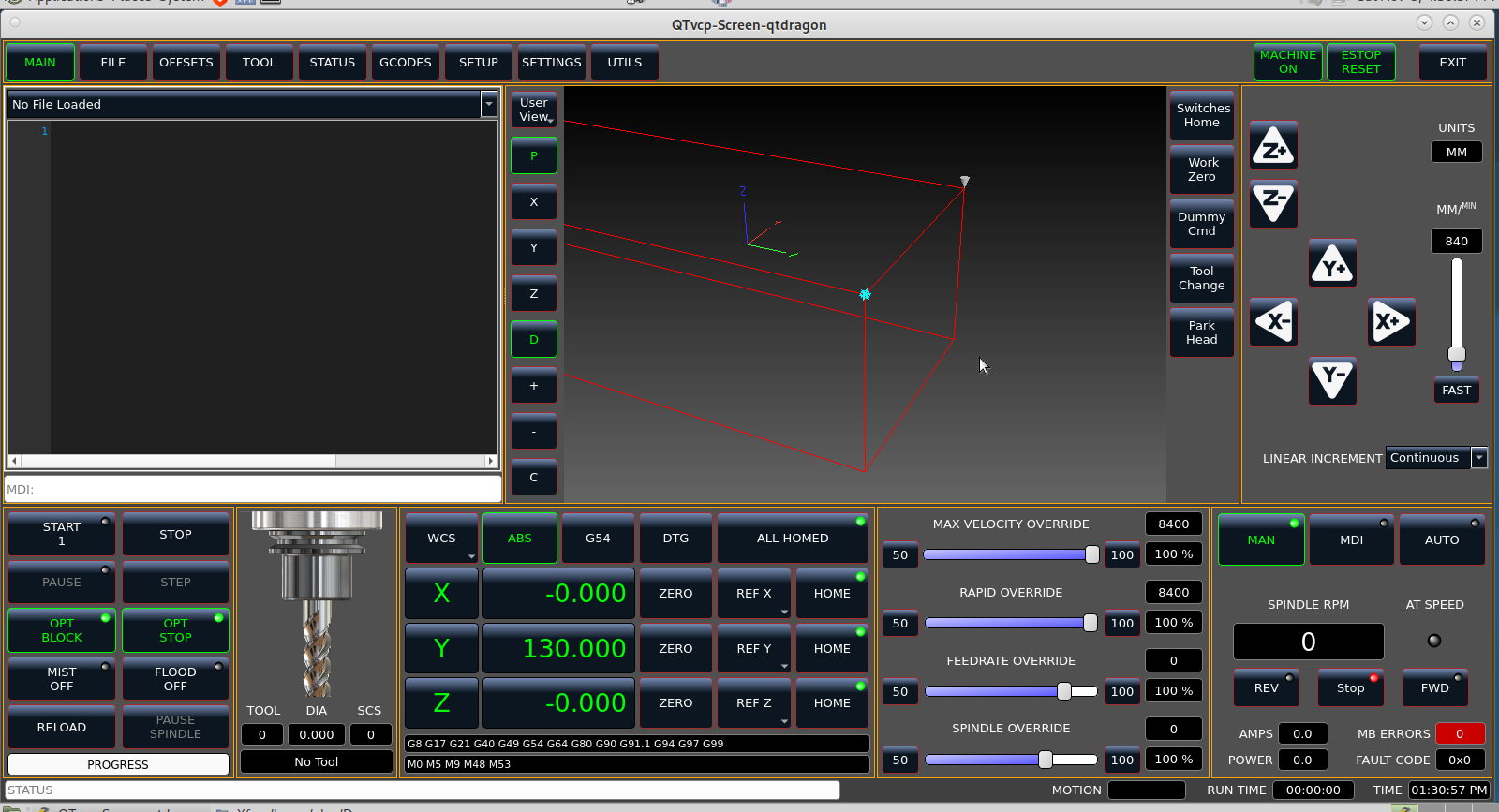

Hi all
I have a dragon rise USB board (pendant) attached to one of my machines. When I first home the machine all of the buttons work as expected (IE I can jog the machine around)
After I press one of the macro buttons on the screen ( Switched Home or Work Zero) the USB pendant stops working.
I'm guessing that the macros are not exiting properly but I can find no errors.
I am running debian 3.10 with LinuxCNC 2.9.4
I'm hoping someone can give me some pointers on this.

After the macro runs, I believe the machine is in MDI mode.
I bet HALUI needs the machine in manual to allow jogging.

Yes I have checked & that is the case. I should have realised.
Thanks.
PS is there a way that when the macro ends it tells LinuxCNC to go back into man mode?
...... Actually now I think about it is it possible to have a usb button that sets it back to man mode.

There is a halui pin halui.mode.manual that can do this and halui.mode.teleop will enable jogging. I have used these with pendants.

Just to finish this off, I added this line to my USB buttons hal file & everything seems to work as expected.
# Go into Manual mode
net man_mode <= halui.mode.manual <= input.0.btn-base2
