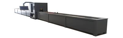

CNC plasma tube cutter was created by tommylight
Another one is done and delivered, this time a rotary tube cutter.
This one uses Linuxcnc as usual, the THC config although it does not have a THC, but i needed the probing function as it eliminates the need for guessing the torch cut height.
ARCOK signal is derived from an induction sensor i made ( also used in some other retrofits for reliable ARCOK signal ) to ensure reliable ARCOK signal always. When using THC that derive the ARCOK signal from the voltage on the plasma, they tend to issue a signal even when the actual cutting has not occurred due to having an actual voltage at the inputs as the plasma side is on giving anything from 180 to 250 VDC.
X axis ( rotational ) uses a double stack NEMA 23 motor, while the Y and Z axis use NEMA 17, all driven by Lam Technologies stepper drives.
It can cut up to 300mm in diameter and 2 meters in length.

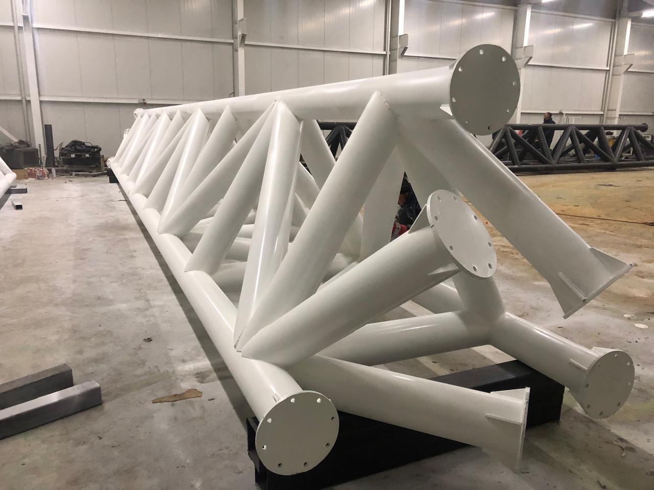

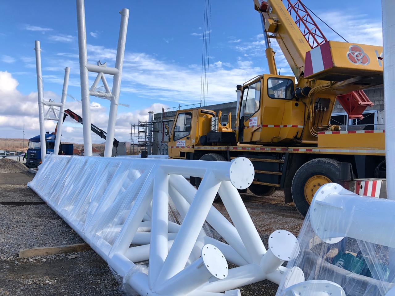

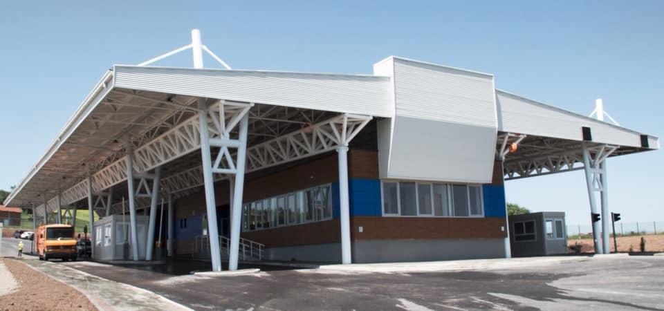

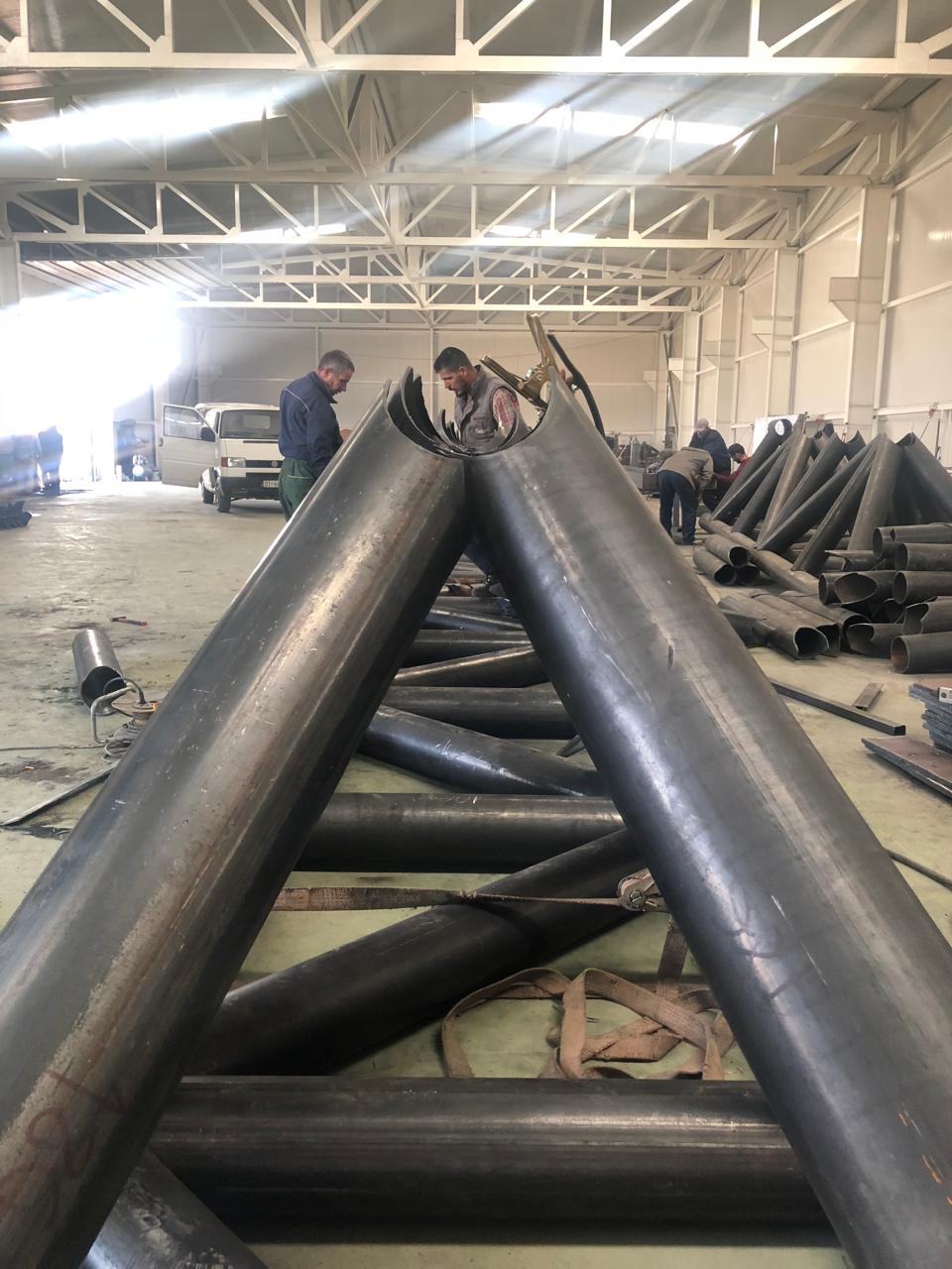

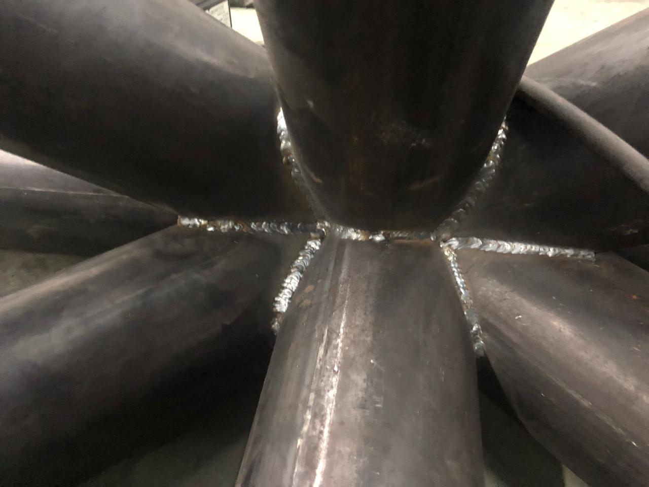

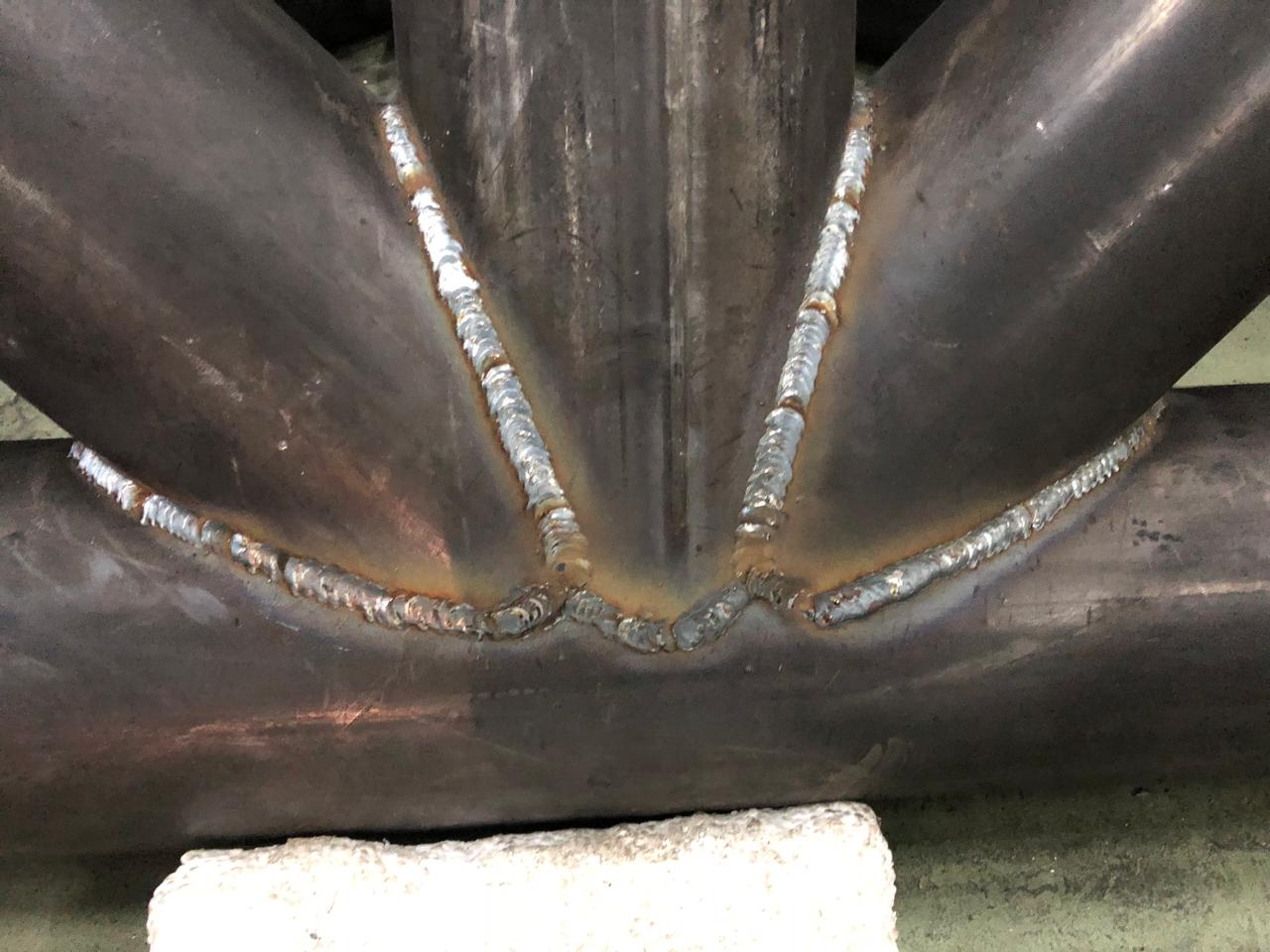

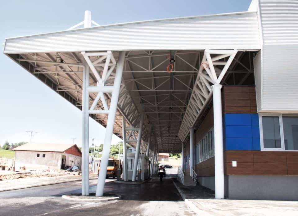

20 Feb 2025 22:35 #322119
Replied by tommylight on topic CNC plasma tube cutter
- Posts: 21962
- Thank you received: 7478

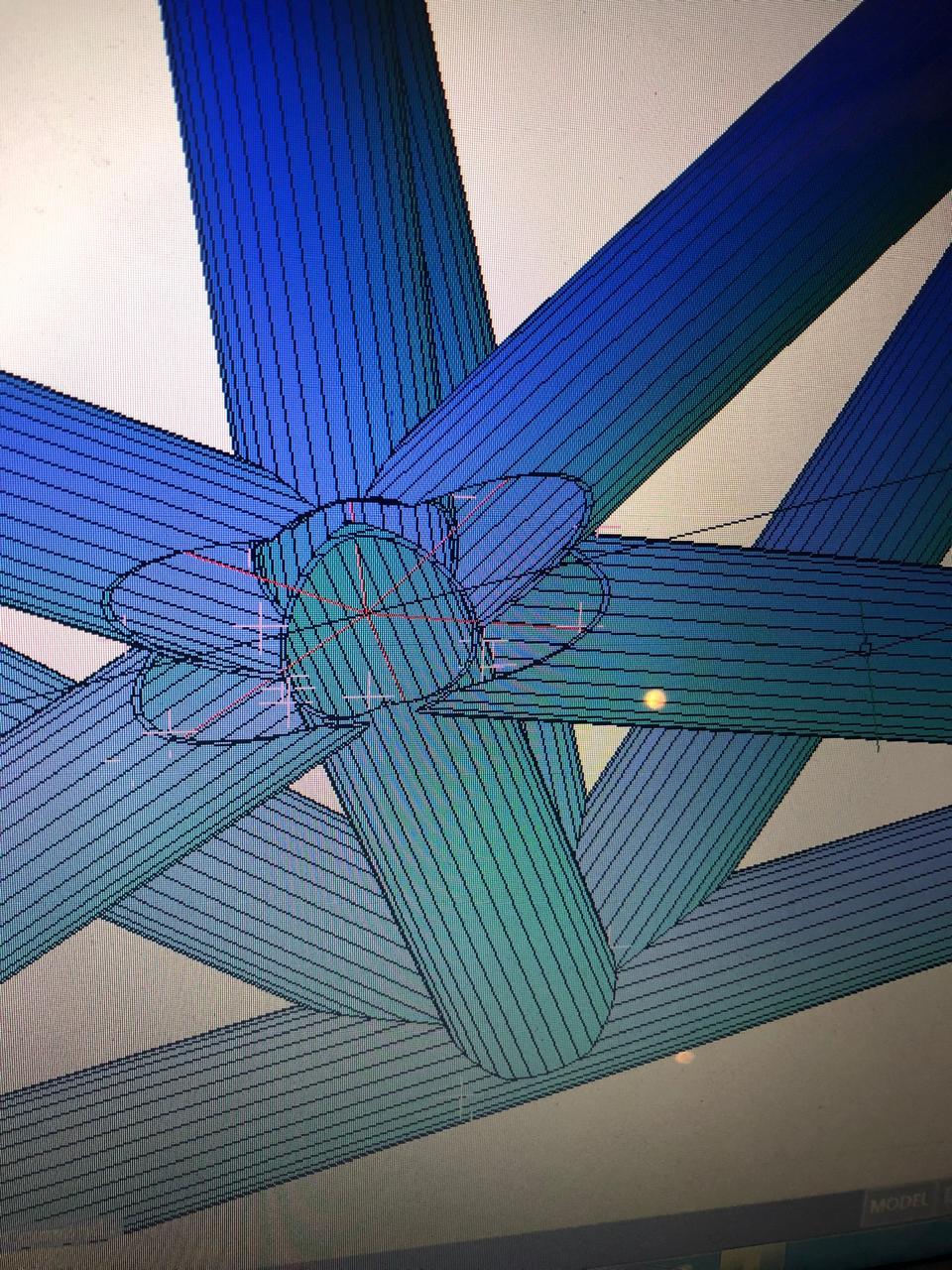

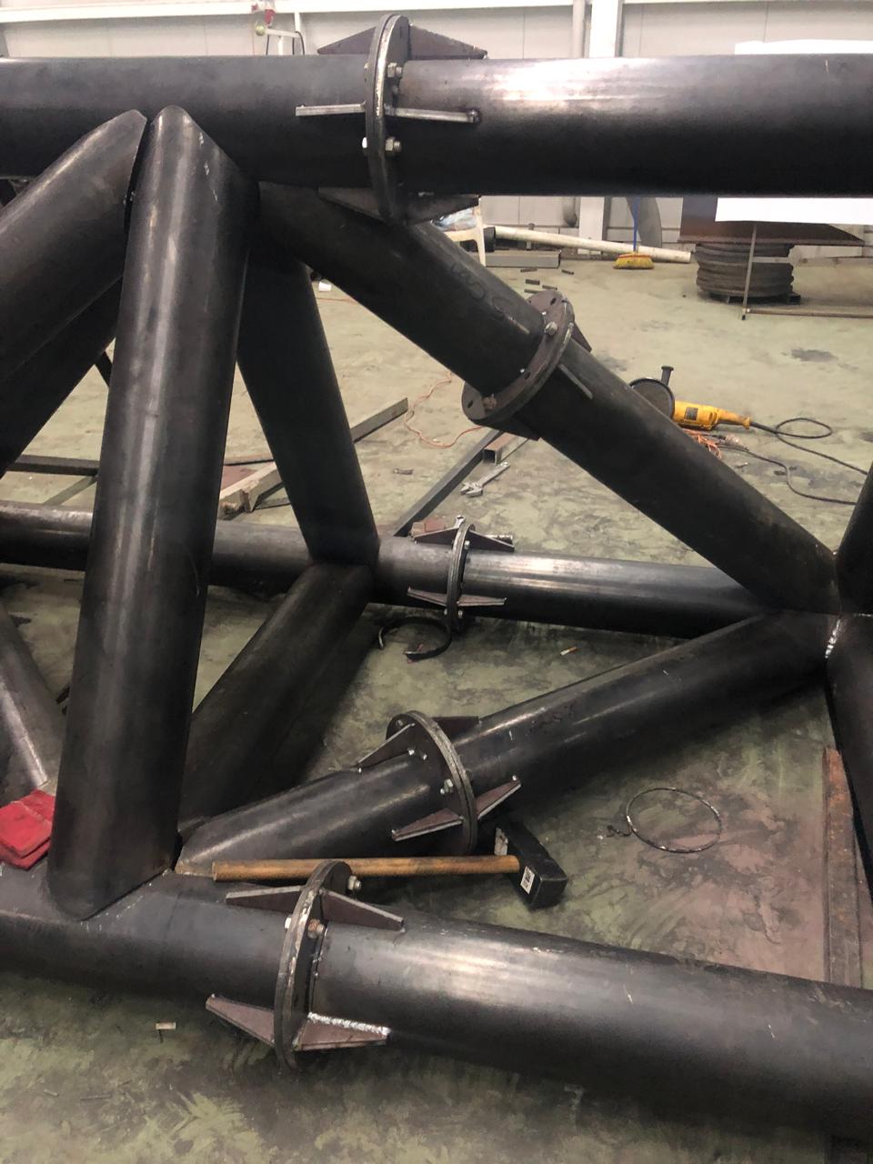

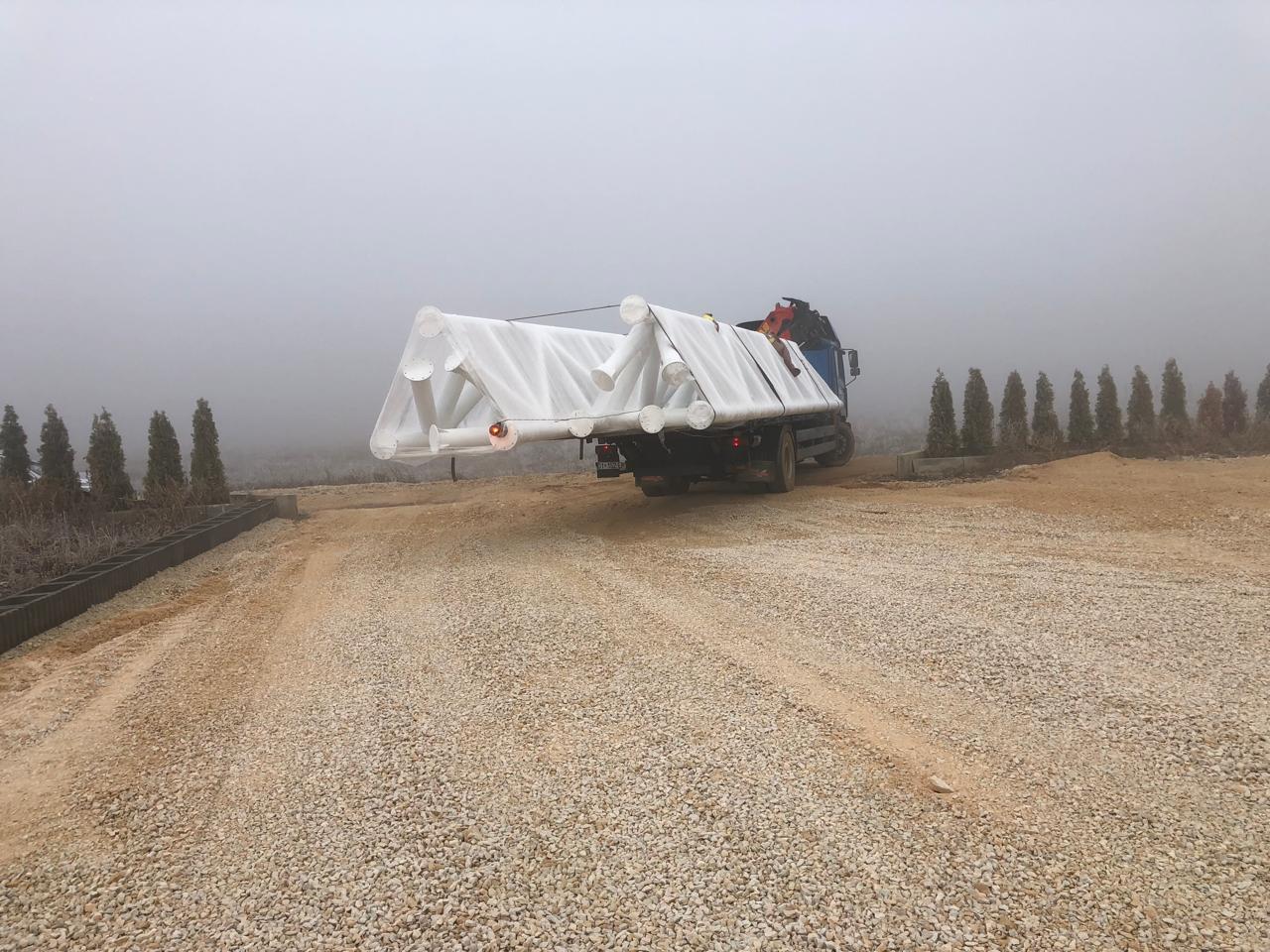

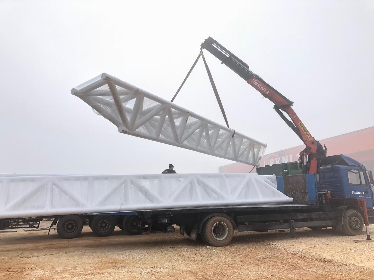

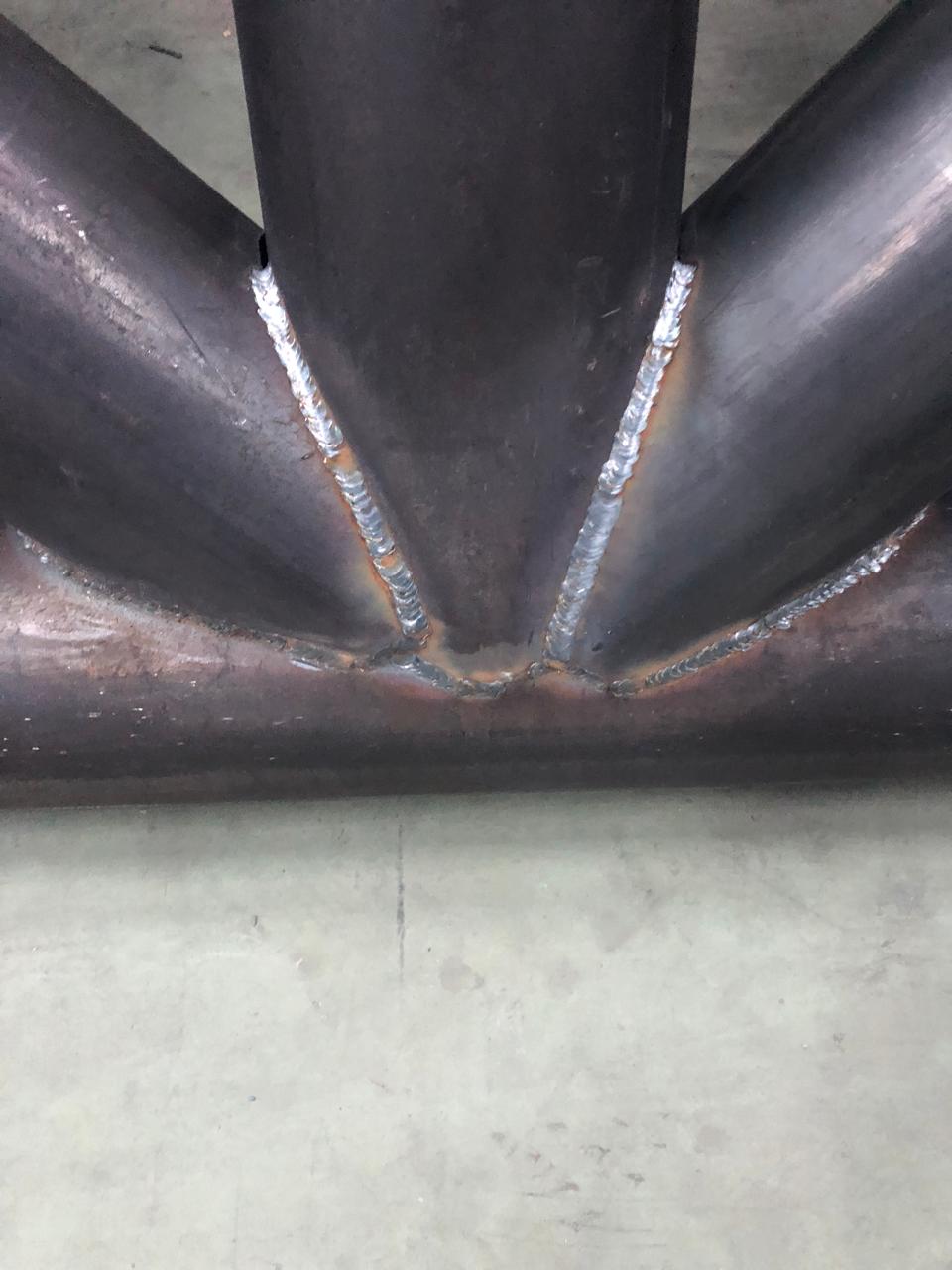

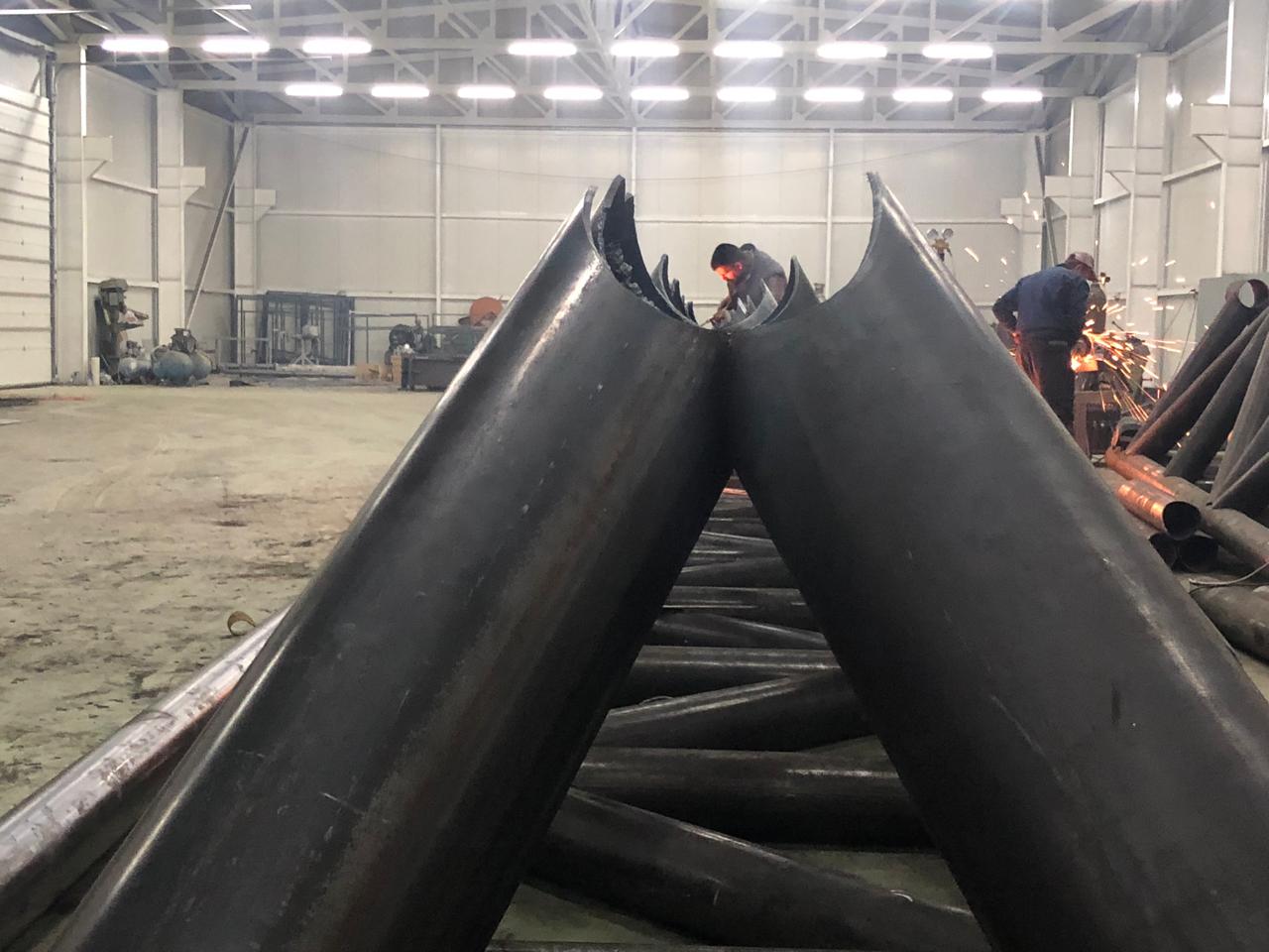

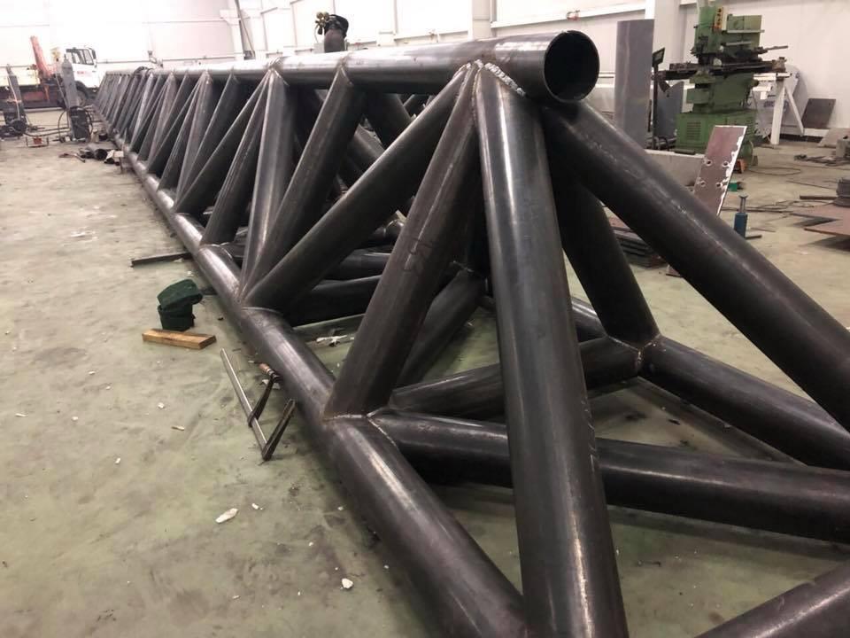

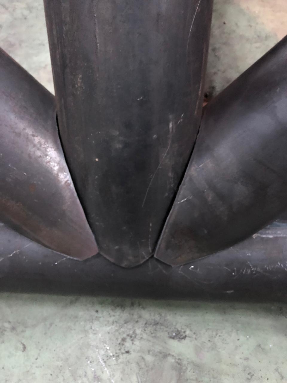

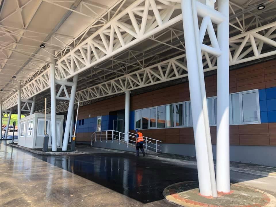

04 Nov 2025 22:48 #337846
- Posts: 21962
04 Nov 2025 22:49 #337847
- Posts: 21962
04 Nov 2025 23:11 #337851
Forgot to add, tubes are 76mm and 193mm in diameter, if the scale is not apparent from pictures.
