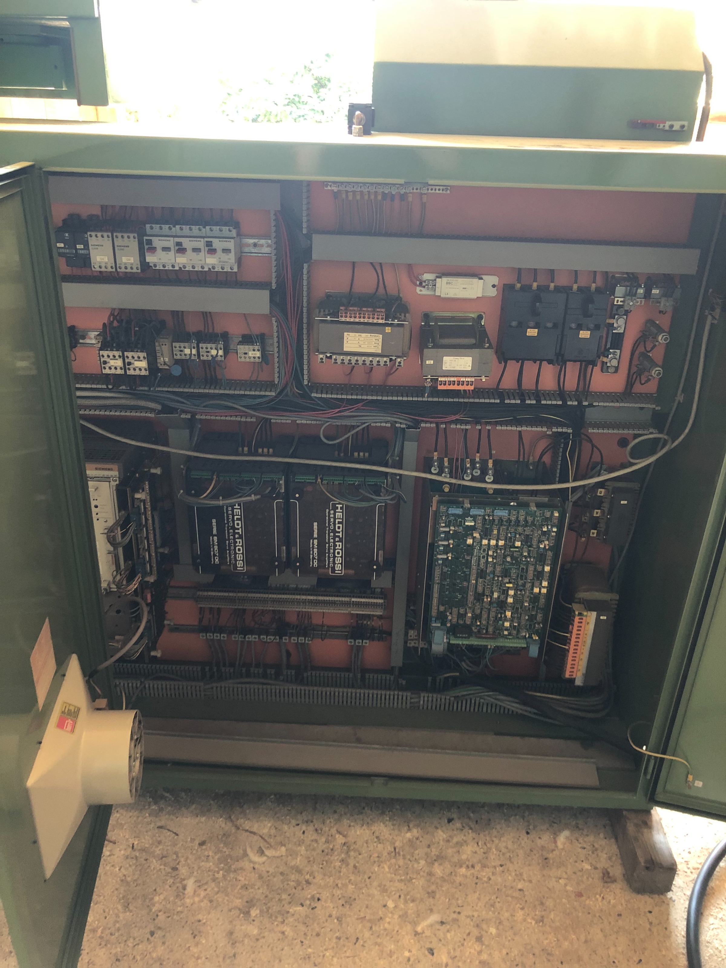

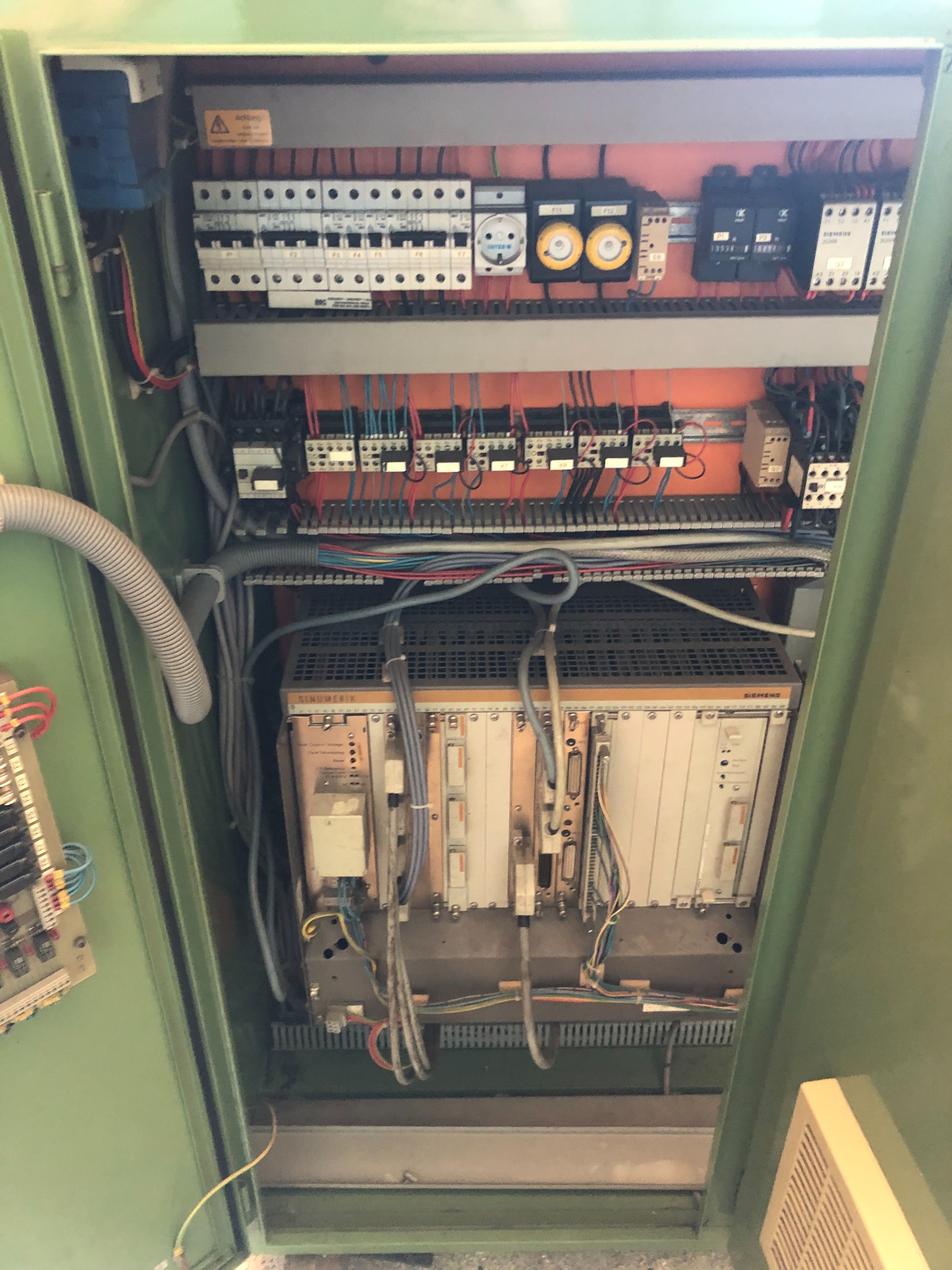

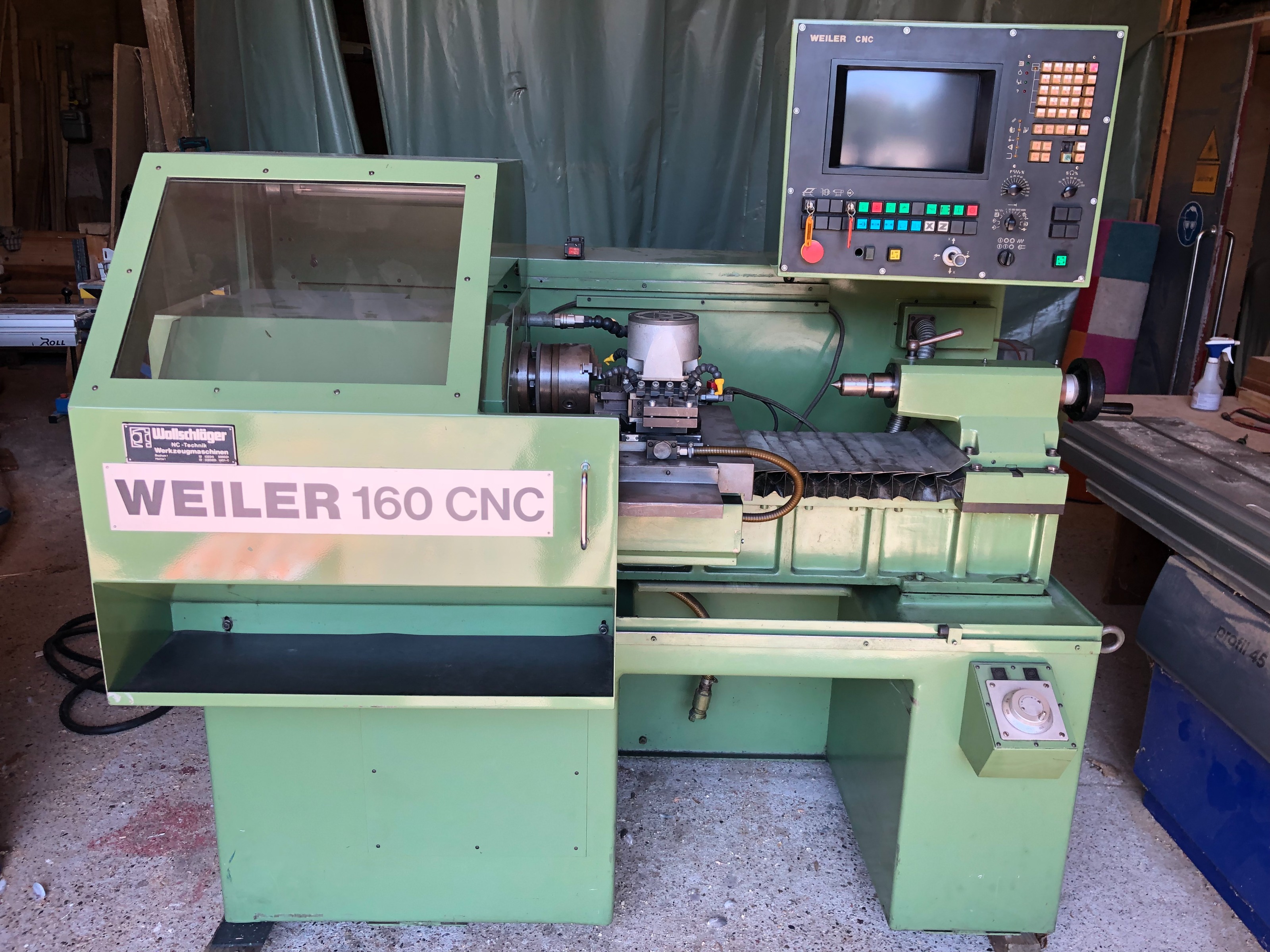

After years of using a very old (1930) and worn out lathe, I decided to get myself something new.
Found a Weiler 160 CNC in very good condition (400 spindle hours) that has been used lightly in a school. The buffer battery is dead and the screen does not turn on anymore, so a perfect project for a retrofit.
The documentation is one of the best I've ever seen, everything from bearing preloading up to motor change of the toolchanger is described. Tons of drawings from every part. The whole machine just screams german quality.

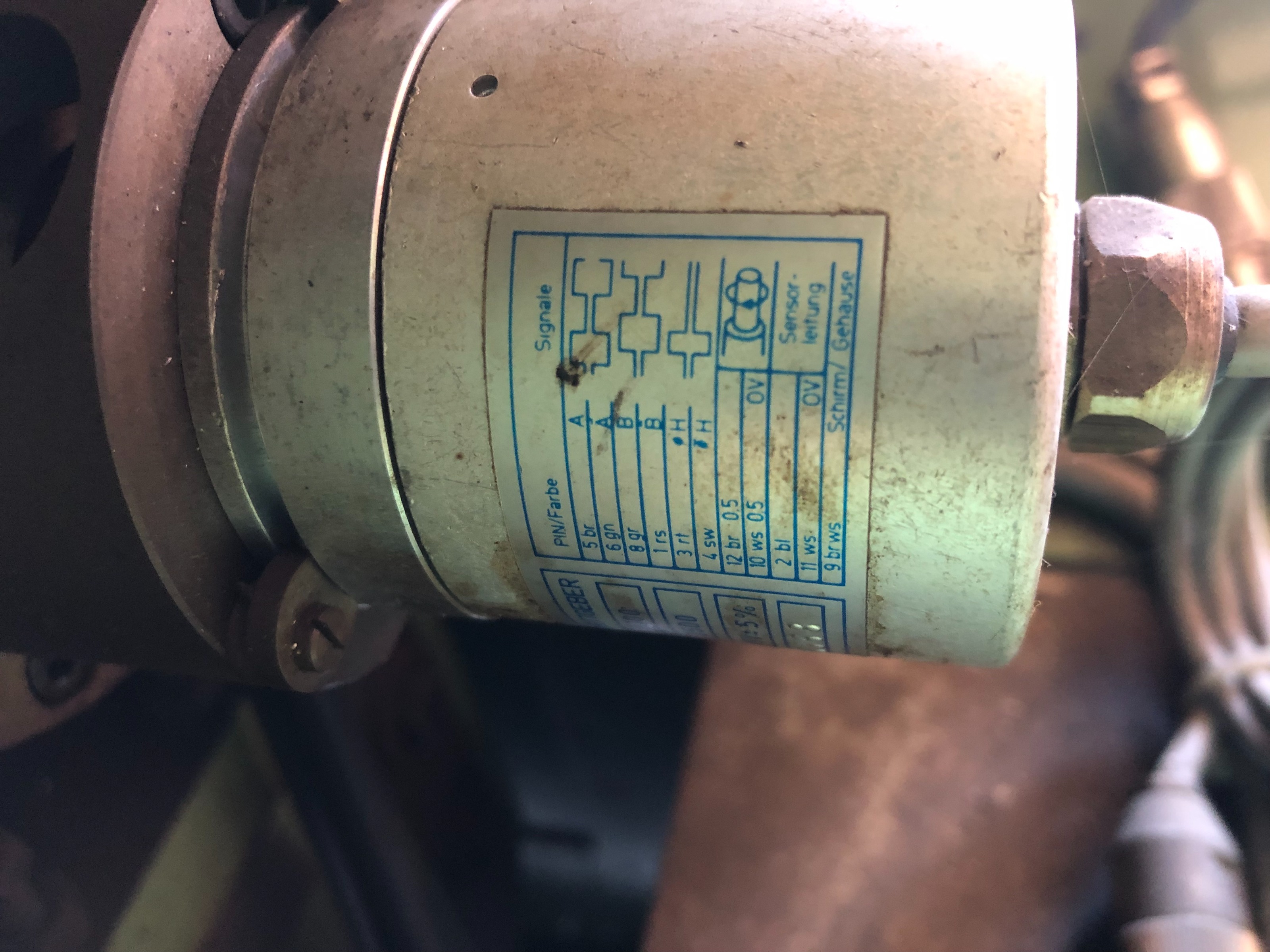

Only thing I'm not really sure about is the measuring system. It uses incremental encoders with 6 signal pins instead of glass scales. Does anyone know how I connect them to the mesa cards? Can I use the normal encoder inputs for that or do I need something else?

They look like 'normal' differential encoder outputs. A/A-, B/B-, and H/H-... with H being the once-per-rev index signal.
Should be a standard Mesa connection.
Are those encoders connected directly to the ballscrews, or to the motors? What's driving the motors?

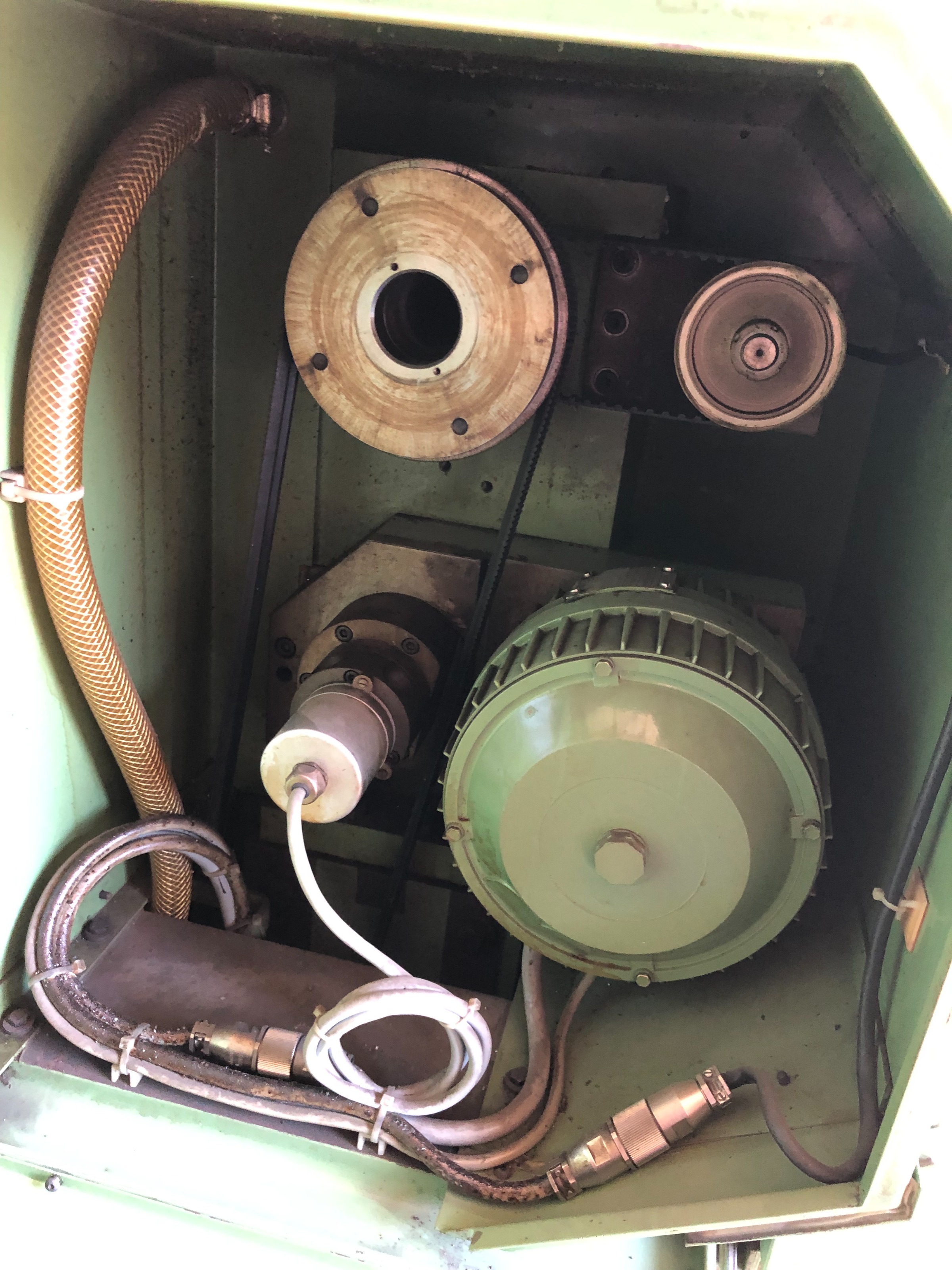

Aah of course, H is the once-per-rev signal. Somehow didn't occur to me, but now it makes sense, thank you!
They are connected directly to the ballscrews, the spindle encoder is connected via belt. They use "Heldt & Rossi SM 807 DC" servo drives for X and Z and a "Baumüller BKF 12/70/400" for the spindle. Controller is a "Sinumerik 3T".

I'm not personally aquainted with those drives, but a quick internet search makes me think they're analog-input DC servos.
Hopefully someone with more experience will jump in, but you could probably take your pick of with re-using the drives with an analog Mesa, or switching to modern AC servos (with analog, S&D, or field-bus/Ethercat).
Nice lathe, by the way. You'll be giving RotarySMP's Schaublin 125 a run for the money.

@spumco Wow the white looks so clean, got me a bit jealous haha. I'll try to keep all servos original, they probably have a better quality than some chinese servos, even though 30 years have passed.

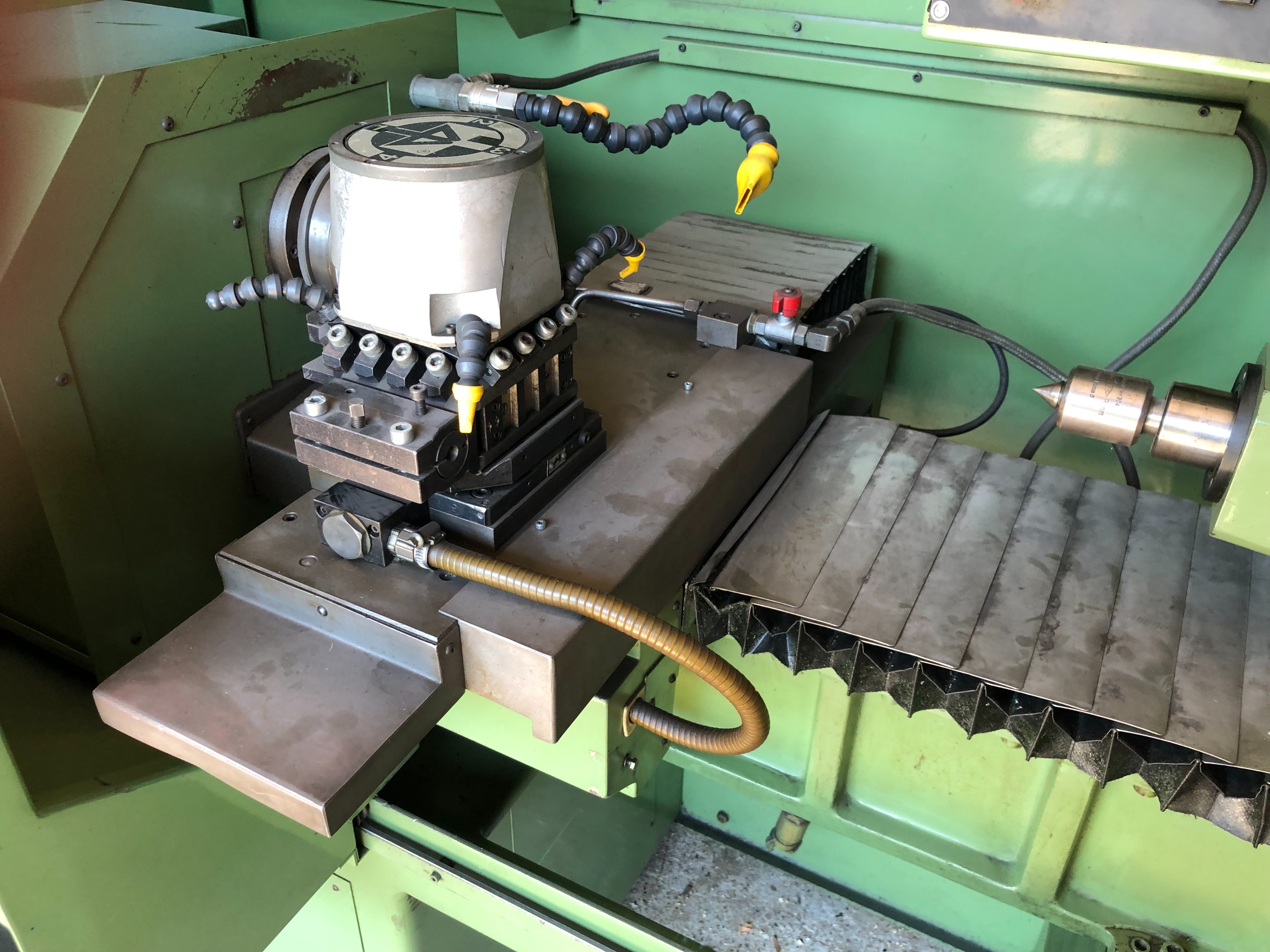

Wow, that is a sweet machine. It sure makes sense to modernise machines like that rather than converting manual machines. If the analog drivers still work, this could be a really simple retrofit. Like I did with my Maho. Not having to touch mechanical aspects of the machine can save you a ton of time getting it up and running.
How did Weiler do the home/end switches on this one?

Is the writing on that machine in Slovenian language?
