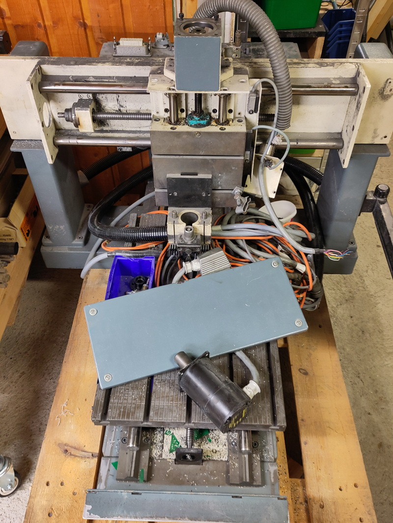

Hi everyone!
I'm a long time lurker but first time poster.
I've been wanting to do something with LinuxCNC for a while now probalby 8-10 years. I've built/run several 3D printers as well as a Queenbee CNC Gantry router but using GRBL and ESTL controller has been way to simple to get up and running.
Meaning I've both been lazy and haven't really seen the need for using LinuxCNC.
I did plan on replacing the ESTL controller that is running the Queenbee router but it is working way to good for me to mess with it.
However!
An opportunity arose when I found a Kuhlmann mill on auction for next to nothing, probably since the controls where both partly missing and outdated, so i got it for an absolute steal, including service fees and tax it was less than 50 Eur.
So my plan is to retrofit it with LinuxCNC, convert it from steppers to Servos, and run both IO and servos on ethercat.
I figure I will use this a s a build log, I am also planning to film most of it but I have no idea of how quickly I can get any videos out.
It has been some time since I edited any video but I think it would be fun to get back to it again.
I hope to have updates here every other week or so, depending on life.
If you have any suggestions on hardware/config or any pitfalls to avoid, give me a heads up!

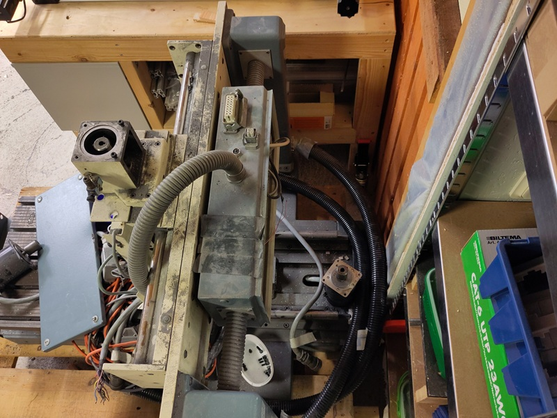

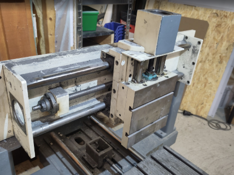

The mill as it looked when I picked it up. It looks like is has mostly been used for cutting plastics, based on the debris Iv'e cleaned from it so far.

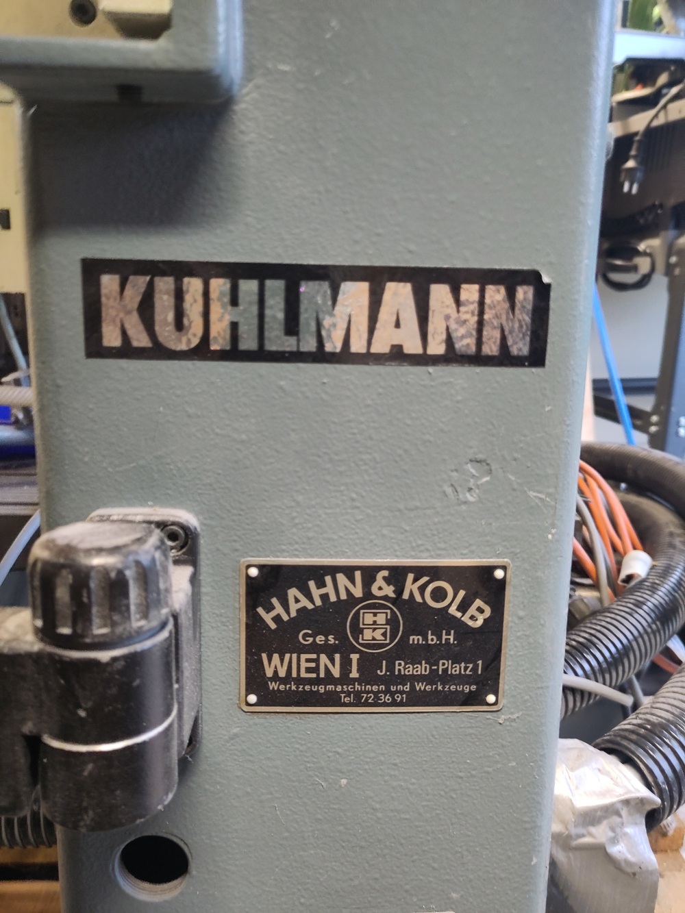

The manufacturer as well as the original seller of the machine

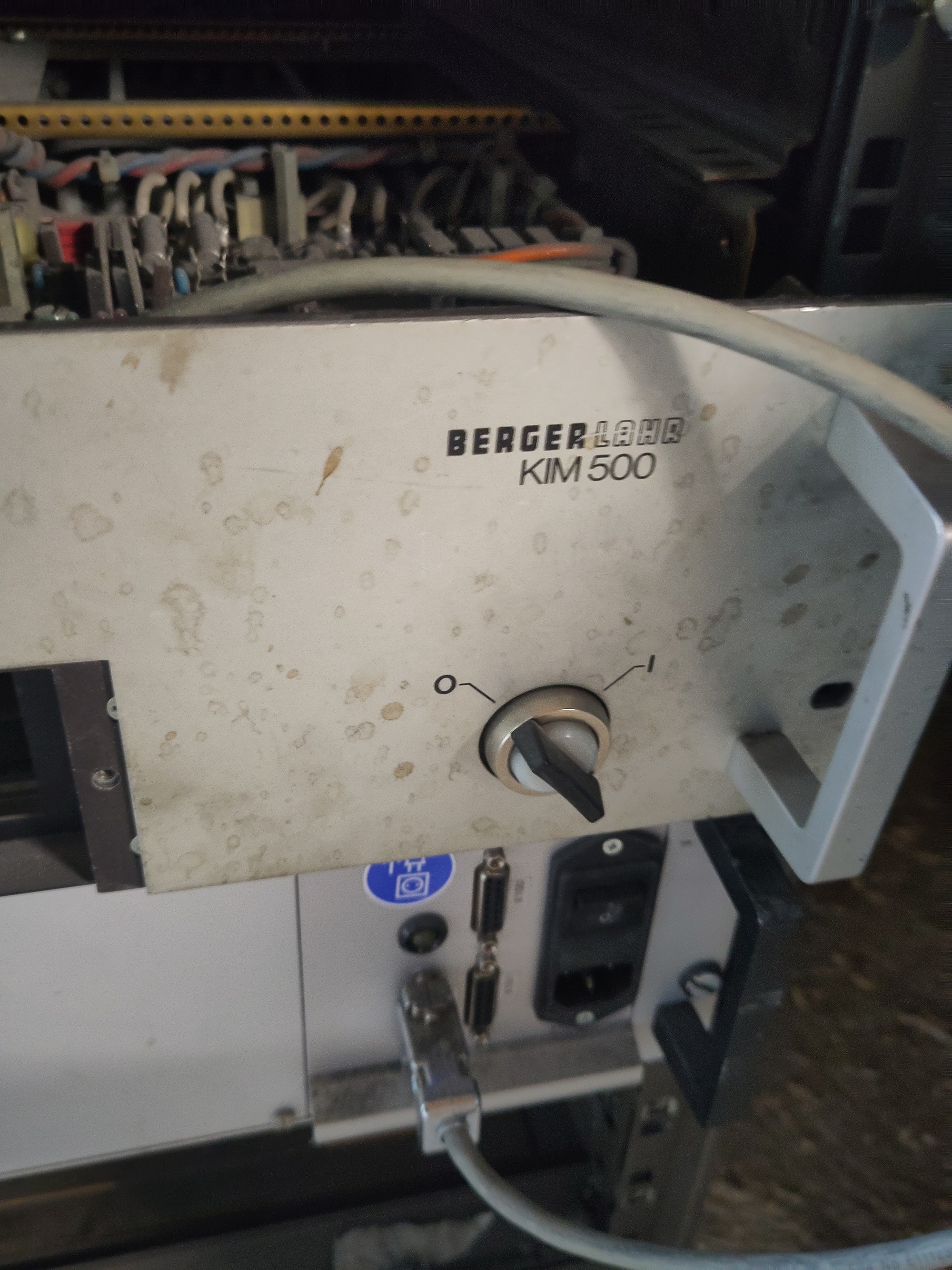

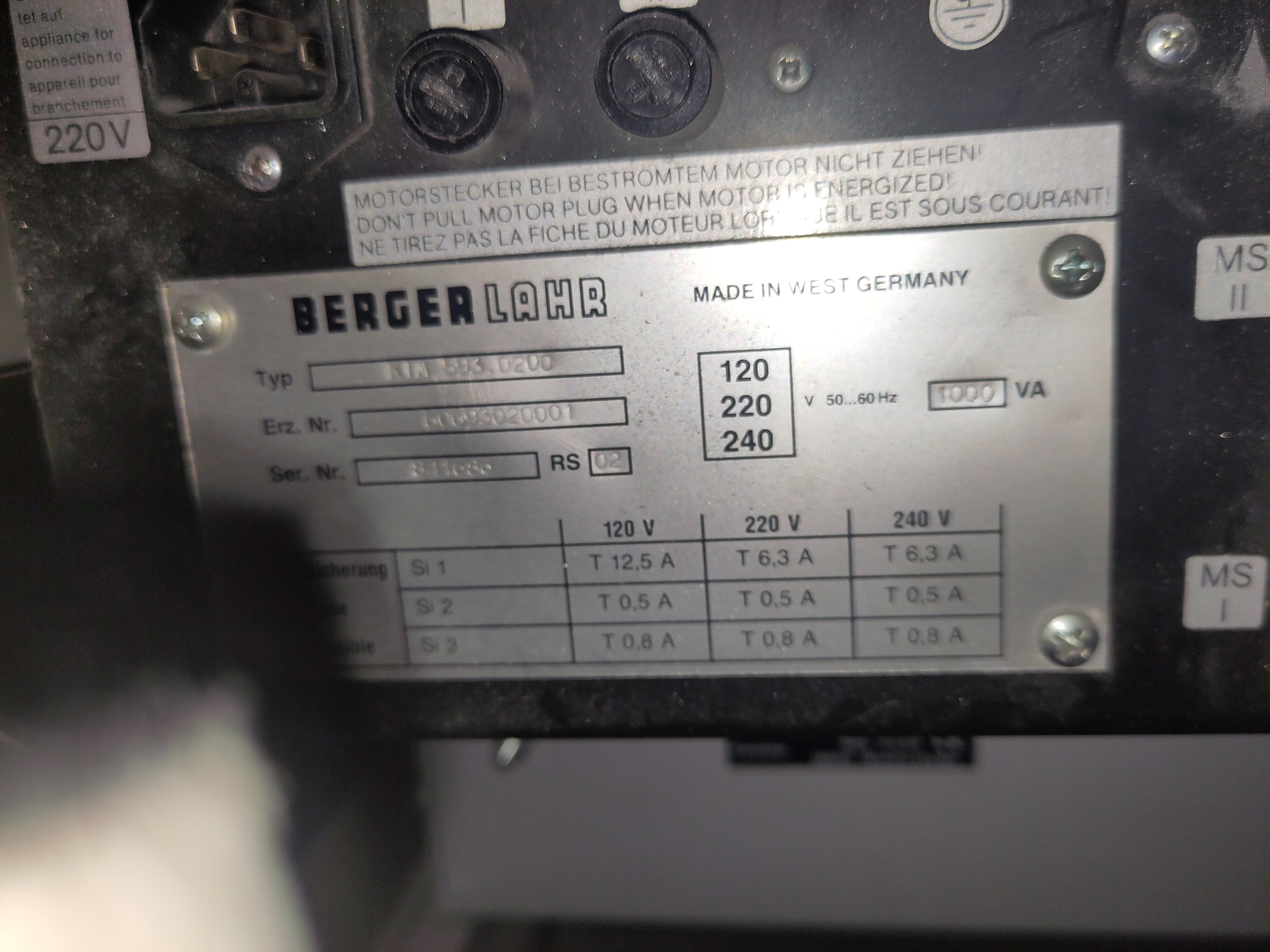

The extremely outdated control system, a Berger Lahr KIM500. I have not found much info about it and all the stepper drivers are missing, the shop I got it from had several other Kuhlmann mills so my guess is this one has been scavanged for parts.
Berger Lahr was bought by Schneider Electric ages ago, before the internet was really a thing so there is not much info out there on them at all.
It was set up to use 5 phase stepper motors, and IF i had been able to find any drivers I might have used the orginal motors to save some money but no one seems to supply generic drives for 5 phase steppers.

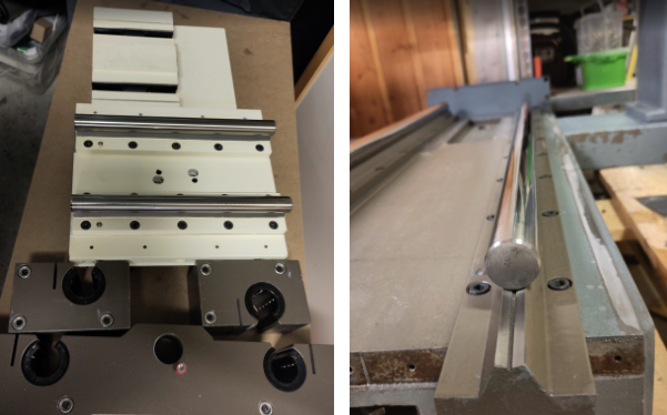

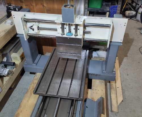

So it has been slightly more than 2 weeks, more like five or six because of reasons. But I have managed to make some progress over the holidays. The first step was obviously to clean up the entire machine, it might not have seen any serious use in a long time, if ever, but it was still in need of a serious cleaning.I started by removing all the cables and electrical parts from the machine since basically all of those will be replaced anyway.It turned into a neat little pile

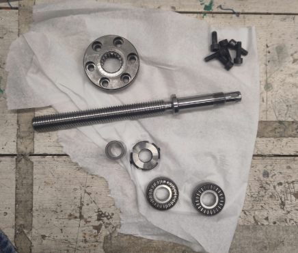

After that I started cleaning the machine and even though I hadn’t really planned it I also pulled apart like 90% of the mechanics and cleaned all the parts individually.This was really necessary as I hadn’t been able to get all the plastic chips and old grease of any other way.

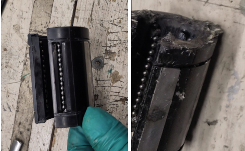

This included pulling apart, cleaning and re-greasing both the needle bearings for the ballscrews and the linear carriages. As far as I can tell all this hardware is still available, the bearings and what not, so it shouldn’t be an issue to service it if any parts give out in the future.
Just look at that before and after. Some of the balls didn’t circulate at all since the traces were so full of hardened grease, depending on the loading direction. I got all of them running again after first wiping them down with break-clean and then flushing them with penetrating oil to loosen and rinse out all the grease.I didn’t remove any of the supported rails so hopefully I haven’t caused any alignment issue. We’ll see when everything is back together, I will do a proper alignment check then.
It cleaned up real nice so I take that as a confirmation that this is a fairly low-hours machineIt’s mostly back together again and I think the next step is to work on the motor mounts. To that end I took a bunch of measurements when I had it apart to be able to manufacture some adapter plates, I will start to just 3D print them and when I have a design I like i’ll cut them on my old CNC router. It hasn't been used in a while so that will be nice.
