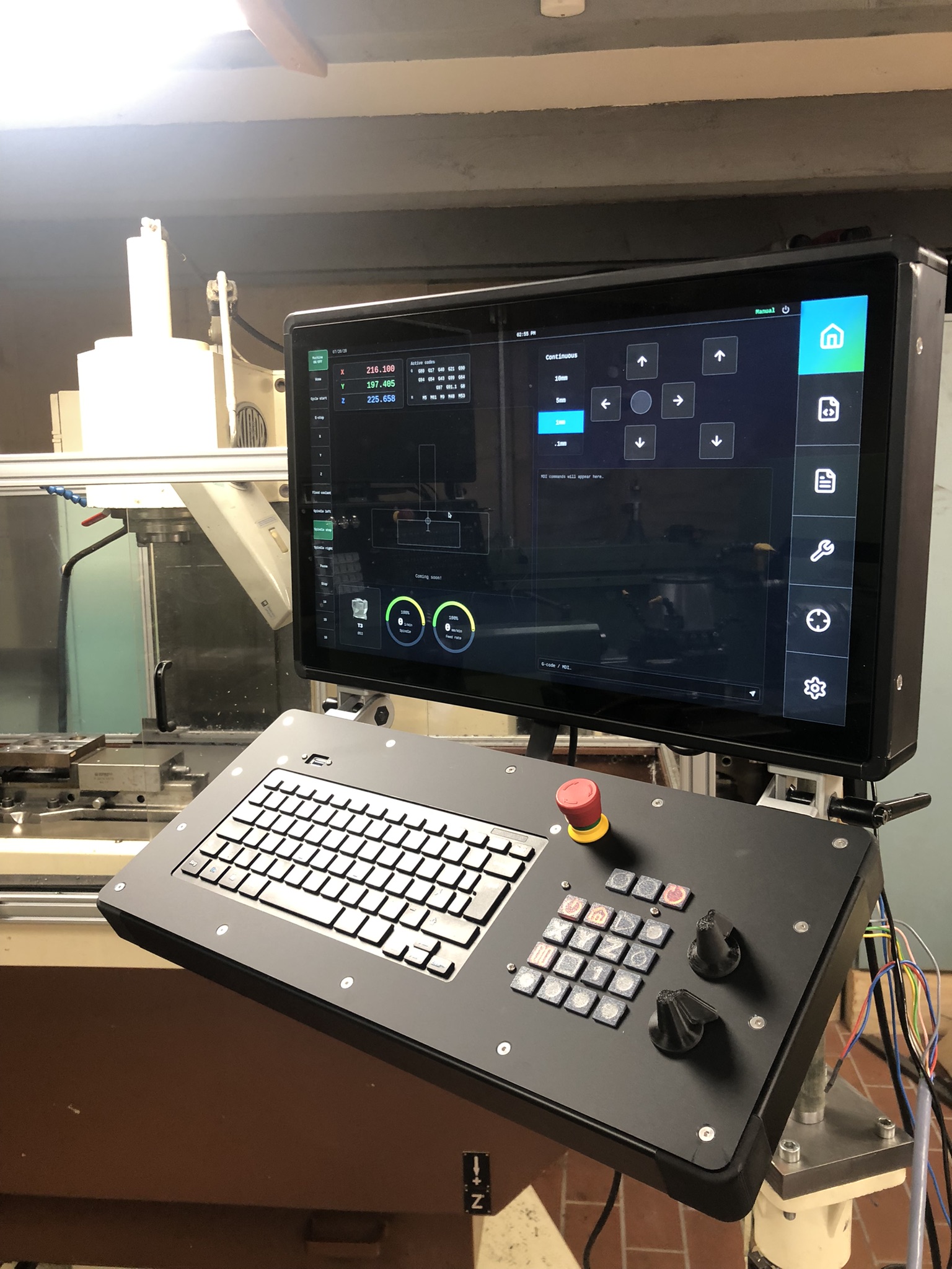

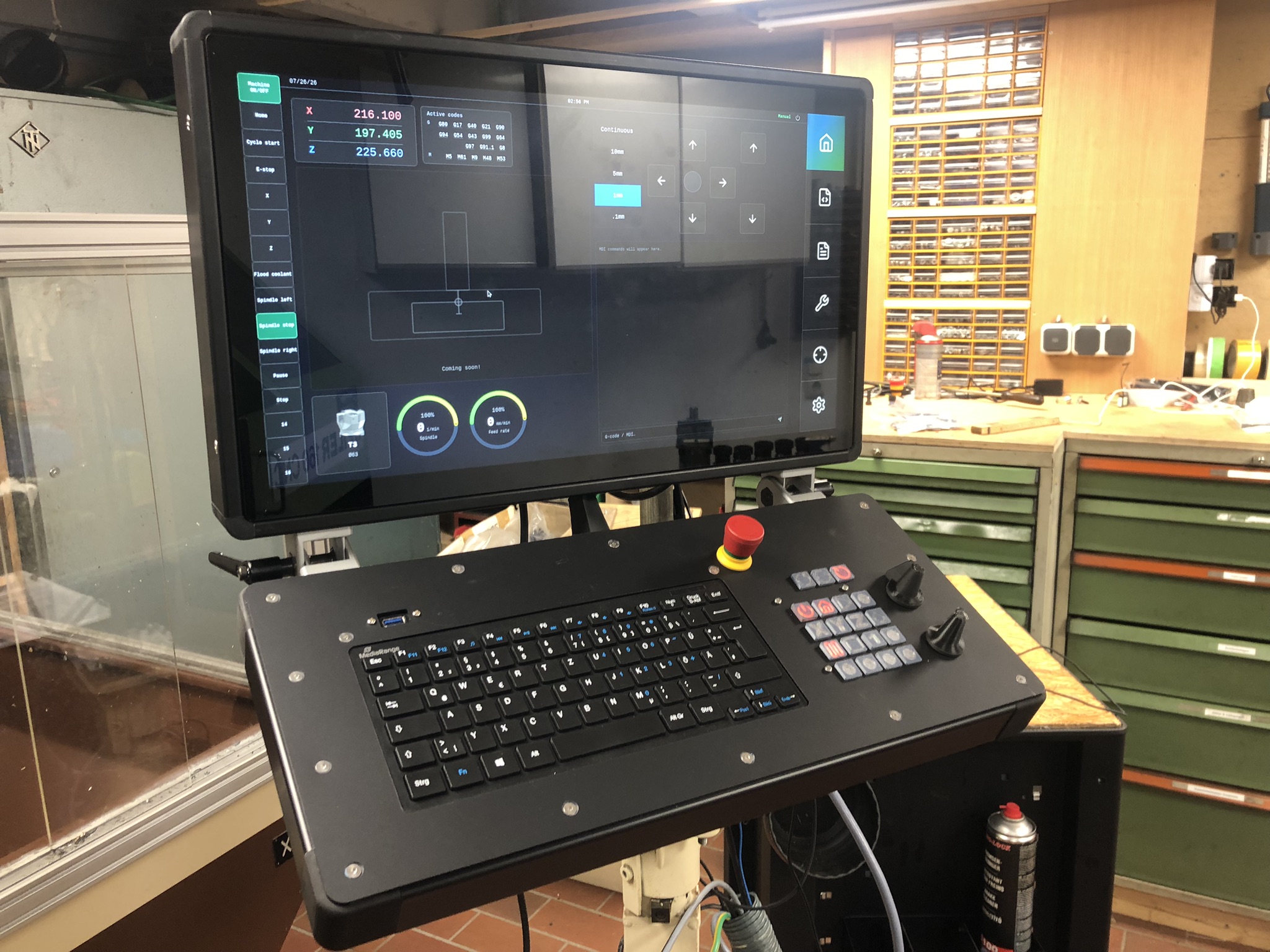

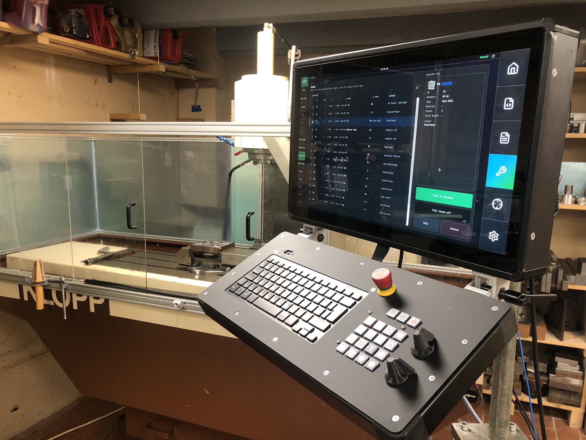

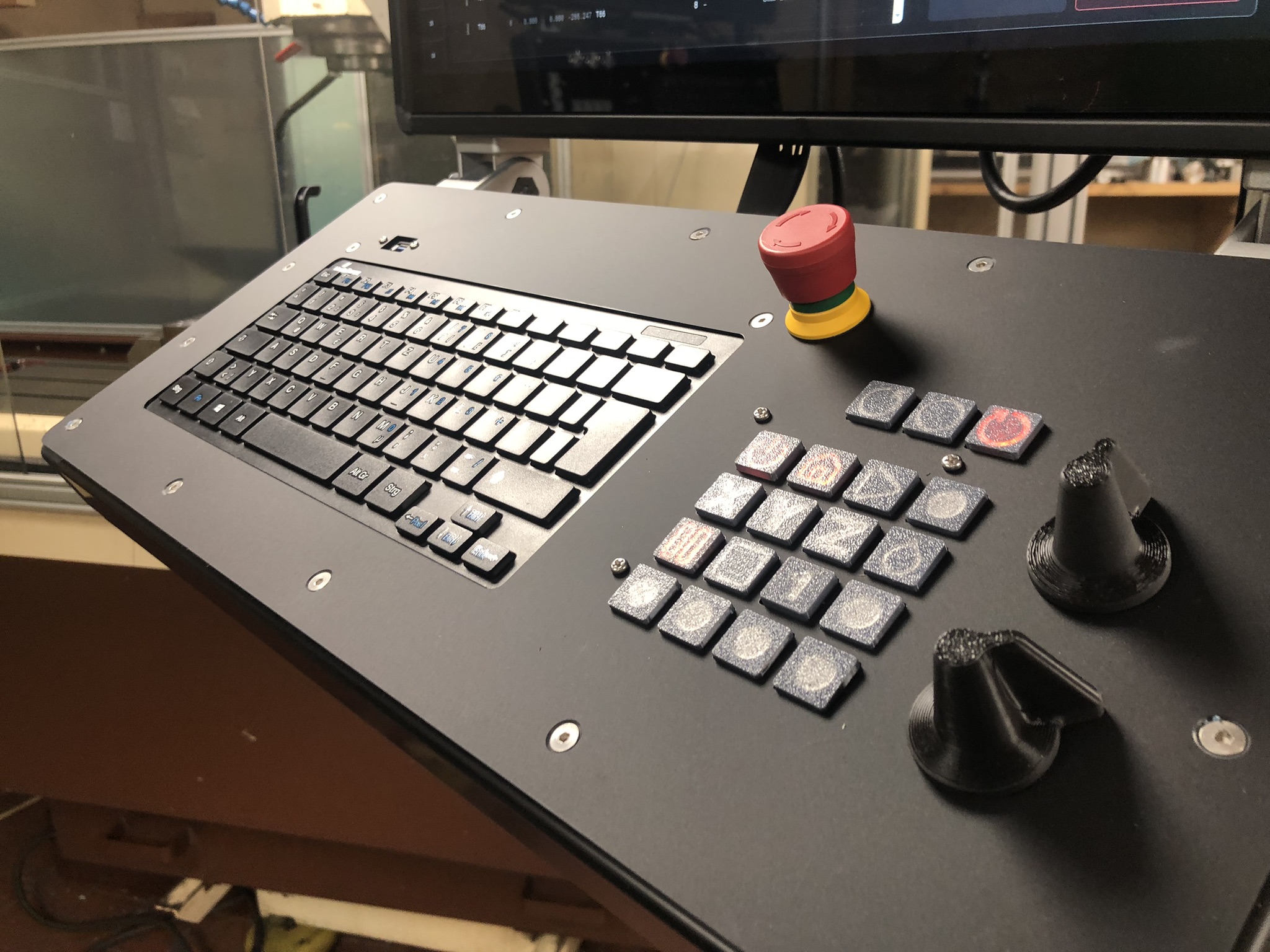

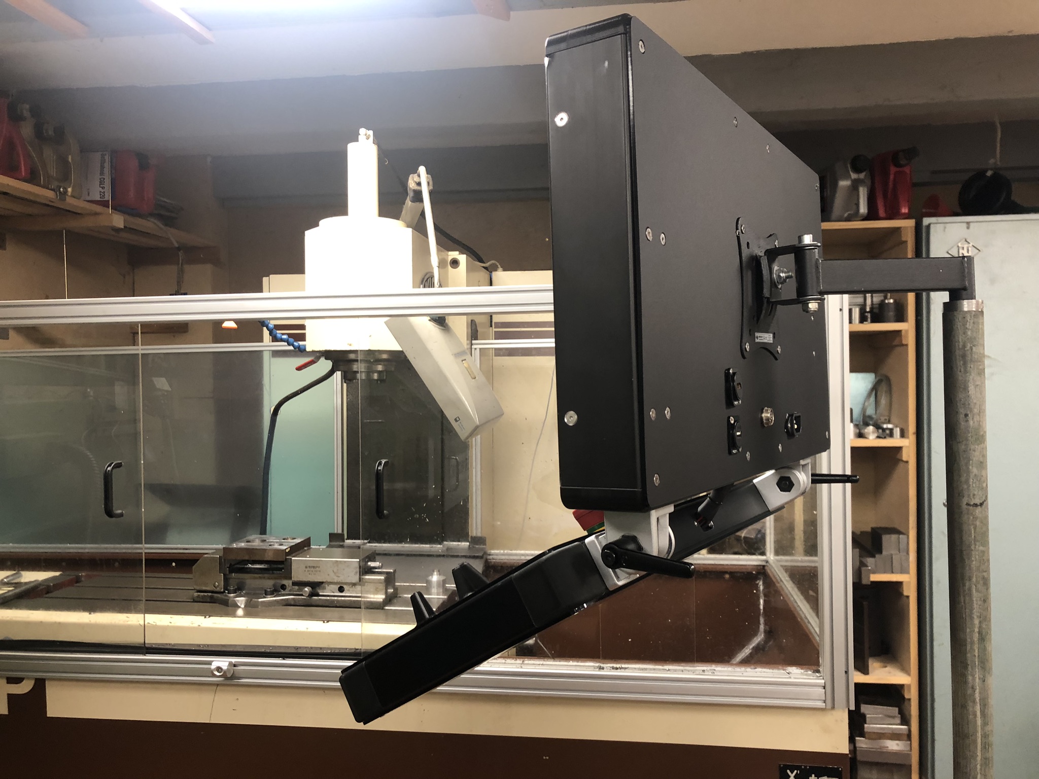

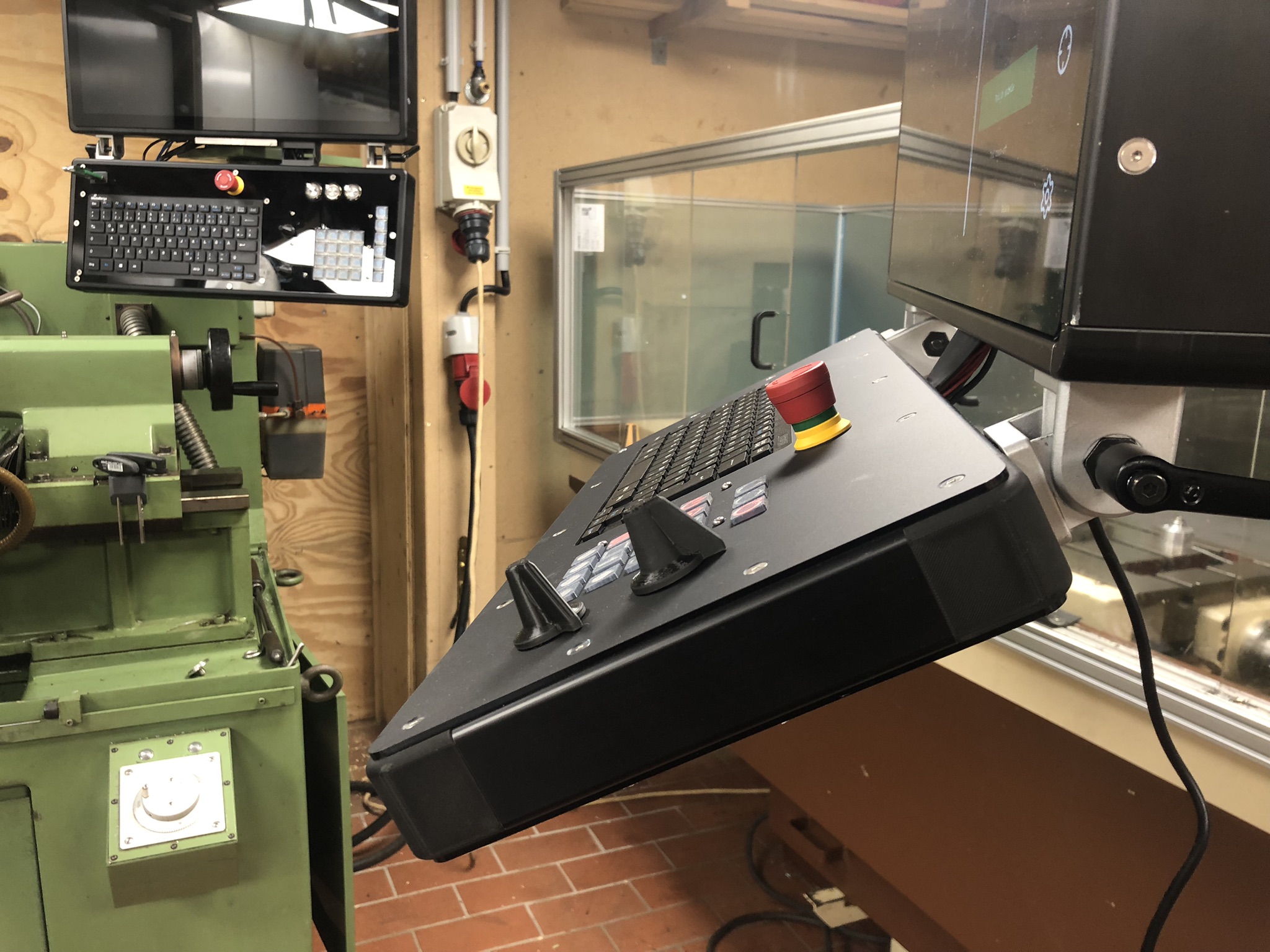

Hey,I retrofitted my CNC mill a while back and since then had a more or less ugly touchscreen built into the original housing.Since the touchscreen now stopped working as well, I decided it was time to make something more modern.It features a 21" touchscreen monitor, a full keyboard, some rotary encoders for overrides and 19 custom made buttons (for on/off, homing, coolant etc.) that can be illuminated separately with a custom hal component.The angle of the keyboard can be adjusted and the back has connectors for HDMI, USB, Power and the emergency stop signals (I don't wanna send the via USB for safety reasons).The frame is made from aluminium, the front and back is matte acrylic. It can be mounted using a standard vesa mount.I already did a v1 of it when I retrofitted my lathe, so I could make some improvements.Let me know what you think
