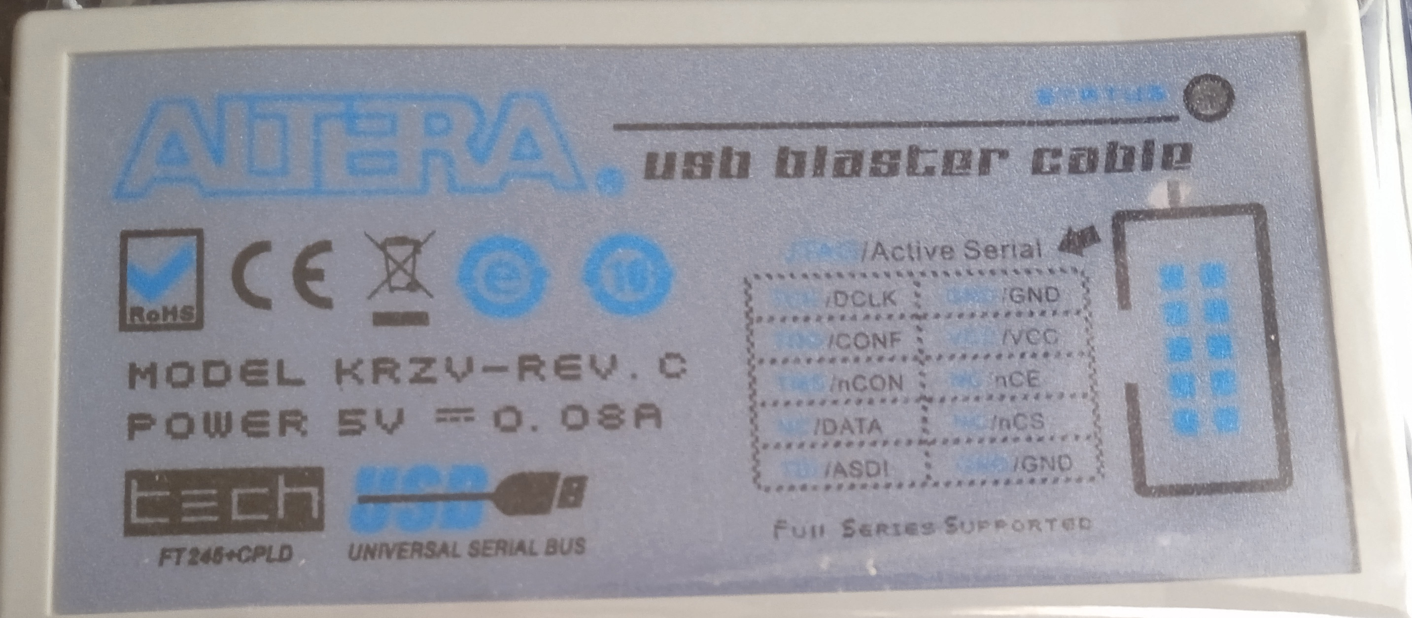

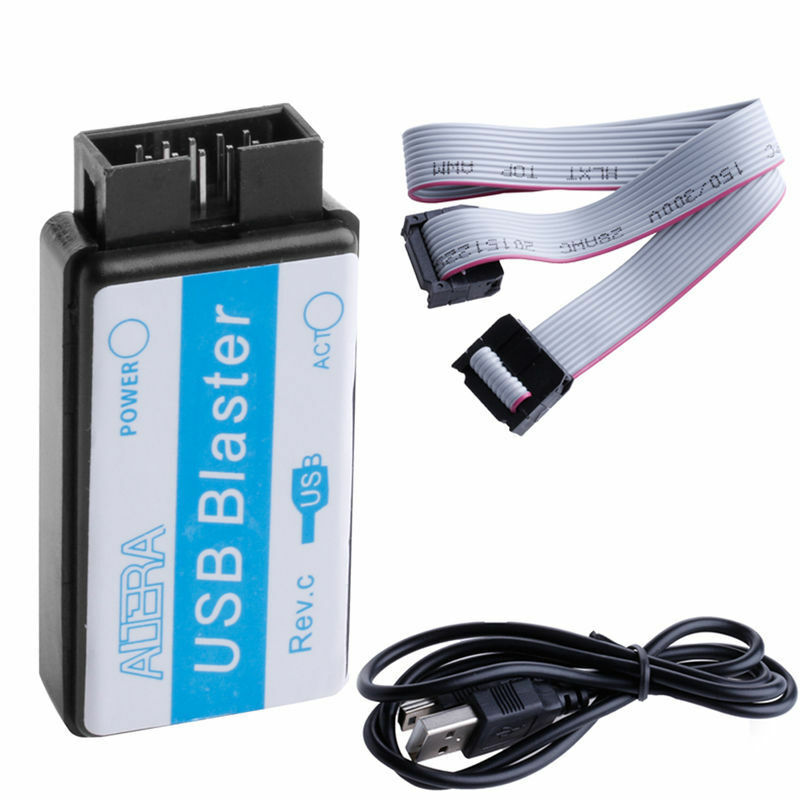

27 Feb 2022 22:23 #235949
by tuxcnc
The programmer is still in bag, because I have dispute with seller.
I don't know vendor and id, but have photo :
Replied by tuxcnc on topic ColorCNC Colorlight 5A-75E/5A-75B as FPGA controller board
I ran colorlight_5a_75b.py before set path, probably this is explanation.If you follow my instructions, you don’t need to install migen as a seperate item.
What is the vendor and product id of your programmer ?
