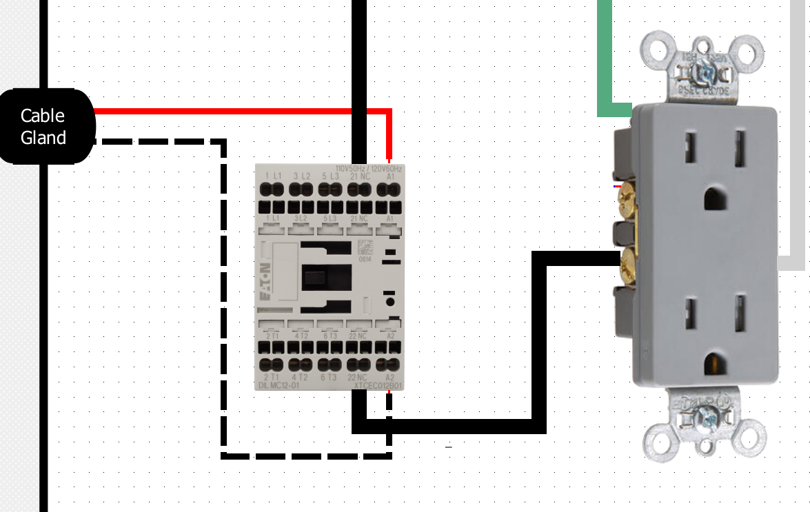

Something else I need to figure out is how to connect the Dust Collector so that I can use it in my woodshop as well. I use the DC in my shop with a remote (switch is not easily accessible because the DC is mounted on the wall at the ceiling). I have ducting ran to all my equipment.
I am thinking that I need a way to have the pole closed (NC) when power to the cabinet is OFF. I am not sure how to accomplish this though?
29 Nov 2022 23:28 #258049 by Sray69
I feel like I am overthinking this. If I use the NC terminal for the 120VAC then when I turn the power to the cabinet off, the dust collector circuit should still have power, correct?
Would I use the inverted "NOT" state for the 24VDC signal so it would provide power to the contactor when the CNC is not running, keeping the contacts open? Then when the CNC starts I would then have it cut power to the contactor closing the contacts, providing power to the dust collector. Is this correct? Or is this a too simplified approach? Is there more steps needed to make it work better/safer?
29 Nov 2022 23:39 #258051 by spumco
Is this correct?
Yep, except for the other Mesa connections (VIN, etc.)

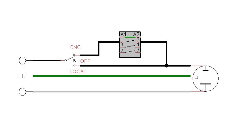

If you're really dead-set on having local/remote control of the vacuum, a 2 or 3-position changover switch mounted at the dust collector recepticle would work.  Position 1 is local, position 2 is CNC. Center off if you want a 3-pos.  Switch must be rated for full load.
See if this makes sense:

29 Nov 2022 23:41 #258052 by spumco
You're overthinking it.  Use the NO contacts, and only supply 24vdc when you want the dust collector to run.
The following user(s) said Thank You: Sray69
30 Nov 2022 00:03 #258056 by Sray69
Not sure exactly what you mean. Do you mean I am missing all the other Mesa connections for my cabinet? I hid all the other connections in order to just show the dust collector (DC) circuit. If you saw my diagram it is very hard to follow all the circuits. Trying to make it easy to understand.
Anyway, did I connect the DC 24VDC wires correctly?
I am good with a 3-way switch. Although I would like to try and relocate it into the CNC room just to make it easier to access and remember. But I can figure that out.
30 Nov 2022 03:35 #258086 by spumco
DC contactor connection - yes, terminals A1 & A2 are the +/- coil terminals.
And yes, if you hid the other connections to simplify things that's fine.  I just didn't want to assume anything when I replied.
