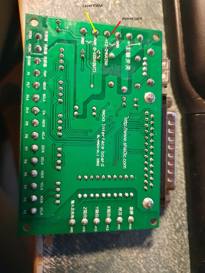

29 Sep 2023 19:00 - 29 Sep 2023 19:29 #281872
by swepeter
Replied by swepeter on topic TTL (PWM) Laser head and Mesa 7i76
Hi Again
I just received my card and want to double check anything before connecting it.
Am I thinking right here:
photos.app.goo.gl/y17RPj5UASp3UYWJ8
12V in to power the card and then the PWM port next to it to connect to the laser?
thanks again
thanks again
Last edit: 29 Sep 2023 19:29 by swepeter.
