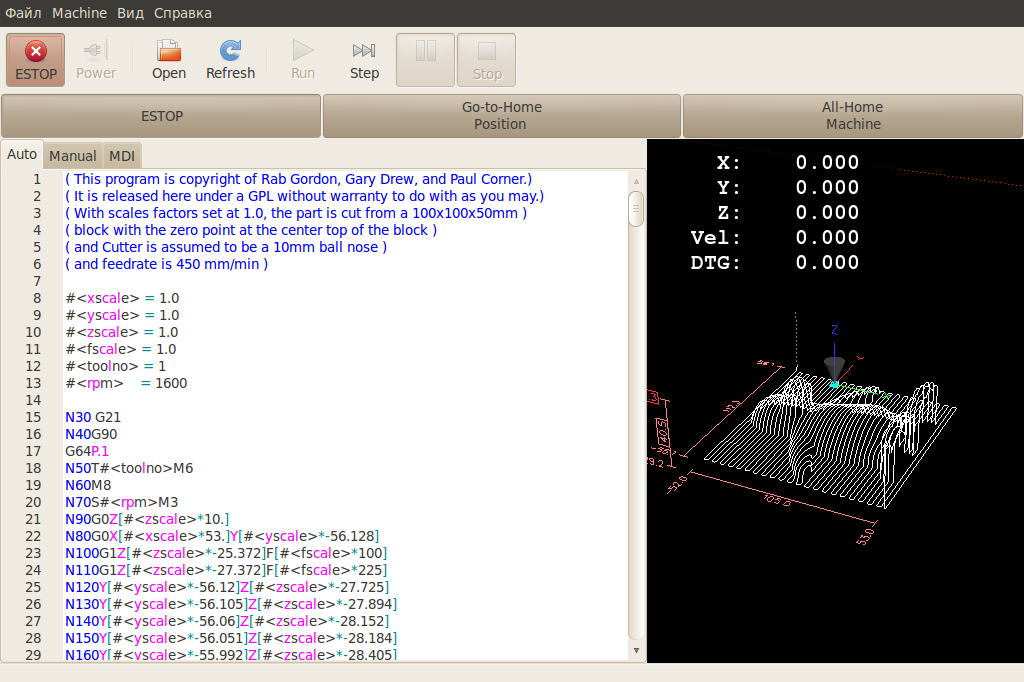

Hey for the people interested in rolling there own screens - Gscreen can now load really custom screens:
This is gaxis.
It's a screen that Pavel sent me once.
It's now a sample screen in sim/gscreen_custom/gscreen_axis.ini
This is gaxis.
