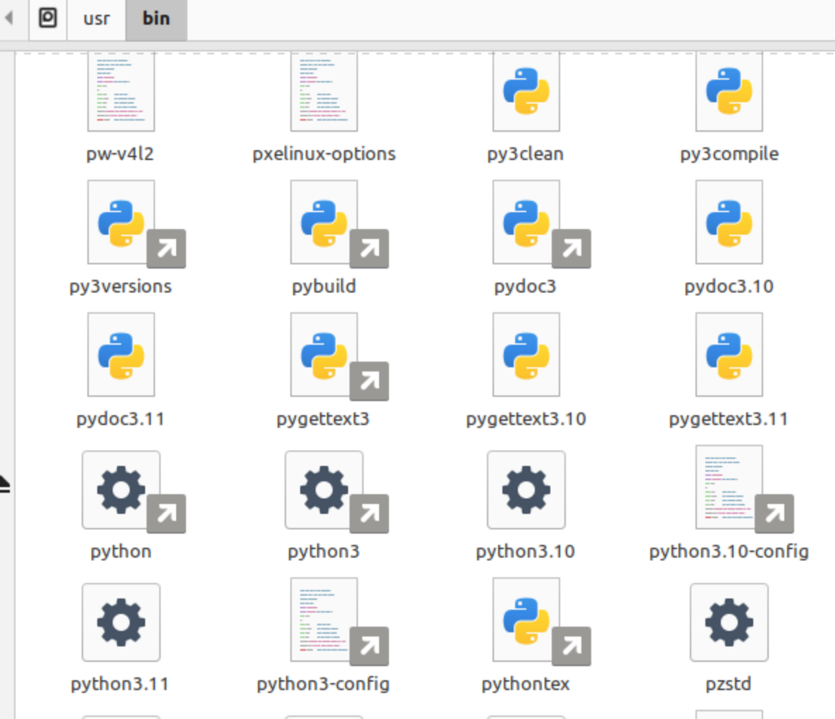

configure: error:
  Could not link test program to Python. Maybe the main Python library has been
  installed in some non-standard library path. If so, pass it to configure,
  via the LIBS environment variable.
  Example: ./configure LIBS="-L/usr/non-standard-path/python/lib"
   ERROR!
   You probably have to install the development version of the Python package
   for your distribution.  The exact name of this package varies among them.
[code]  选择       路径               优先级  状态
  0            /usr/bin/python3.11   2         自动模式
  1            /usr/bin/python3.10   1         手动模式
* 2            /usr/bin/python3.11   2         手动模式
要维持当前值
[/code]
  • [code]请按<回车键>,或者键入选择的编号:
    [/code]
  • It reports an error like this, when I use this command "./configure --with-realtime=uspace --disable-build-documentation-translation --enable-non"
    Do you know what his problem is!
    Looking forward to your reply

15 Mar 2023 10:49 #266738 by Aciera
Also, have you checked that the folders 'python3', 'python3.10', 'python3.11' are present in '/usr/lib' ?
The following user(s) said Thank You: song_gy
15 Mar 2023 11:07 #266741 by song_gy
Yes all of them are up to date
I will try a few more times

18 Jun 2023 12:32 #273775 by Aciera
Just as a little experiment I removed the configure check for pango on a recent rip install, which is where the build always failed for me when using Mint21 (Python 3.10.6). LinuxCNC then built just fine. Starting configs then give errors about missing opengl and missing qt packages that could easily be installed from the mint repo and I got an apparently working RIP install on Mint21 using Python 3.10.6.
If anybody knows why Python version 3.11 and above is stated as a requirement then please leave a comment.
