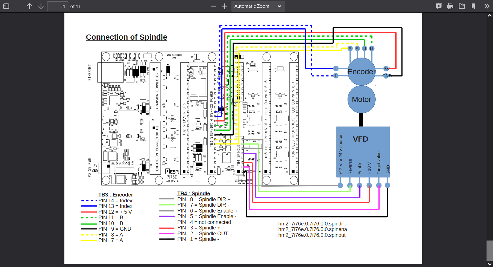

Looks like I will have a lot of video to shoot . I hooked up the spindle VFD and after fighting with some settings
the VFD will now work with the 7i76e board . I also got the spindle encoder electricly connected so I can see the
spindle rpm ( when it's physically connected to the spindle ). Now if I could just get the MPG wheels to work . LOL .

- my1987toyota
- Topic Author

13 Jun 2021 00:09 #211906
by my1987toyota
Replied by my1987toyota on topic My Grizzly G0602 Lathe
- my1987toyota
- Topic Author
- Posts: 719
- Thank you received: 280
13 Jun 2021 00:37 - 13 Jun 2021 02:57 #211907
by my1987toyota
The VFD is a TECO L510-101-H1-U
see pages 4-8 through 4-21 of the manual below
dealerselectric.com/images/Products/teco...nstructionmanual.pdf
the parameters I changed
original TB4 wiring
pin 8 to VFD com.
pin 7 to VFD S1
pin 6 to VFD com.
pin 5 to VFD S2.
modified TB4 wiring
pin 8 to VFD S2 ( forward/reverse )
pin 7 to VFD com.
pin 6 to VFD S1 ( run/stop )
pin 5 to VFD com.
I will do a video later on setting up my VFD
More info on the VFD ?
parameters
group 00:Basic parameters
00-00 option 1 (default is 0) control method
00-02 option 1 (default is 0) main run sourse
00-04 option 1 (default is 0) operations modes for externals
00-05 option 2 (default is 0) main freq. sourse
00-12 option 120 (default is 60) frequency upper limit ( so I can go 200 percent on RPM )
00-13 option 6 (default is 00) frequency lower limit
00-14 option 4.0 (default is 10) accel time 1
00-15 option 4.0 (default is 10) deccel time 1
Group 03 external digital input N output parameters
using a relay to control a device
03-11 option 2 (default is 0) setting frequency reached
Group 04 External Analog input N output parameters
04-11 option 2 (default is 0) analog output mode = output voltage
Group 11 Auxillary Parameters
11-01 option 16 (default is 5) carrier frequency KHz
11-02 option 0 (default is 1) carrier mode selection ( three Phase )
original TB4 wiring
pin 8 to VFD com.
pin 7 to VFD S1
pin 6 to VFD com.
pin 5 to VFD S2.
modified TB4 wiring
pin 7 to VFD com.
pin 5 to VFD com.
Last edit: 13 Jun 2021 02:57 by my1987toyota. Reason: adding information
