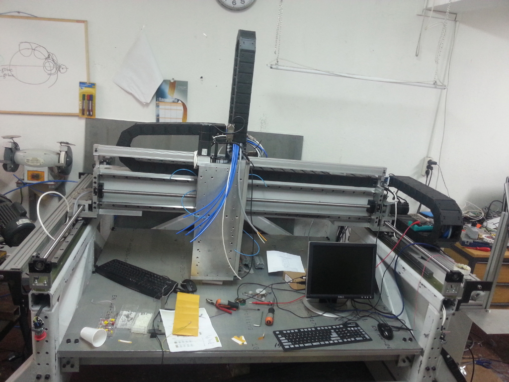

Hello everybody,
I just finished the mechanical construction of a 4 axis gantry.
I am using Mitsubishi MRJ2S-A servos, 5um linear glass scales on each axis(X,Y1,Y2,Z) and MESA boards: 5i25 , 7i76, 7i77, 7i85S.
My Y axis has dual drive. I initially tried position control and used the Y servos as master-slave(got the step signal from Y1 output and feed it to Y2; used the 5i25 and 7i76).
Now I added linear scales on each axis and want to use them in a closed loop. The servos have their own closed loop.
My dilemma is THIS: shell I use step control or speed control?
And my question is THIS: How should I configure pncconf to use 2 joints on Y axis and create a closed loop using the linear scales and the available MESA boards?
Any help is greatly appreciated. I looked everywhere for a similar setup with servos and linear scales but no luck.
Best regards

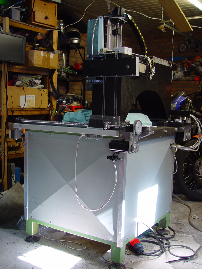

I am using servos for the X and Y1/Y2 axes (stepper on Z) on my gantry-style machine under construction using linear scales for position feedback. I just finished the mechanical install of the Y-axes scales but did not yet hook them up. X and Z scales are in place, hooked up and added to the positioning loop.
X axis is using a (SINO) 5um resolution scale, Y and Z axes are using (Ditron) 1um resolution scales. 5um does work, but is a bit coarse. 1um is much better for closing the loop.
I am running my servos in torque mode (because I had to, not because I wanted to), controlled using analog -10V ..+10V using a Mesa 7i77.
The Z-axis stepper is controlled in velocity mode using step/dir. If I had modern servo drives I could have used step/dir with the LinuxCNC/Mesa stepgen in velocity mode.
I toyed around with gantrykins, with the JA4 branch, and modified the homing code to keep the gantry square during the homing process.
But in the end I got tired of all the little issues that pop up using a not-entirely-trivial kinematics configuration and configured the machine as a regular 3-axis trivial kinematics machine. Both Y axes are slaved in HAL and I have a HAL signal available to create an offset between the two when desired.
Someday I might want to do something smart with finding the index pulses on the scales and setting the offset according to the findings. But constructing a CNC mill from the ground up takes a lot of time and there are 'nice to haves' and 'must haves'. Until now the gantry seems mechanically stable; without ballscrews attached and one side locked it takes 40N to push it 0,01mm out of square. So I moved the automatic-squaring to the 'nice to have, can do that later' list for now.
I did not use PnCConf to generate config files, but handcrafted them myself from the ground up. Setups using servos with scales in the feedback loop etcetera are not point 'n click material anyway.
If you want to have a look: here is my current configuration.
Fairly recent photo of the machine involved: here
Please keep in mind that this is still work in progress, not polished and not bugfree (gmoccapy toolchange window is not coming up, for example).

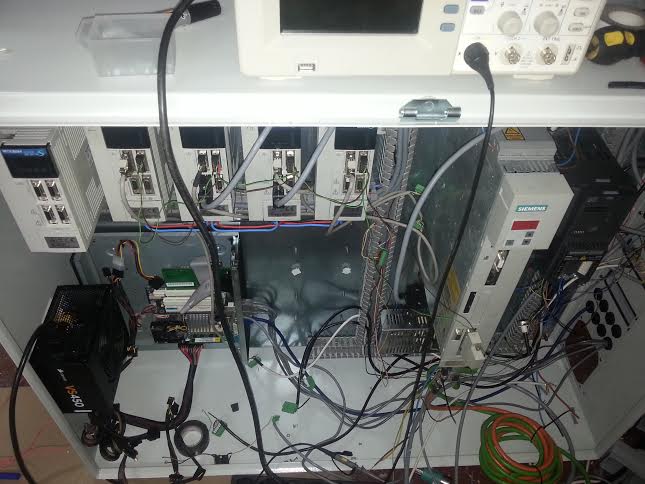

Mesa 5I25 PCI card on PC, 7I76 step/dir & 7I85S for encoders.
4x Delos 5um, RS422 encoders, without index(it seems) , max traveling speed 1m/sec.
The HAL and ini config files are in my above post.

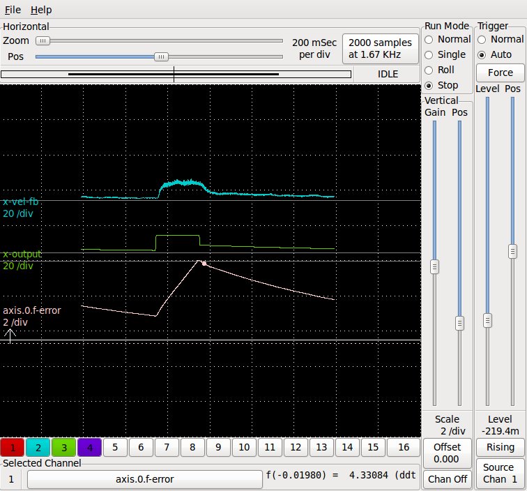

11 Jul 2014 13:52 #48650
by crisiacuf
Replied by crisiacuf on topic Step or velocity control for servo gantry
- DaBit
- Posts: 203
- Thank you received: 19
11 Jul 2014 15:12 - 11 Jul 2014 15:15 #48652
by DaBit
Replied by DaBit on topic Step or velocity control for servo gantry
ferror is rising linear, so I think there is a delay or a mismatch between linuxcnc speed en servo speed.
I think you should do some tuning effort. You can do that from within AXIS, pick 'calibration' from the menu.
- Tune the servo drives to the motors/load. See the manual on how to do that with your particular combination.
- You are commanding speed on your servos. Make STEPGEN_MAXACCEL/MAXVEL a lot higher or turn them completely off. You want maximum power from the servo to correct an error if it is needed and there is no such thing as a stepper stall here.
- Set MIN_FERROR and FERROR to large values such as 10mm so you have some headroom during tuning.

My "P" got unstable at around 4. I increased "I" till 200 with no success. It just became more unstable and oscillations increased.
You lost me here. What is pseudo hal?
Now if you could just tell me this. Why my displayed jog speed does not match my real axis speed.
I set the jog speed at 3000mm/min, I get no folowing error because I set it very high(50), but the real measured(with a tachometer) speed of my axis is below 600mm/min.
My max jitter was max 7000 so the hardware is out of the question.
I am suspecting there is a problem caused by the fact I have 2 PID loops.
One in my servo and one in linuxCNC and they fight each-other never reaching a target.
Do you think I should change to velocity control using 7i77?
