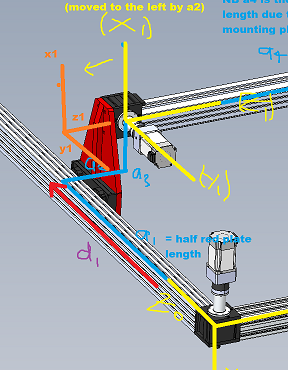

06 Nov 2019 05:04 #149690 by ross_dev
Hi Andy
The machine design as given to me is not completely orthogonal in all axes. For example, Joint 0 and Joint 1 look like the attached picture with an offset in the x, y and z axis. This means that the matrices for our machine will feature additional link offsets - the maths will look different to the maths in say the xyzbc-trt file because applying the Denavit Hartenberg convention results in additional offset parameters not found in the standard kinematics modules.
Perhaps I am misunderstanding - is it not usually the case that linuxcnc users build a 'standard' machine with orthogonal axes which match a given kinematics module, meaning that a standard module should work for those users?
At present I am calculating the transformation equations for our machine and intend to edit the xyzbc-trt file with the updated maths.
I cannot show the full machine unfortunately as this is a commercial application.
