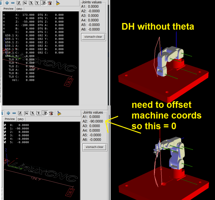

Hi!
I now have the DH params working well.
However as LinuxCNC does not see theta values I need to offset joint1 by 90 degrees at startup so that the robot posture is a true representation to the encoders or real word position/posture. I can't do G5* as internally the robot limits movement to -70/+90. I need to add 90 to the encoder value before it gets to joint.1.motor-pos-fb - is there some motor or other offset feature in the ini file I can use here?
Best practice for this?

15 Aug 2022 15:49 - 15 Aug 2022 15:53 #249824
by ftree
can i use this somehow with a fake encoder for sim?
Replied by ftree on topic robot joint offsets required to overcome internal absolute encoder
loadrt sum2 count=1
addf sum2.0 servo-thread
setp sum2.0.in0 90.0
net a2-enc-fb => sum2.0.in1
net a2-enc-fb-os <= sum2.0.out
Last edit: 15 Aug 2022 15:53 by ftree.

15 Aug 2022 17:01 #249826
Replied by andypugh on topic robot joint offsets required to overcome internal absolute encoder
I don't think that you need a fake encoder, just use the sum2 output where needed.

15 Aug 2022 17:46 - 15 Aug 2022 17:46 #249831
by ftree
setp a2-offset.offset 90
net a2-pos-cmd joint.1.motor-pos-cmd a2-offset.in
net a2-pos-cmd-comp a2-offset.out
net a2-pos-fb-comp a2-offset.fb-out joint.1.motor-pos-fb
# --- closedloop signals ---
net a1-pos-cmd joint.0.motor-pos-cmd => joint.0.motor-pos-fb
# net a2-pos-cmd joint.1.motor-pos-cmd => joint.1.motor-pos-fb
net a3-pos-cmd joint.2.motor-pos-cmd => joint.2.motor-pos-fb
net a4-pos-cmd joint.3.motor-pos-cmd => joint.3.motor-pos-fb
net a5-pos-cmd joint.4.motor-pos-cmd => joint.4.motor-pos-fb
net a6-pos-cmd joint.5.motor-pos-cmd => joint.5.motor-pos-fb
Last edit: 15 Aug 2022 17:46 by ftree.

15 Aug 2022 17:48 - 15 Aug 2022 17:51 #249832
by ftree
then join up a2-pos-fb-comp with gui?
net :j0 <= joint.0.pos-fb => pyvcp.joint0 => meca500gui.joint1
# fix me change to a2-pos-fb-comp ??
net :j1 <= joint.1.pos-fb => pyvcp.joint1 => meca500gui.joint2
net :j2 <= joint.2.pos-fb => pyvcp.joint2 => meca500gui.joint3
net :j3 <= joint.3.pos-fb => pyvcp.joint3 => meca500gui.joint4
net :j4 <= joint.4.pos-fb => pyvcp.joint4 => meca500gui.joint5
net :j5 <= joint.5.pos-fb => pyvcp.joint5 => meca500gui.joint6
#net :vismach-clear <= pyvcp.vismach-clear => vismach.plotclear
Sadly I don't understand the arrows too well here in this postgui. How can I link up a2-pos-fb-comp to :j1 else it picks up the non compensated value I think.
Last edit: 15 Aug 2022 17:51 by ftree.

15 Aug 2022 17:53 #249835
The arrows don't do anything, so don't worry about them.
I am not sure about using colons in the signal names.
You don't seem to have the actual encoder feedback anywhere in the nets.

15 Aug 2022 17:54 #249836
by ftree
this error out and shuts down
net :j1 <= a2-pos-fb-comp => pyvcp.joint1 => meca500gui.joint2

15 Aug 2022 17:55 #249837
by ftree
hi andy, i'm trying to set this up in sim mode. maybe going about it all wrong way.

15 Aug 2022 17:58 #249839
by ftree
kinematics fail using offset, back to the drawing board

15 Aug 2022 18:11 - 15 Aug 2022 20:25 #249840
by ftree
We need a way to add back into the system the "theta" values for following so the robot poses correctly in sim and kinematics work correctly.
theta j1= neg 90
theta j5 = pos 180
I am open to guidance on how to achieve this in both sim and real. Thanks!
