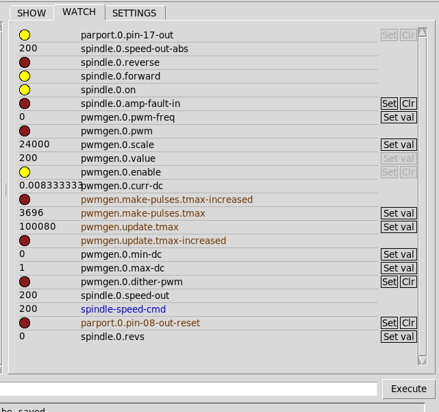

Hi all, Im starting to transition from mach3 to linuxcnc on my hobby machine. Im having troubles at seting up the PWM to VFD corectly.
I added the folowing to the custom.hal
# --- Load the PWM generator component ---
loadrt pwmgen output_type=1
# --- Add the PWM generator functions to the servo-thread for smooth updates ---
addf pwmgen.update servo-thread
addf pwmgen.make-pulses base-thread
# --- Spindle ON/OFF control (Relay on Pin 17 thats on my breakoutboard and works nicely) ---
# Connect the signal from the 'spindle.0' component to the physical pin.
net spindle-enable <= spindle.0.on
net spindle-enable => parport.0.pin-17-out
# --- Spindle Speed PWM signal (Speed on Pin 1) ---
net spindle-speed-cmd spindle.0.speed-out => pwmgen.0.value
# Enable the PWM generator ONLY when the spindle is supposed to be on (M3)
net spindle-enable => pwmgen.0.enable
# Connect the pwmgen output to the physical parallel port pin 1 - this sends the 0-10v pwm from breakoutboard to vfd, also needed inverting
net spindle-pwm-signal pwmgen.0.pwm => parport.0.pin-01-out
setp parport.0.pin-01-out-invert 1
# Tell the PWM generator that the max value (100% duty) equals the scale from the INI file
setp pwmgen.0.scale 24000

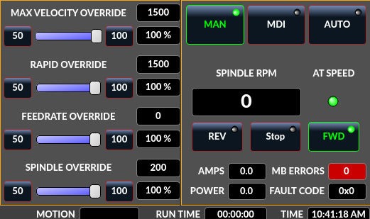

My problem now is, in linuxcnc the maximum rpm it lets me at 100% is 200.
but it doesnt even reac that..my pwmgen.0.value is 200 in halshow. (added a picture).
output pin is corect, i get 10V if i dont invert the pin and vely low V when i do invert it.
i am confused as to how or why max i get is 200? same with speed-out wich is the one setting the .value
What am i doing wrong?
