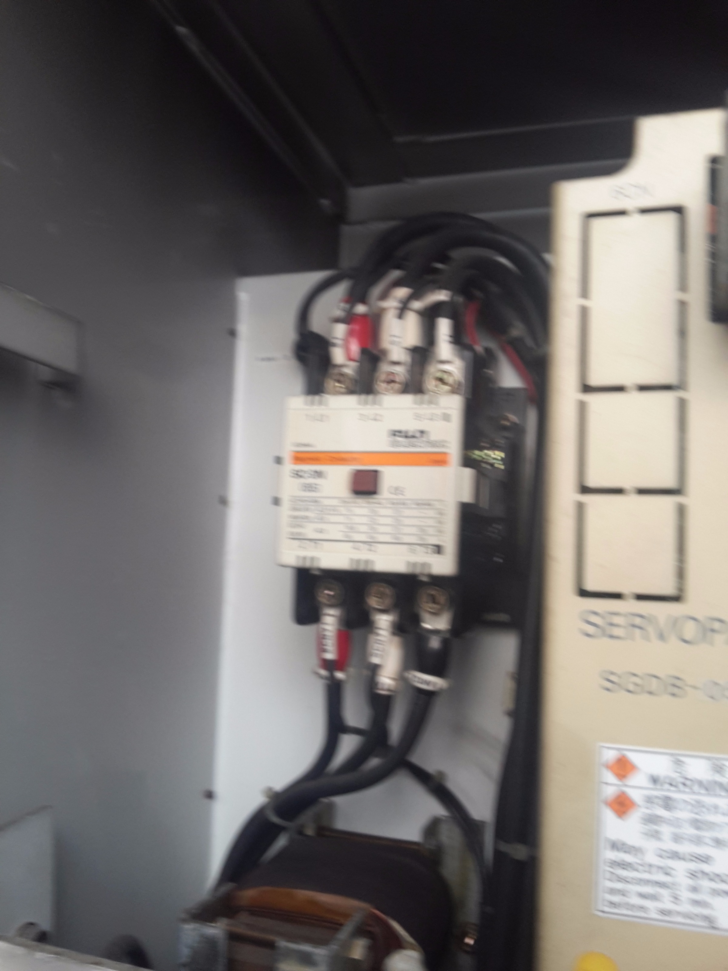

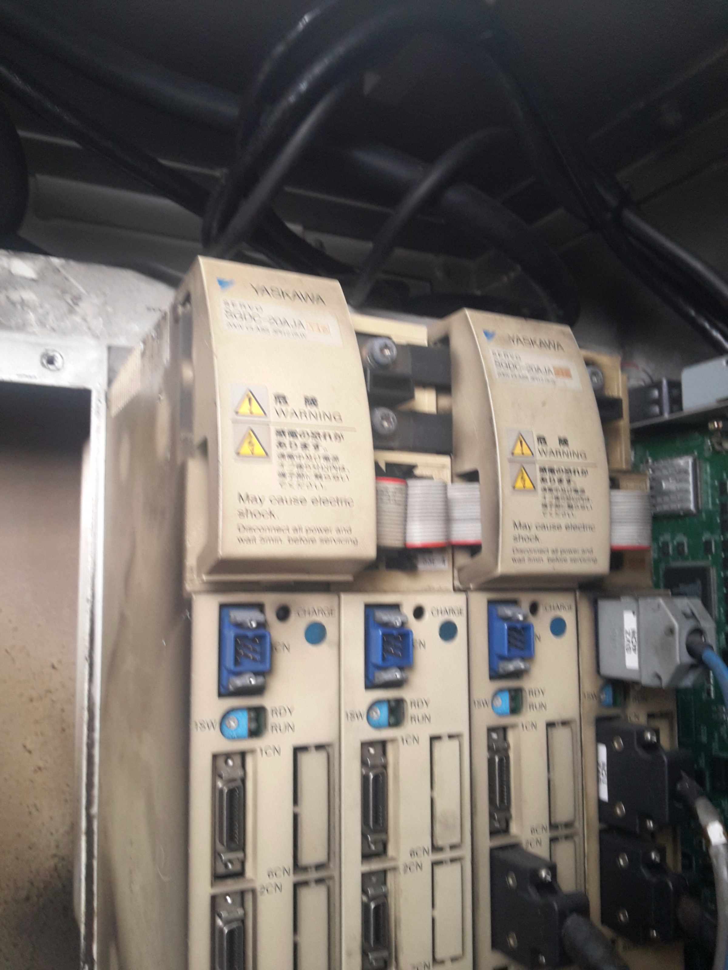

07 Jun 2017 11:22 #94219
Replied by andypugh on topic sugino V15 retrofit feasibility
I think this is the drive manual.
www.yaskawa.com/delegate/getAttachment?d...Name=SIE-S800-22.pdf
It appears that the drives use analogue voltage control in speed or torque mode, so should be a relatively easy retrofit as long as the drives work.
