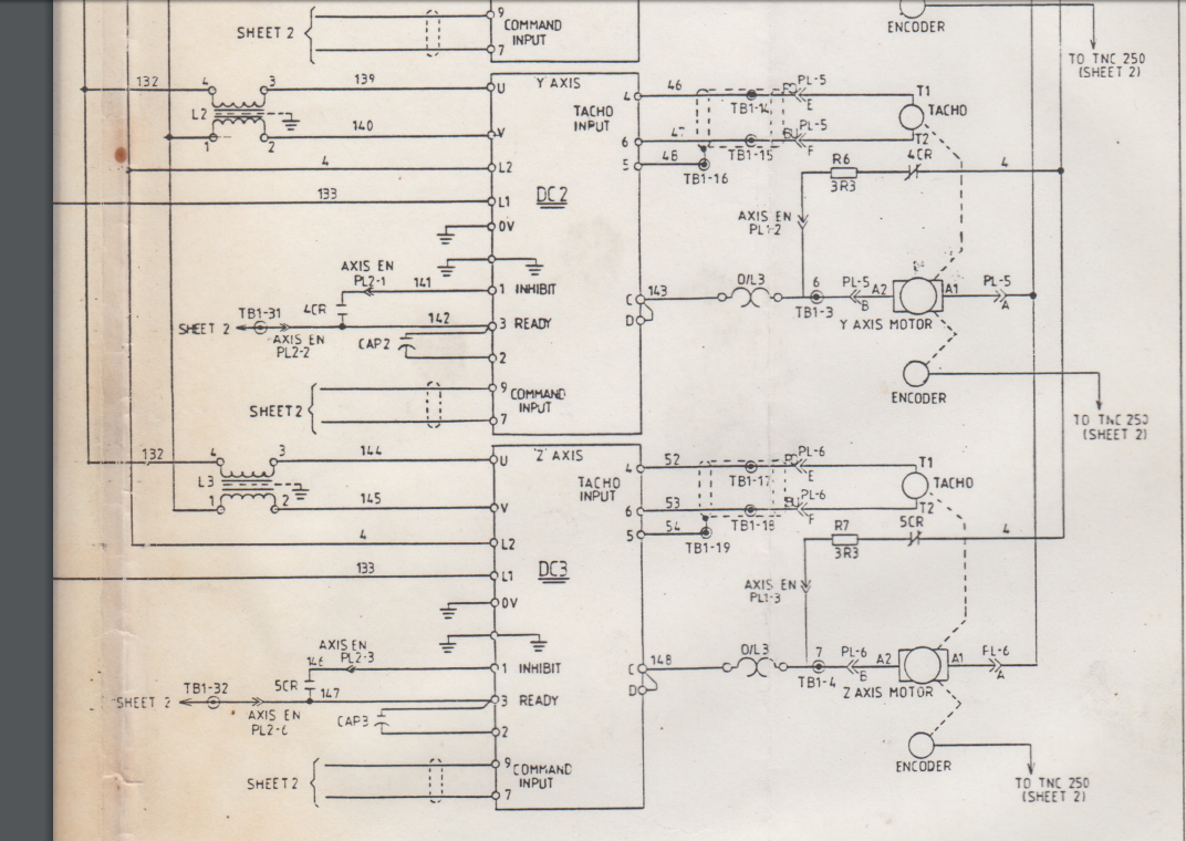

So I got the machine home a couple weeks ago, and have played a little around with it this week. Most of the documentation was in pretty rough shape, so took the time to scan everything.
As I expected, when powering on the machine, all it did was spit out parameter errors, and when navigating to the parameter list, everything was at 0.
Any way. I am not sure I have all the electrical diagrams. The ones I have seem to refer to different pages than included (properly a complete diagram folder)
(small cut from the whole A3 page only showing Y and Z)
From what I see, there is no revolvers, but there is a tachometer on each axis (For velocity measuring?) What is its purpose? Could a axis be complete in Linuxcnc without it?
I have downloaded some technical documents from Heidenheins website, which I hope to get an idea of pinouts from. But I would still very much like your opinion on what options to take.
If you need more information, or would like all the electrical diagrams i have, please tell me.
Thank you for your help!
27 Dec 2018 09:51 #122947 by andypugh
Replied by andypugh on topic Advice on Old mill retrofit? + tool type
Tachometers are used to close the velocity loop.
Basically your command voltage has the tachometer voltage subtracted from it and the resulting voltage is amplified and sent to the drive.
High command voltage and low velocity => high motor voltage
Motor at-speed => low to zero motor voltage
Low command and high speed => negative motor voltage to slow it down.
You would leave the tachos connected to the drive to close the velocity loop and then use the encoders and LinuxCNC to close the position loop, outputting velocity commands from LinuxCNC.

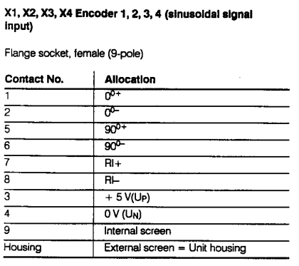

Done some digging in the electrical cabinet, and believe I was able to trace most of the connections I would need to connect with the servo drives from a 7i77, using the documentation of 7i77 and the official heidenhein manual.
Next would be understanding how the encoders are connected.
From what I can see in the schematics, the spindle encoder is a "traditional" encoder as I know them, with outputs A, A-, B, B- and a +5V and 0V connections.
But the encoders on X Y Z seem different
(Cut from the heidenhein technical manual)
How does this compare to the classic A B + -?
Another thing, could you tell me if this isn't right.
7i77 Encoder terminals
QA0 = A+
/QA0 = A-
GND
QB0 = B+
/QB0 = B-
+5V
Sorry if I ask too many questions, or seem ignorant to the task. I just really like to tinker with these machines, and want to learn more about them, in the process of getting them up and running.
  • Todd Zuercher
  • Todd Zuercher's Avatar
  • Away
  • Platinum Member
  • Platinum Member
28 Dec 2018 19:54 #123032 by Todd Zuercher
Replied by Todd Zuercher on topic Advice on Old mill retrofit? + tool type
Are those encoders or glass scales? Looks like that chart is describing interpolated scales, and you need an EXE box to convert that to quadrature signals. You may already have them (or it could have been built into the old control.)
