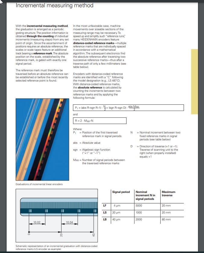

So the next step now is to find out how we can home the machine using these index signals. It looks to me that the the standard homeing sequences of LinuxCNC are not suited to home glasscales like the LS403C. Any help / suggestions are greatly appreciated.
It would probably be easier to do if you were not using quadrature. (ie, if the absolute position could be sent via serial)
Are the two pulses on the same or different channels?

14 Apr 2021 11:50 #205880 by mwinterm
Replied by mwinterm on topic Retrofitting Mikron WF41C
@gaston48: Thank you very much for sharing the Heidenhain document with the formula. Would have saved me from figuring it out
myself but nice to see that my calculation was correct :-)
@andypugh: What you are proposing is the very same I also had in mind (see my old post here: forum.linuxcnc.org/27-driver-boards/4060...rial?start=10#203443). I also already tested it with a little hacked together Python hal-component (I know not really real-time suited, but good enough for what I wanted to try out). I could easily implement this as well in a C++ hal-component. The only thing I'm unclear about is how to do as you stated
and adds that value to the position fed back to the system
I also looked a little more into the LinuxCNC homing source code and it does not look so complicated anymore as I thought initially. So adding there something like a distance-encoded-index option could to my understanding also be feasible.
