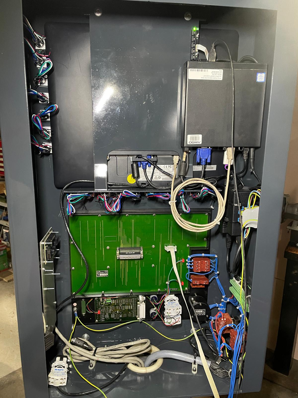

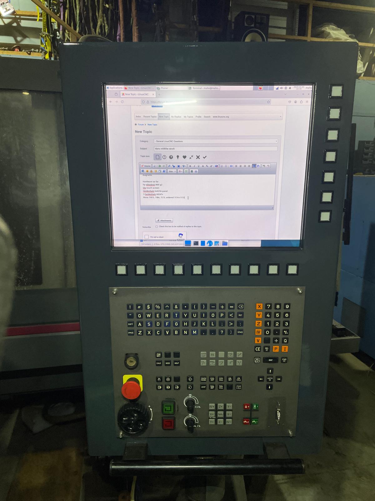

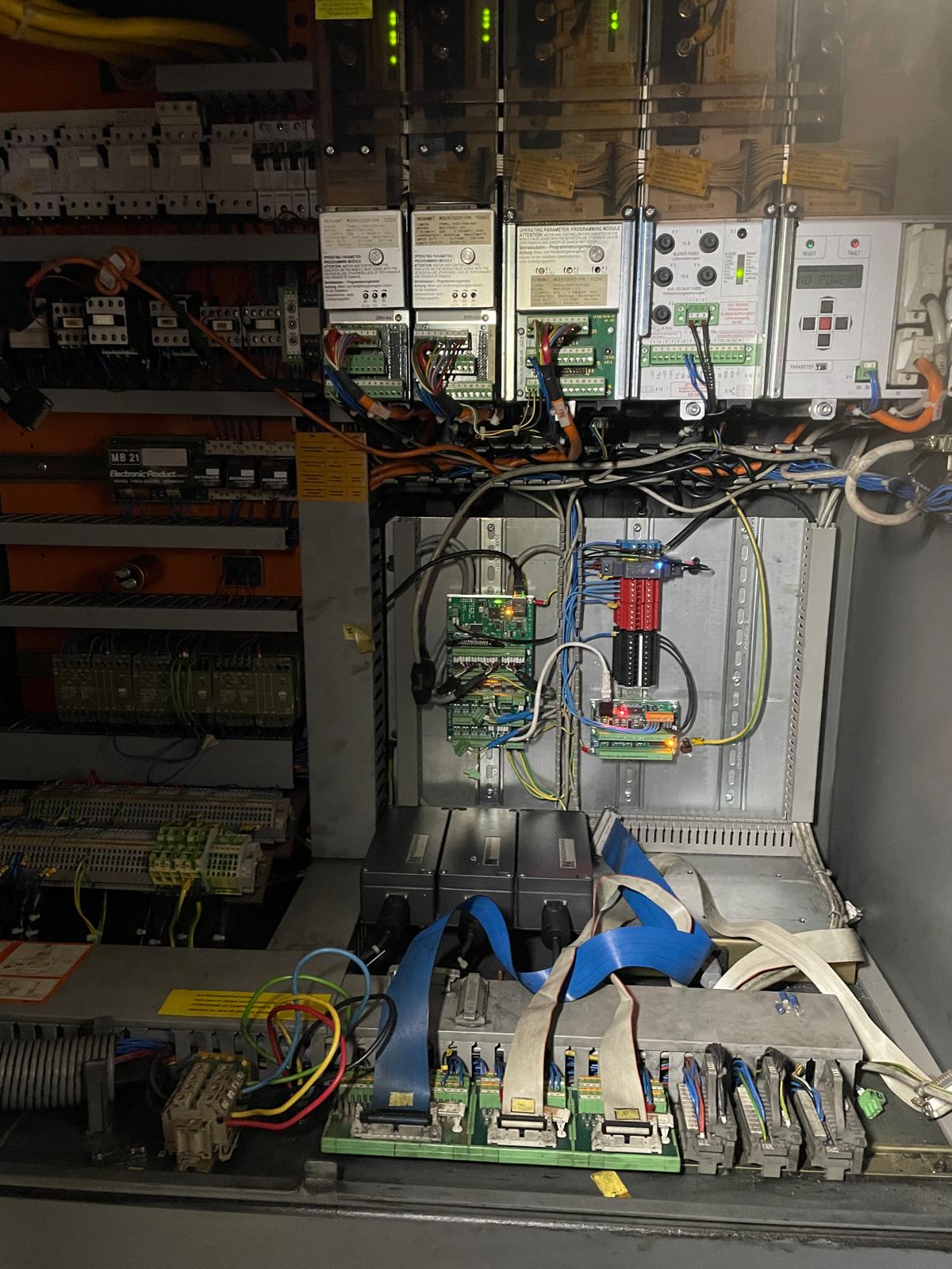

11 months 3 weeks ago #338075
by djdock99
Replied by djdock99 on topic Maho mh800w retrofit
It’s been 9months since I got near this project. But back at it again.
I’ve been working my way through pnc config and inputting all the axis info from the manuals and finally starting to wire up the mesa boards.
Big thanks to the feral engineer on YouTube with his Linux cnc bare bones series as this helped me understand what data needs to go where..
Linear scales are now connected up and reading in the correct directions.
I have finally decided on what way to wire each axis and name each axis. I’m sticking to the original Maho horizontal spindle configuration with the y axis moving the table up and down. This way in the future trouble shooting in the future will be less confusing as everything will match the original manuals.
Once if got as far as I can with pnc configuration I’ll make a second configuration for the vertical spindle which I will use the most.

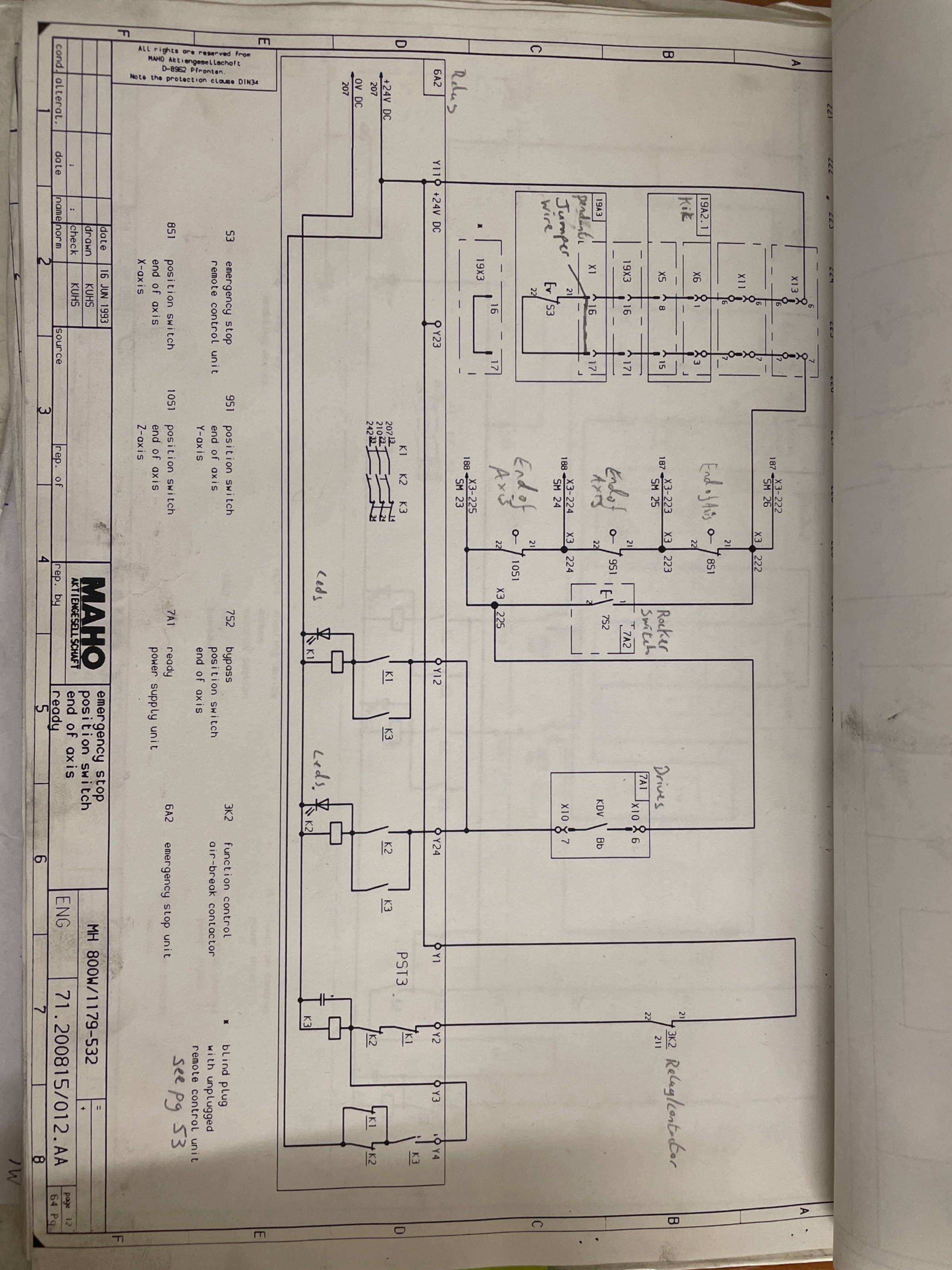

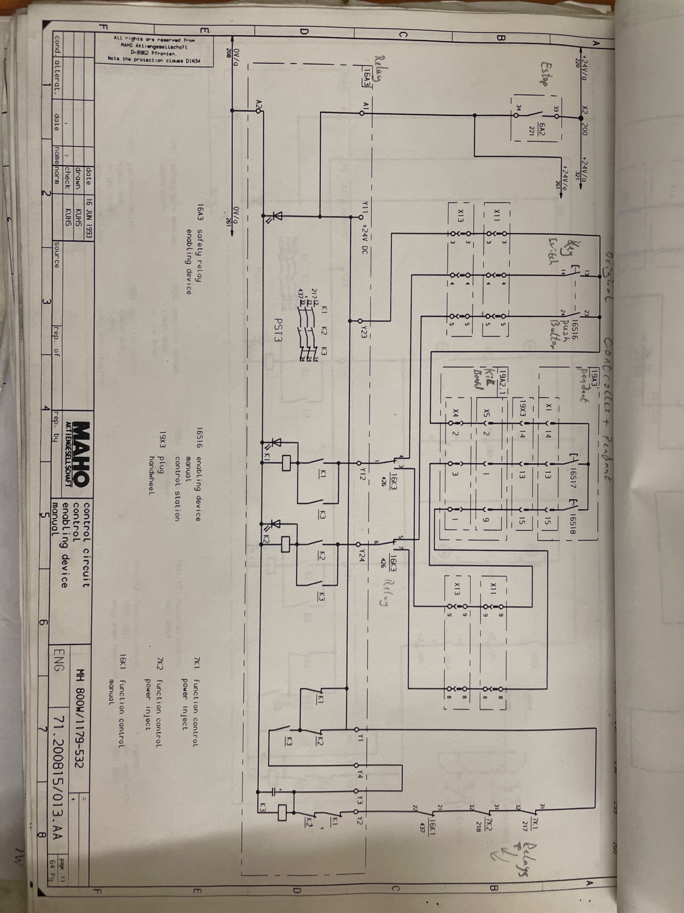

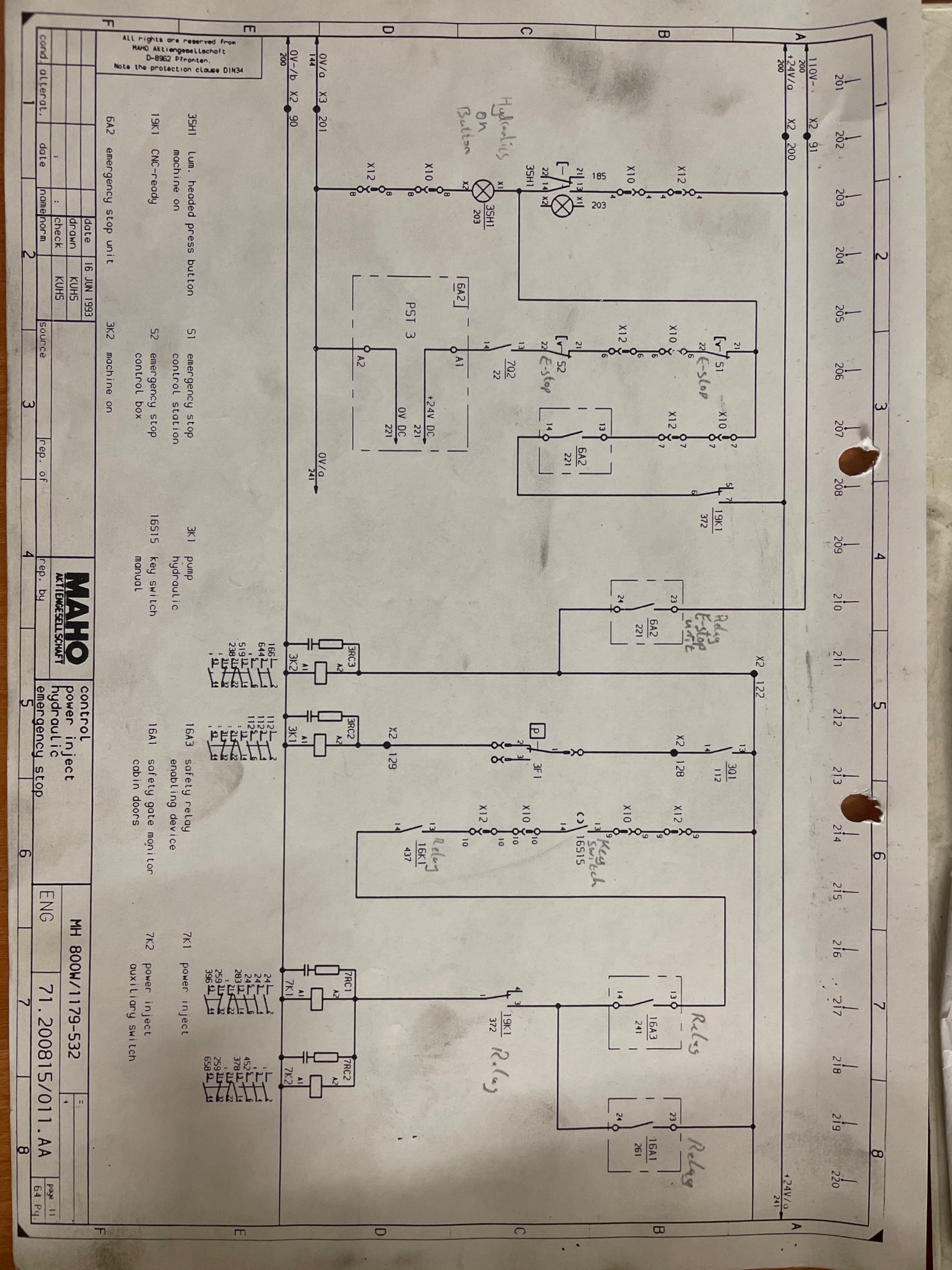

11 months 2 weeks ago #338327
by djdock99

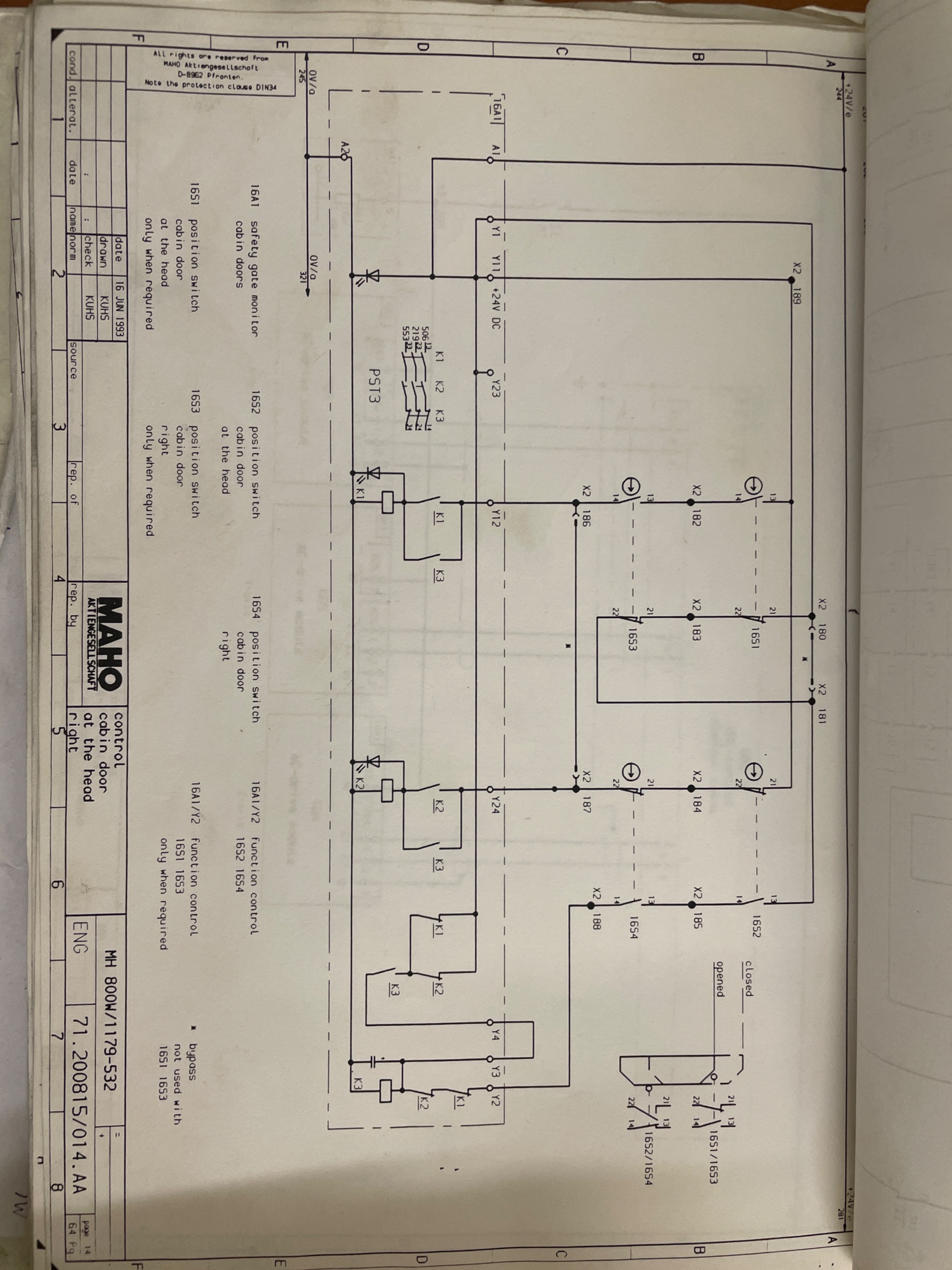

Been trying to get the estop and machine on circuits working properly today with help from marks mh400e information which he kindly sent to me.
just wondering if the older mahos have the same estop chains and components?

Help me please????I have spent 3 days trying to get linuxcnc to power on the Maho with no success.Where i am at. With linuxcnc open and the machine released from estop i can manually latch relay 19k1 by holding on the contactor with a screw driver. When i do this the whole machine powers up and everything is working perfectly. the drives are enabled the linear scales are reading correctly. the door open closed switches are all working correctly but the x and z servos are rotating slowly but smoothly. Then when i update the hal file to electronically latch 19k1 with f2 it will not hold and drops relays straight away.

inputs and outputs
8 months 3 weeks ago #342613
I would bet it shows "joint.n.following-error" as noted on my second reply.
You are working on a complicated machine, so it is imperative to follow instructions strictly and as listed in priority.
See this for wiring and testing:
forum.linuxcnc.org/10-advanced-configura...to-example-mesa-7i77
And for network and WiFi to work at the same time, see here
forum.linuxcnc.org/27-driver-boards/3559...ethernet-mesa-boards
Replied by tommylight on topic Maho mh800w retrofit
Never smart to do that to machines..... i can manually latch relay 19k1 by holding on the contactor with a screw driver.
This means that LinuxCNC has no control over the servo drives, usually incorrect or missing wiring, like are the encoders wired to Mesa and do they work correctly counting up/down on the LinuxCNC DRO ?.... but the x and z servos are rotating slowly but smoothly.
What error does LinuxCNC show when that happens?Then when i update the hal file to electronically latch 19k1 with f2 it will not hold and drops relays straight away.
