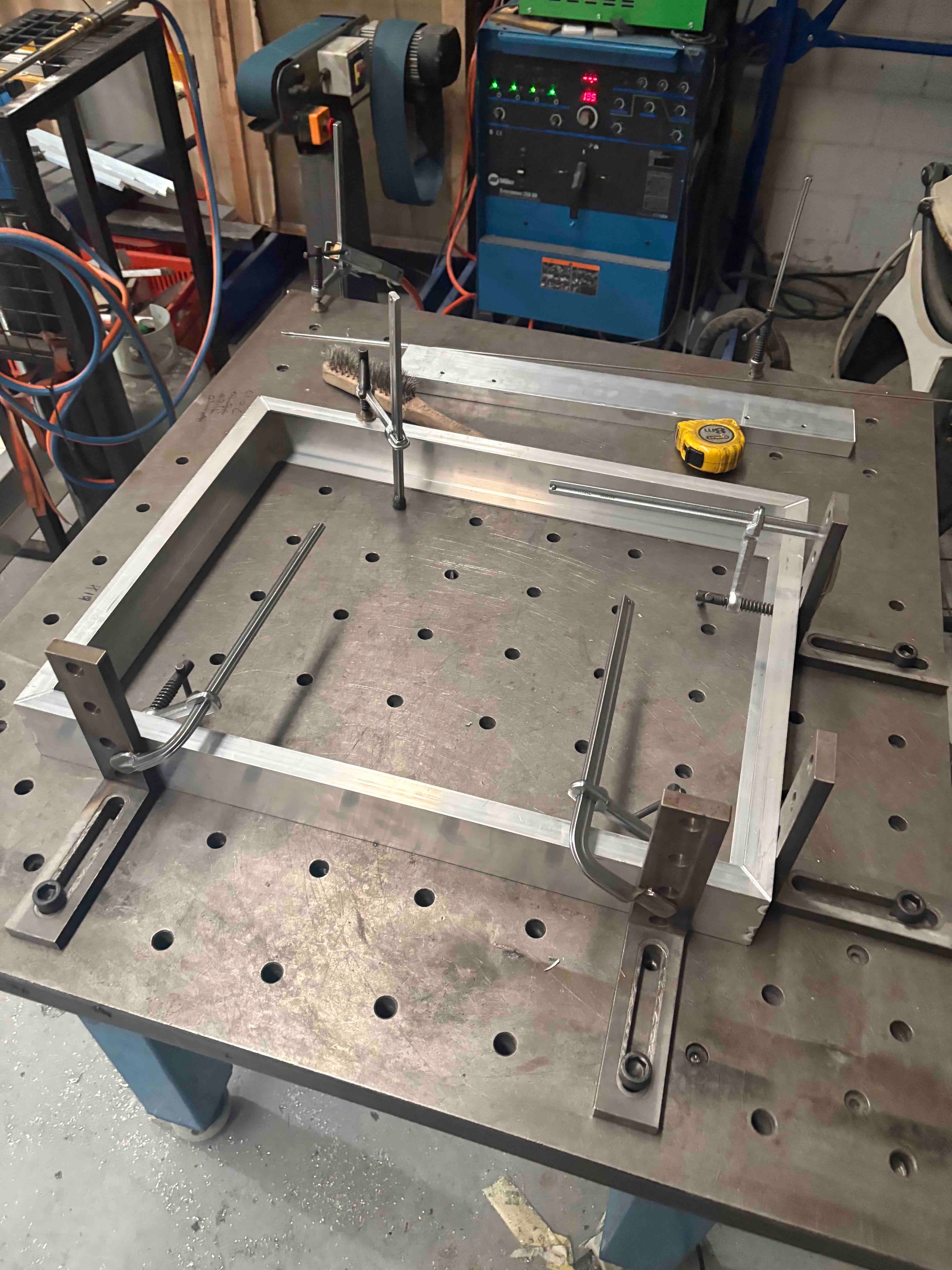

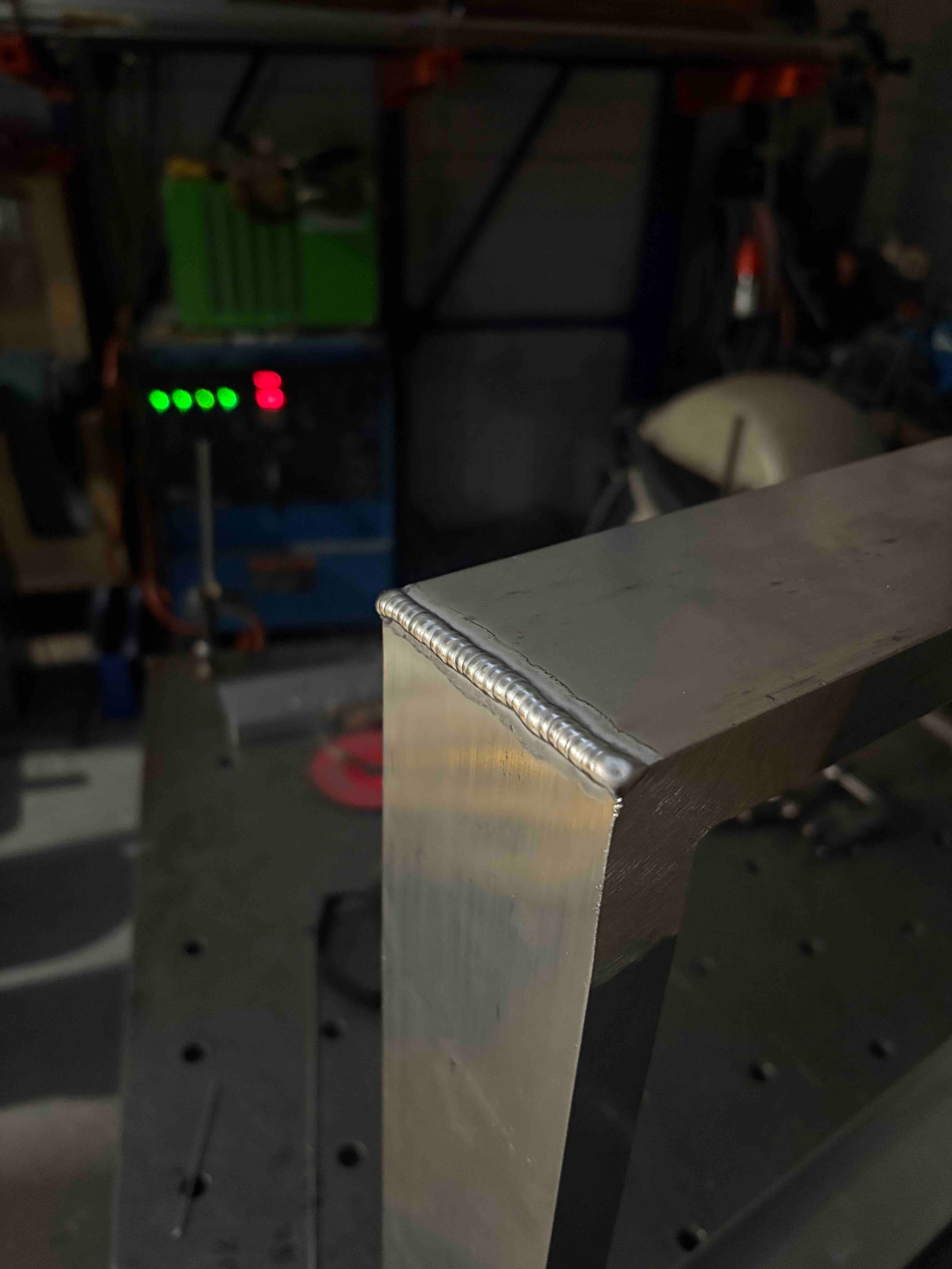

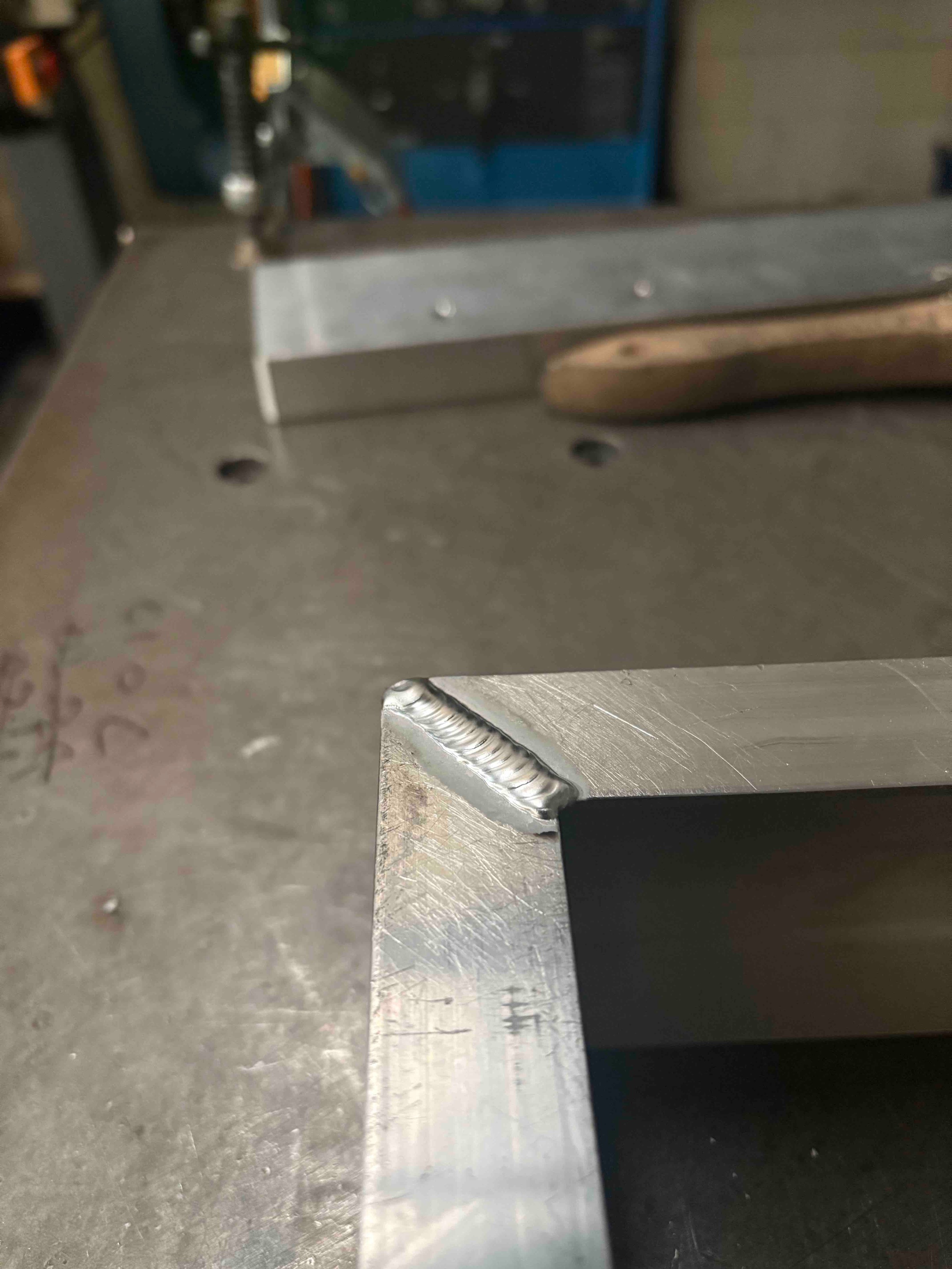

Nice welds on your control panel.

Cheers Mark.
I don't get to do as much ally as I'd like.

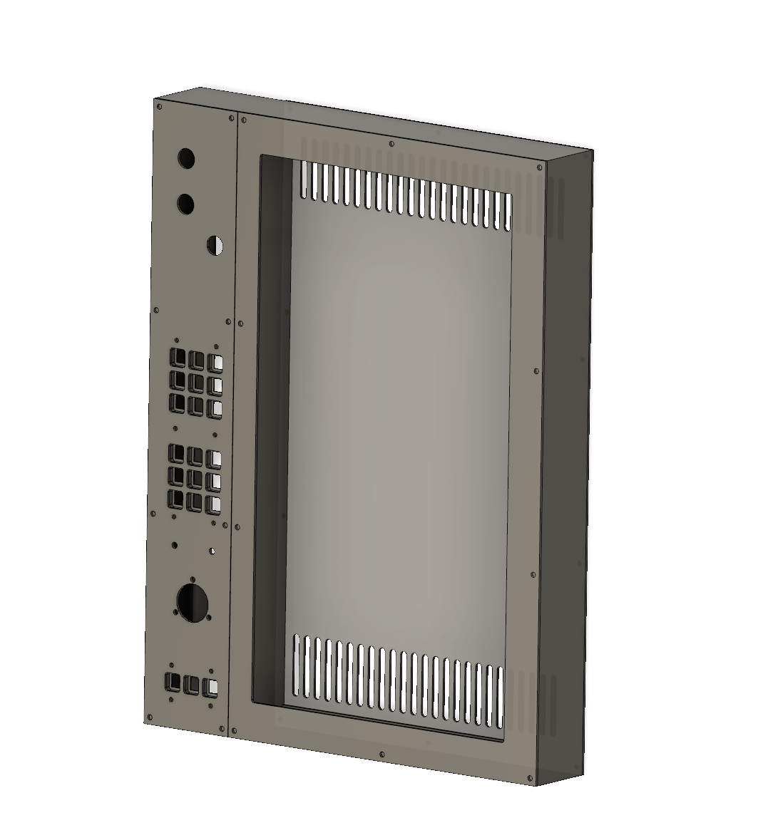

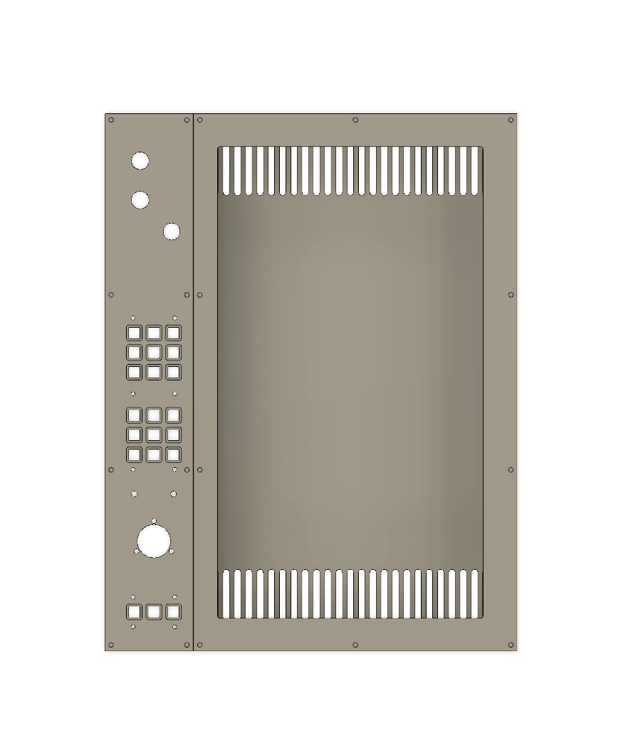

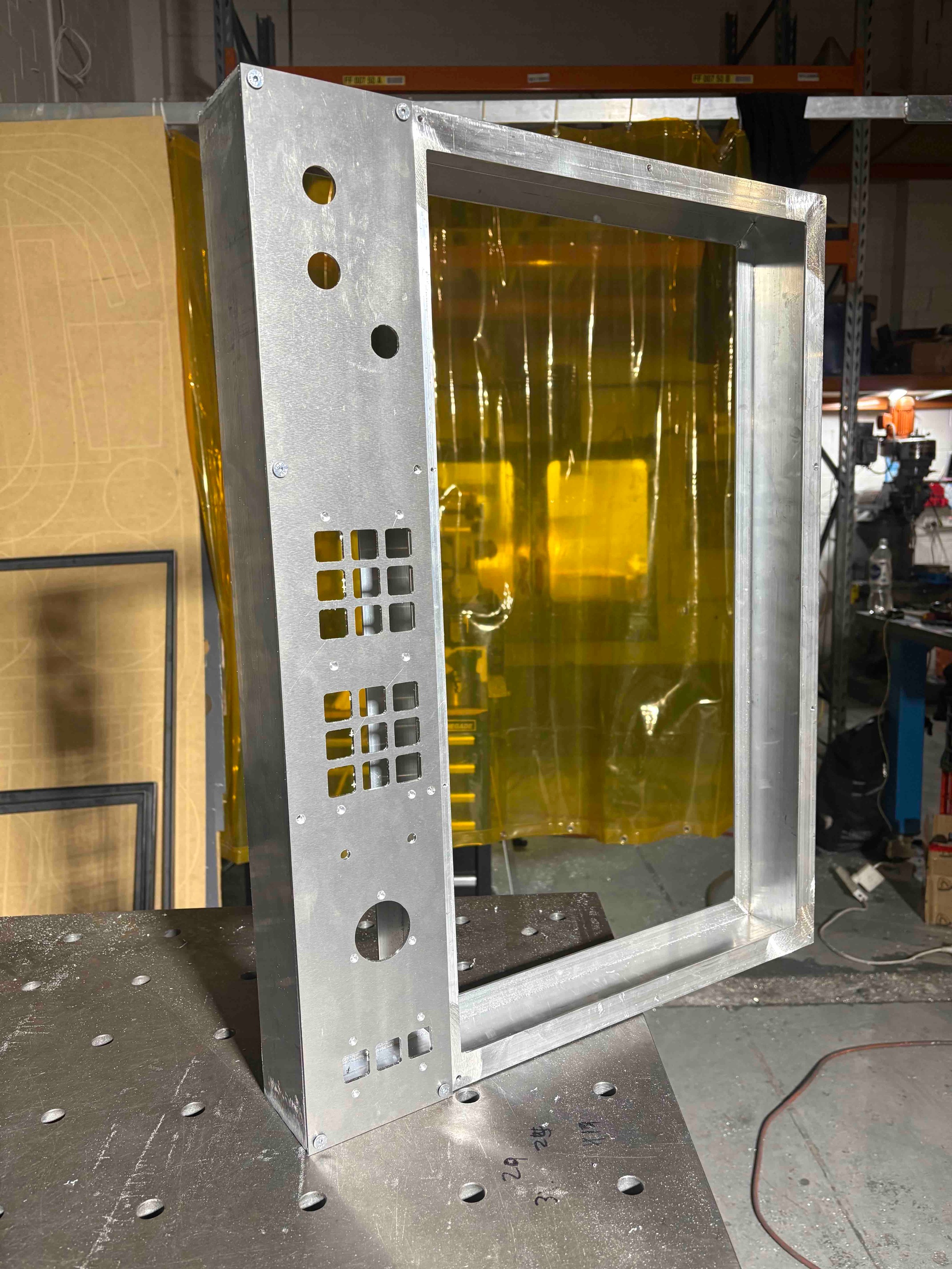

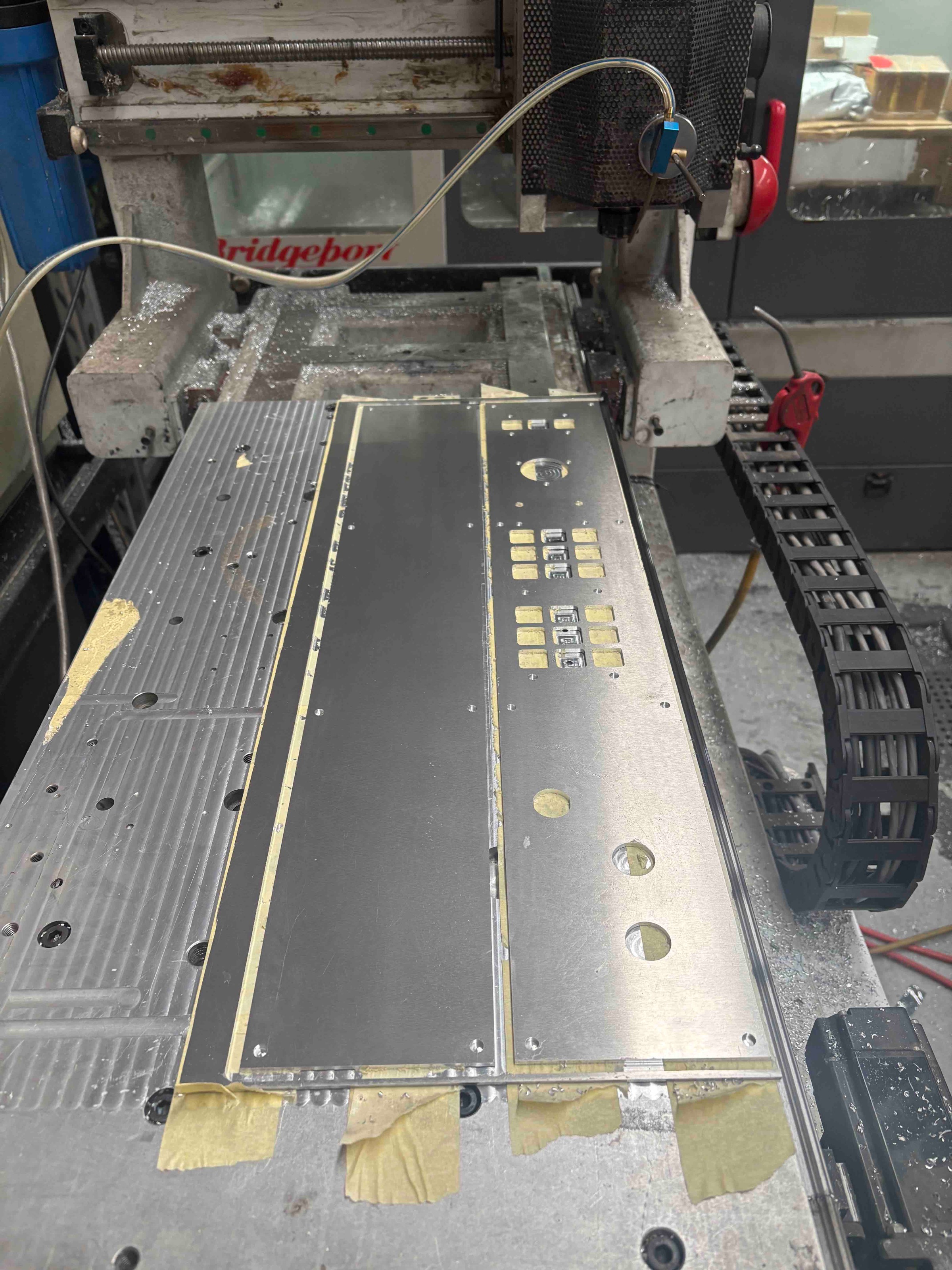

Bit of a progress update from the last couple weeks:
Control panel is at the powder coaters. I choose a dark matt charcoal. Mainly as my coater runs this Dulux colour often and Im impatient at the best of times! Should have this back on Tuesday.

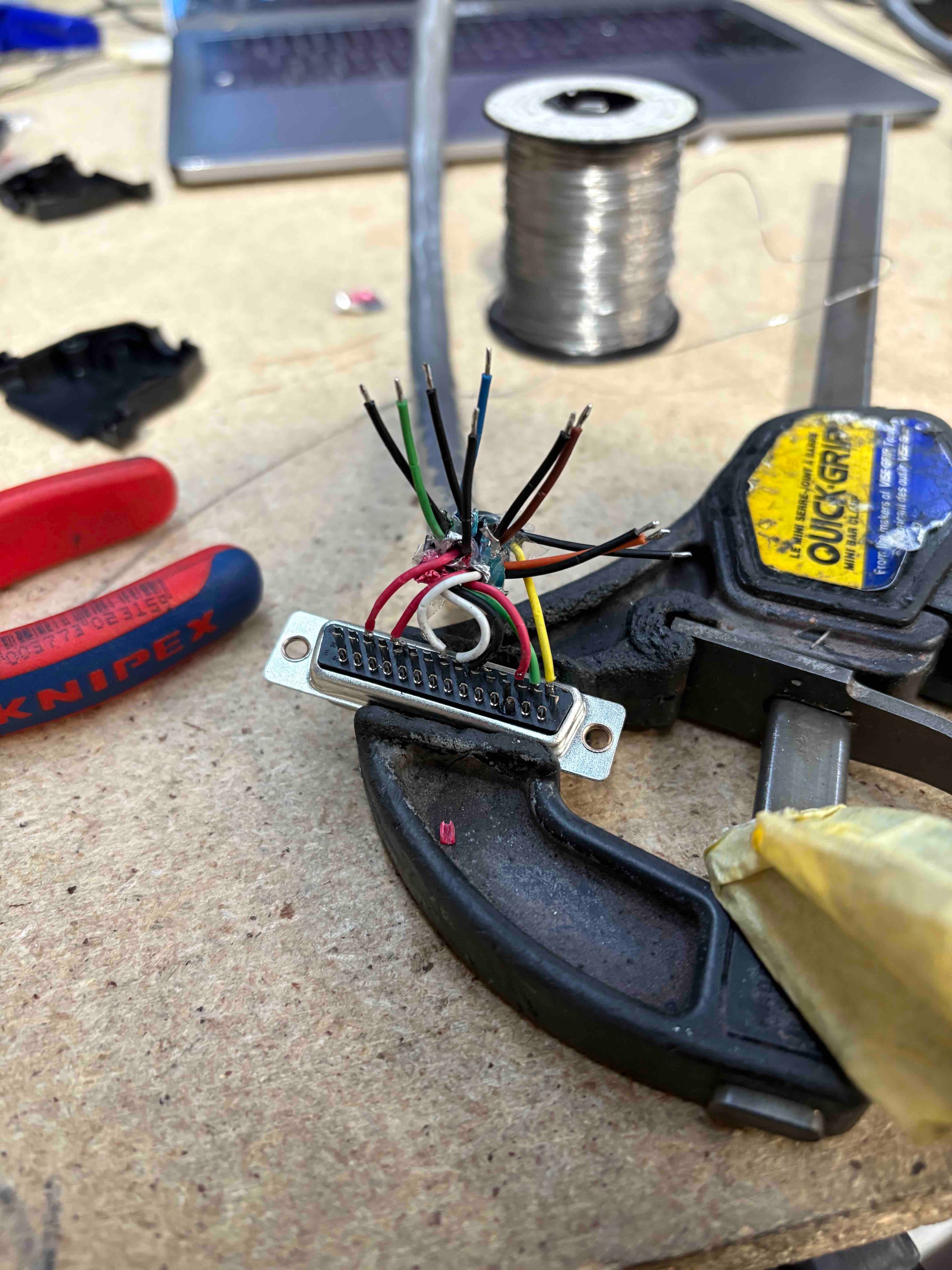

The custom control panel buttons are now 3d printed, along with the MX switch carriers. All wired up. These run into a DB25 breakout board and then will travel back the Mesa cards in the cabinet. I appreciate this isn't the nicest way to execute it, but I only require the 7i97t and 7i84u for all IO, and most IO terminates in the cabinet. I got cold feet on flashing the 7i97.... Pics below.
PC has been setup with linuxcnc. I chose a Coofun CK41 miniPC, which The Feral Engineer made some tests on YouTube with seemingly good results. Fingers crossed it works out. It's very compact and so was the price tag. Took me a few nights to get MesaCT and an updated Mesaflash running correctly to recognise the 7i97T. This is honestly due to my lack of unix (or IT in general!) skills. We got there in the end - I'm now able to run a draft linuxcnc config and toggle a coolant assigned output on the 7i97t with no dramas. I'll take that as a win. Yet to hook up the 7i84u.
Have to thank JT for the great MesaCT package!
I was and still am very daunted by the task of editing lines in the Hal/ini files.
The servo drives are currently on their way from China. I went with Leadshine EL7 drives in the end. The price was decent and they're offered in 380-400v 3ph. Opted for analog/pulse control as these control methods appear to be well documented here, especially by Tommylight's guide. Ethercat looked appealing, but given my lack of IT skills I thought it safe to stick with the aforementioned.
This weekend I started drafting the wiring diagrams between the Mesa boards, original Bridgeport control/distrubution board and new servo drives. The free schematic cad on DigiKey.com ist great btw! Would recommend.

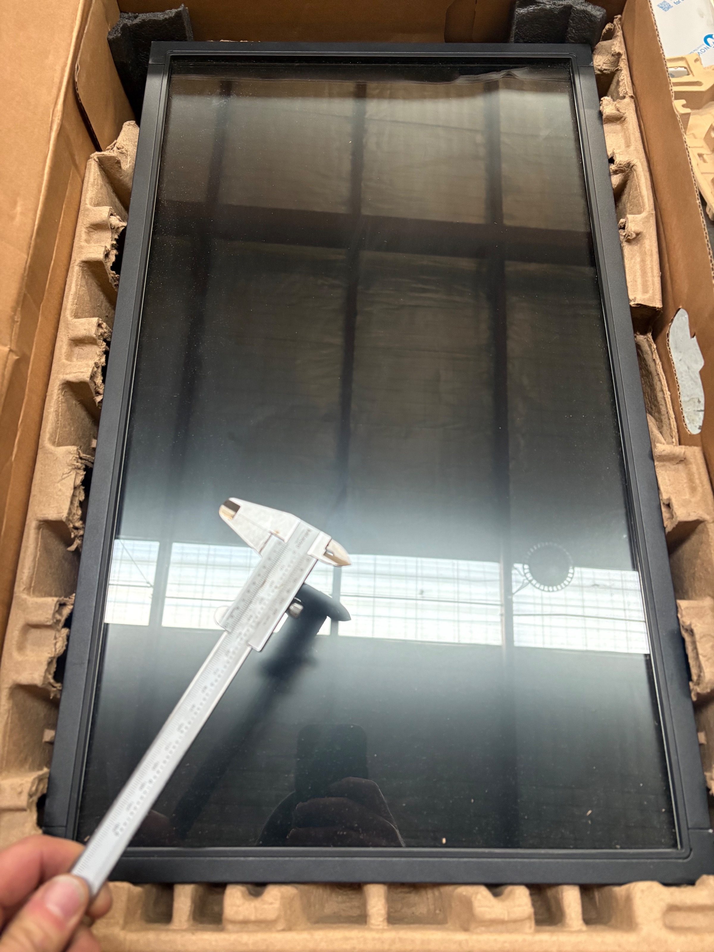

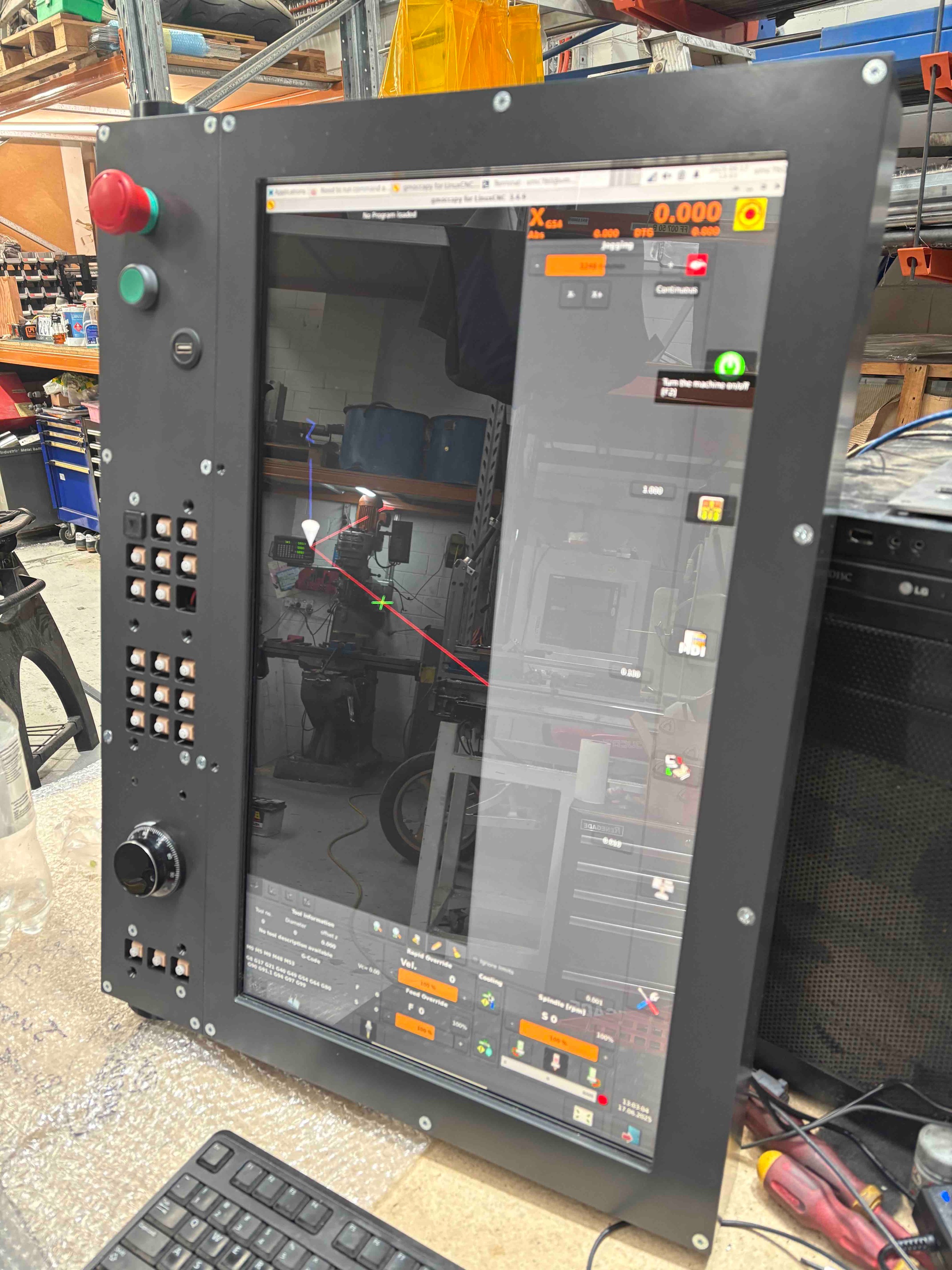

Little bit of progress. Got the control panel assembled with touchscreen and computer. It's definitely not a small screen....

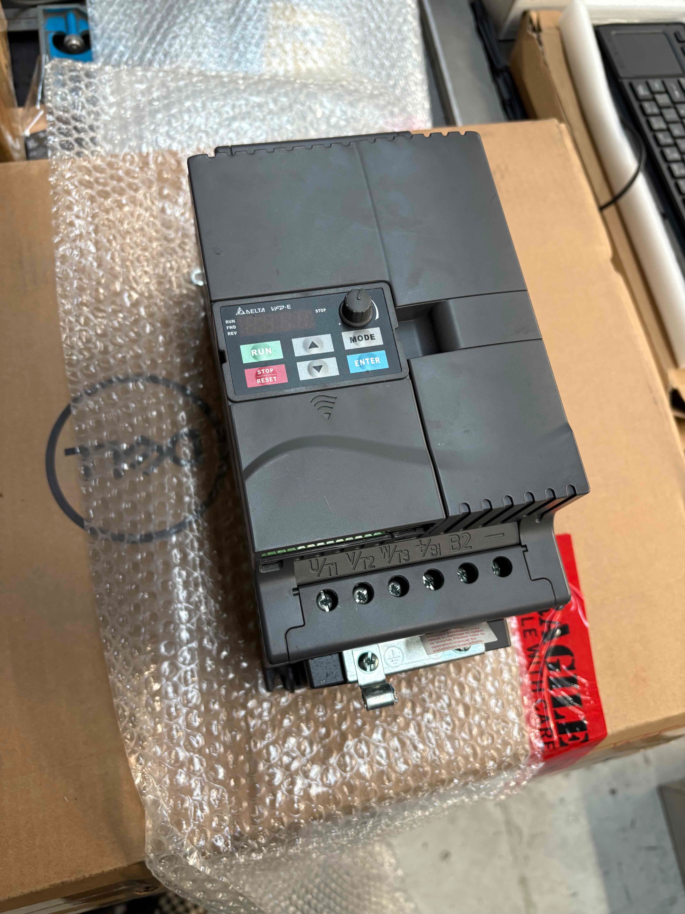

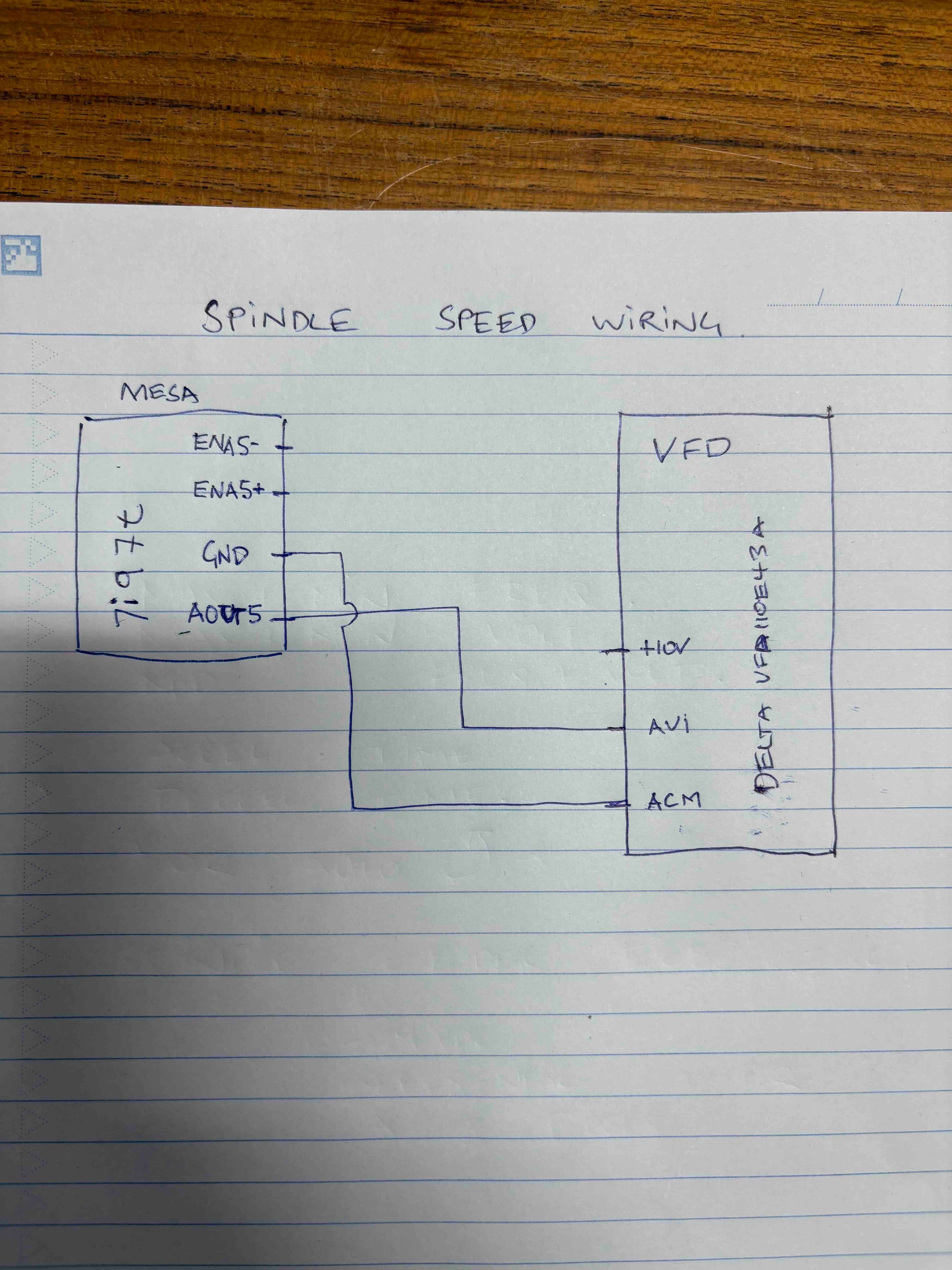

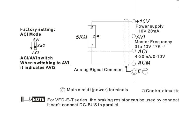

I just wanted to check VFD speed control wiring. The Delta data sheet only shows external speed control using a potentiometer. Can I wire it like below, using the axis 4 or 5 on the 7i97t to control it?
I'll activate the FWD/STOP, REV/STOP and OUTPUT SHUTDOWN via outputs on the 7i97t.
Thanks!
