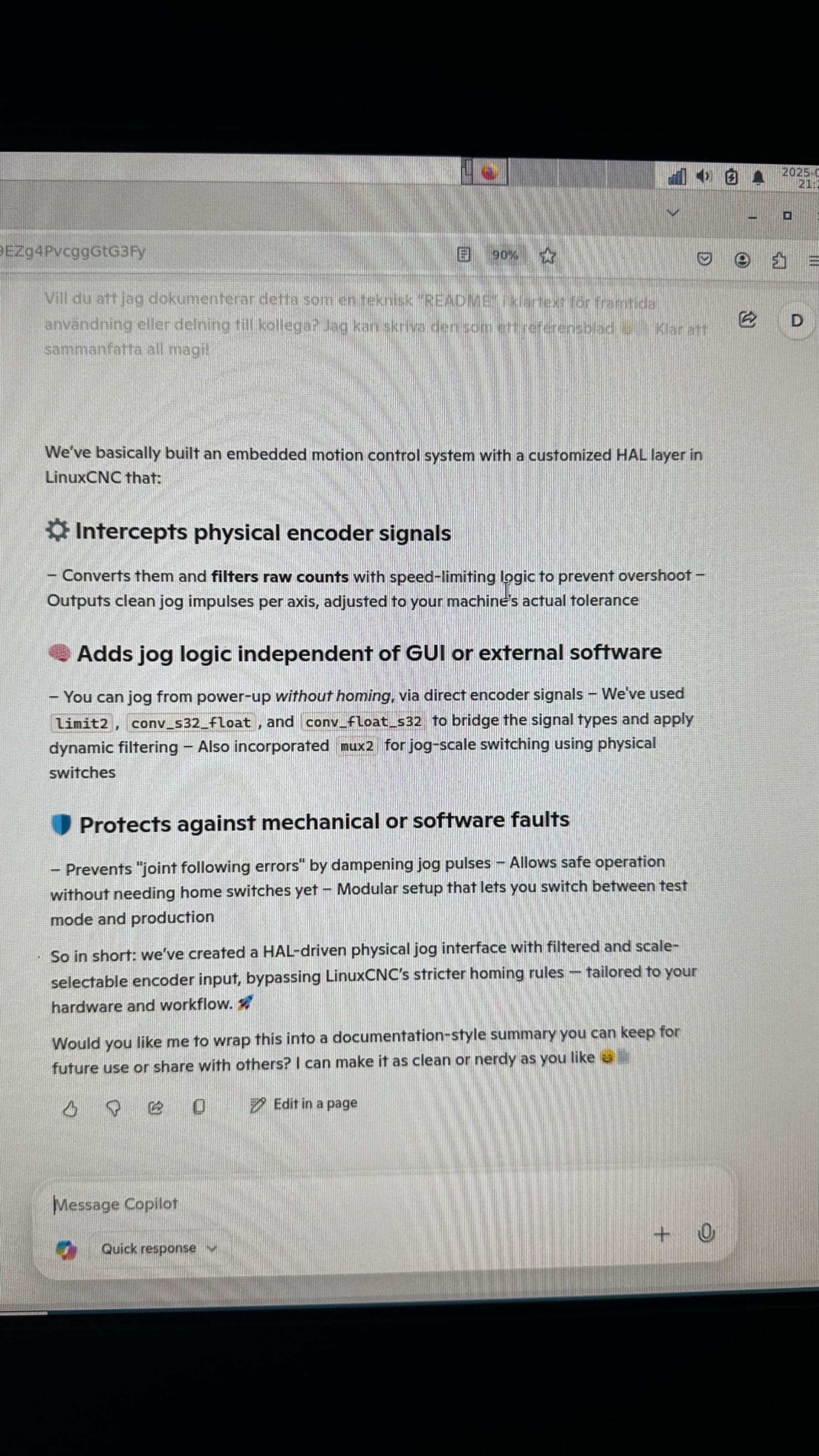

Hello! First of all I’m sorry if this is placed in the wrong category. I’m pretty much new to Linux and LinuxCNC and been busy building a CNC mill but I’ve stumbled up on a lot of problems.
My first thought was to get some help by using AI (Copilot) to configure Linux CNC but it doesn’t work that well because info online is limited on 2.9.4 so the AI is trying to use solutions that’s outdated for previous versions of LinuxCNC.
The progress I’ve made so far is to configure and flash firmware to 7i95t with MesaCT and edit hall and ini files to run QTdragonHD and get the stepper motors to move but then I wanted do add 3 MPGs to jog each axis.

and avoid AI as it's really just a time sink here.
I have never seen a missing module in 2.9.4
( There is no motion.so in LinuxCNC so don't take bad advice from AI )

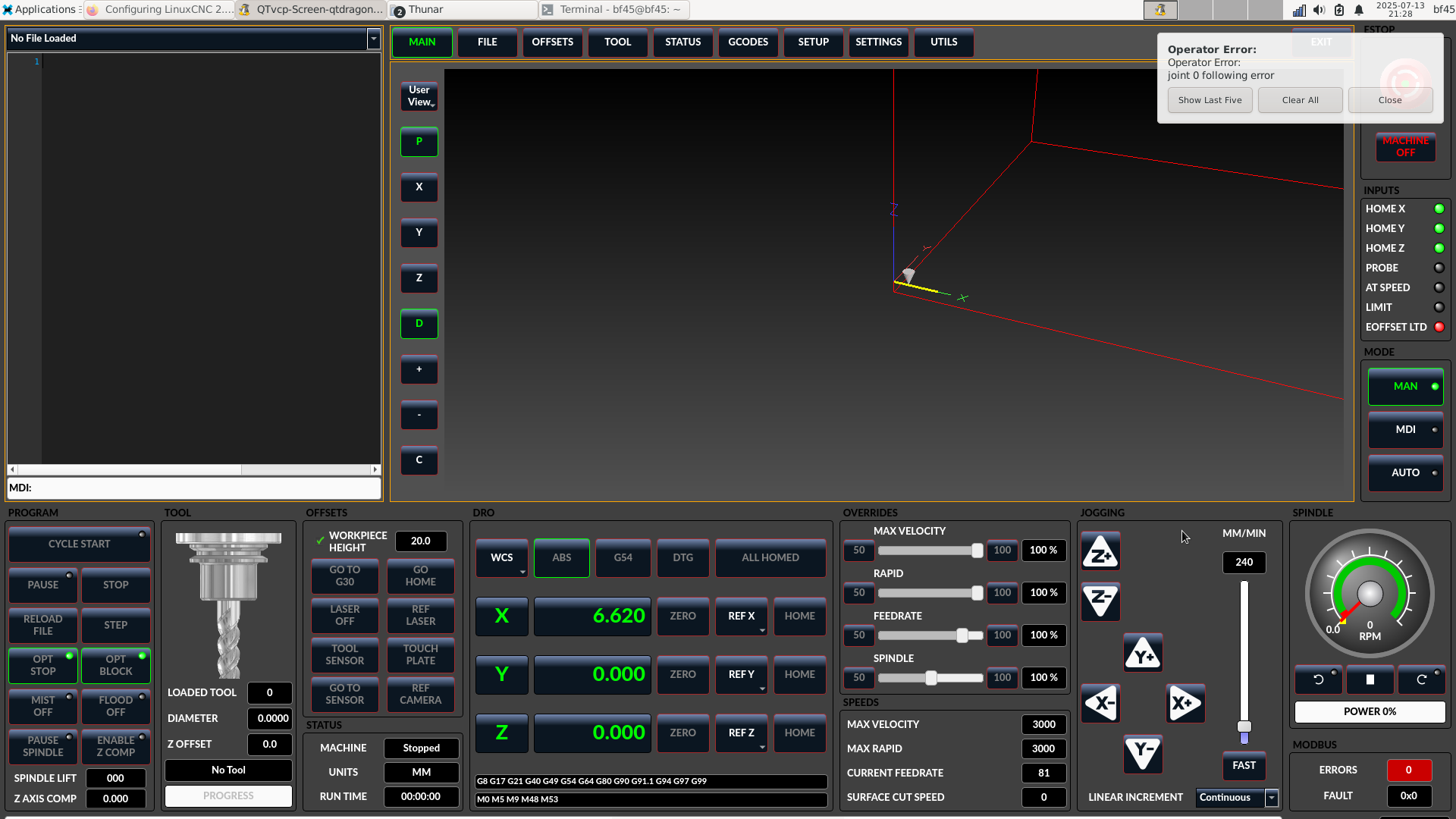

I’ve been trying to get some stuff working and it’s starting to get there,
Added some stuff and mpgs are reading and moving X, Y, Z but it immediately throws an error of positioning error, tired to adjust max acceleration for all axis, and also asked AI to help me make filtering/limiting, worked a little bit, but it went slow and unresponsive,
picture explains more of what happened
sorry for all comments in the files being Swedish.
Last edit: 13 Jul 2025 19:32 by ZXT.
- Posts: 18117
- Thank you received: 5335
13 Jul 2025 20:08 #331782
Replied by PCW on topic Configuring LinuxCNC 2.9.4 Mesa 7i95t Newbie.
These (marked) values will cause a following error if you jog axis:
[AXIS_X]
MIN_LIMIT = 0
MAX_LIMIT = 200
MAX_VELOCITY = 40
MAX_ACCELERATION = 200
[JOINT_0]
AXIS = X
TAB = 0
CARD = 0
MIN_LIMIT = 0
MAX_LIMIT = 200
MAX_VELOCITY = 50
TYPE = LINEAR
SCALE = 320
STEP_INVERT = False
DIR_INVERT = False
STEPGEN_MAX_VEL = 50.00
This is because there is no hardware headroom at 50 mm/s
so if s velocity of 50mm/s is commanded, the hardware may not be
able to keep up. This may be a MesaCT bug, the stepgen maxvel
value need to be about 20% larger than the axis and joint maxvel
values. In this case I would (for all joints) change the joint
maxvel to 40mm/s
Another possible cause of following errors is the close setting of the DPLL
sample time, I would change this from -50 usec to -200 usec
I would also toss all the jog filtering as it's just likely masking a setup issue
