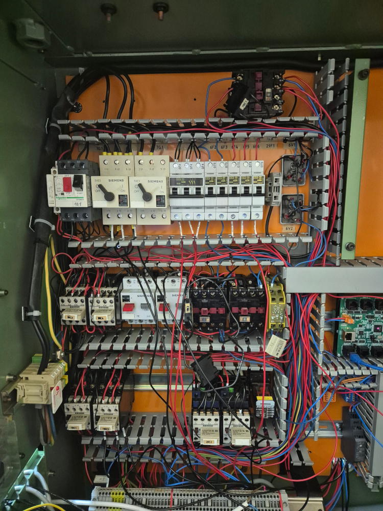

I'm not sure what the underlying issues were with the Indramat, but some of the symptoms were:
- One of the servomotors didn't run at all
- One of the servomotors did run, but stopped at random places
- The last servomotor sometimes just started to run, without giving it a command, and when I did give it a command it didn't run at all.
After debugging for weeks I figured the "easy" way would be to just do a complete redisign. And boy, whas I wrong.

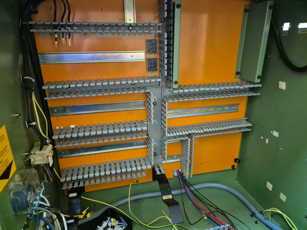

Honestly one of the most terryfying things I have ever done to a machine. Point of no return reached. (Even thought I labeled all the componentens and still have the drawings of the original setup, so I could technically put everything back)
Now I can start to layout the new components in the control cabinet (with cartboard cutouts)

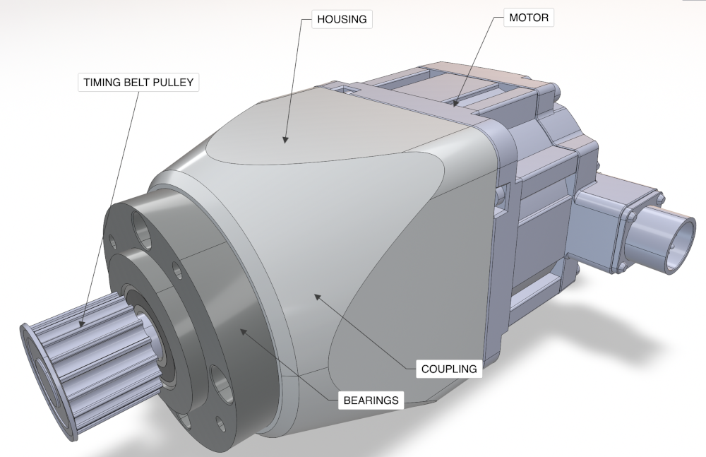

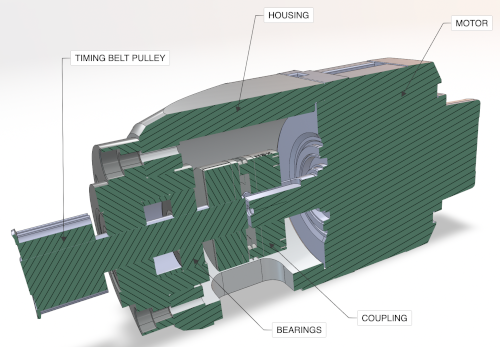

The biggest challenge for me at this moment is the motor adapter for the z-axis (ram), which doesn't have a lot of space.
I already created a design, but I'm having some issues with the tolerances and manufacturability I can't really get my head around.
