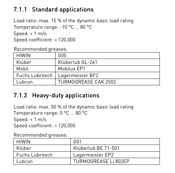

HGH20CA is a Hiwin part number, although I suspect that Sorotec is selling generic clones. Hiwin has an extensive linear guide and ballscrew lubrication guide at the following link (737KB PDF). They recommend viscosity grade NGLI 2, and list specific greases (see attached table).
www.hiwin.com/wp-content/uploads/lubricating_instructions.pdf

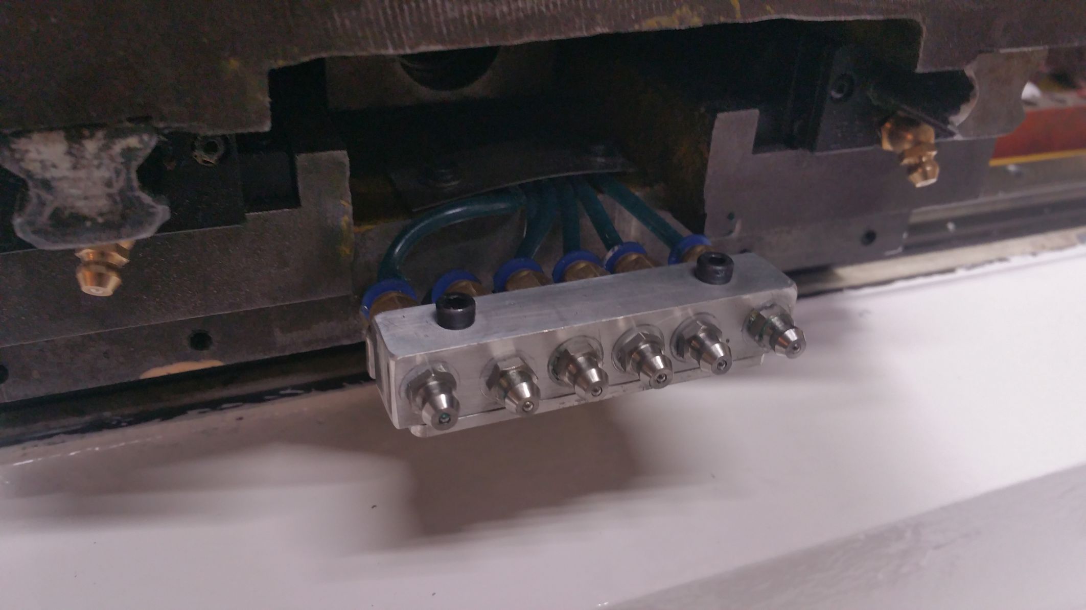

Here's what I came up with for my Mill's Y-axis saddle. Much simpler than running grease/oil lines to a central lubrication pump...make them just long enough for easy access.
Couple pumps 3-4 times a year (low use machine) and no issues since installed.
- Hose is Kynar (PVDF), I believe 4mm OD
- any fluoro-polymer hose/tube should be fine (PTFE, ETFE, etc), stay away from anything else.
- Fittings are just cheap air-hose push-to-connect (same as 3D printer filament tube size)
- The cheap push-to-connect o-rings will likely fail after some years, but it'll be obvious when it happens and I have a dozen or so spare fittings
- Drill out the PTC fitting to remove any unnecessary constrictions (it's surprising how small the ID is)
- The fittings on the actual trucks are compression w/ferrules, so no o-rings to worry about
- Manifold is a really kludged DIY thing - drilled/tapped for the fittings
- it's not actually a manifold... each port is separate
- I'm using NLGI #1, no moly. Any thicker (or much longer hoses) and I'd run the risk of a hose popping out of a fitting.

Since mine are individual, I wasn't concerned with metering. A pump or two and watch for some grease to ooze out of the truck or ballscrew before a long, slow warmup cycle to spread things out. A manifold, metering components, or similar was just going to be a complication. Once they are easy to access it's not a burden to lubricate. And grease generally stays put for quite a while - no need to grease every day like an oil system.
