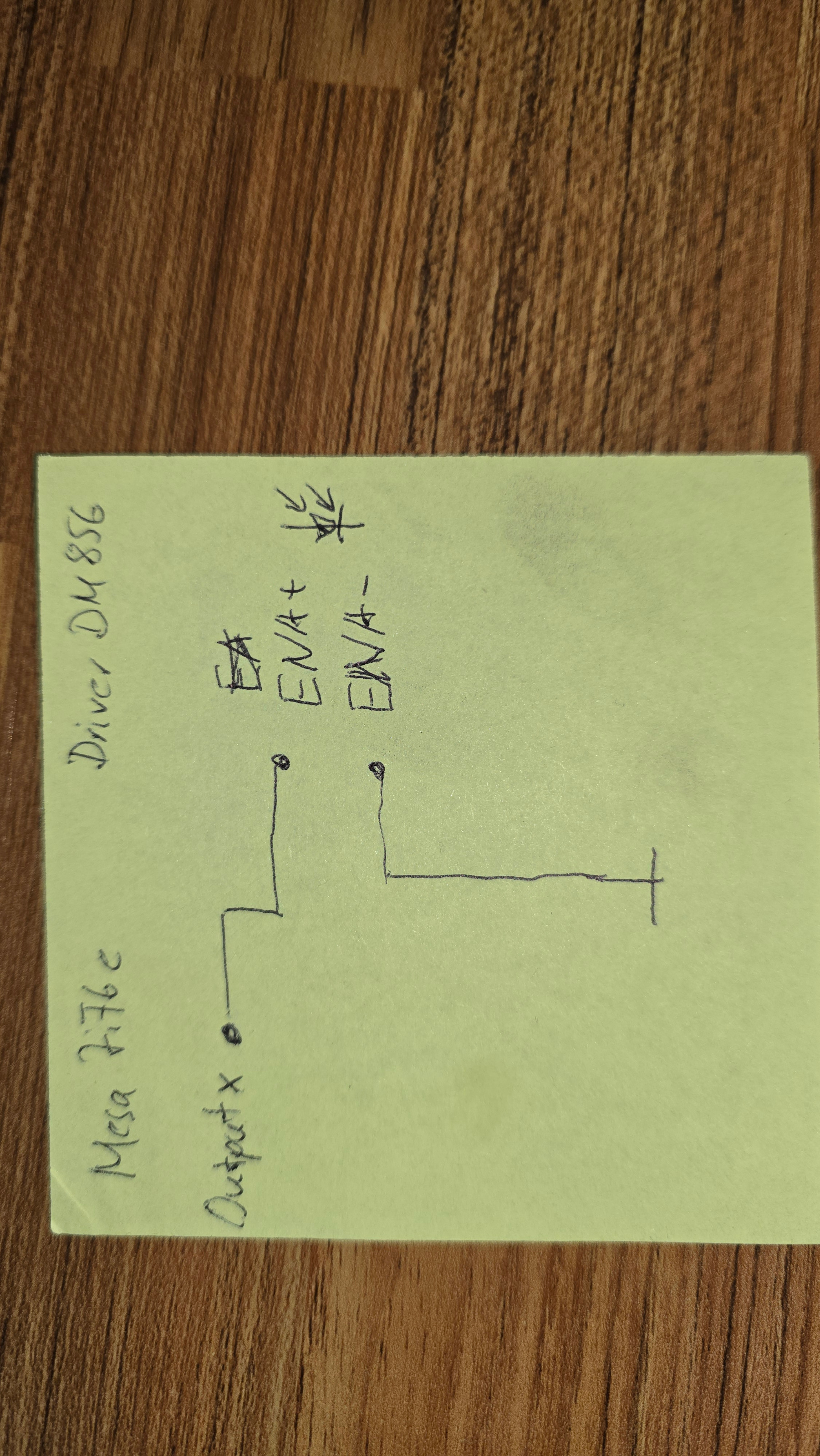

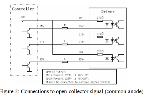

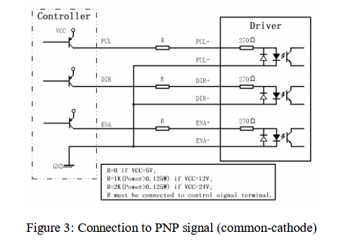

I would like to connect the ena+ and ena- inputs of my Leadshine DM856 to a Mesa 7i76e. If you look at the attachments... which circuit should I use? I would say PNP... but is that correct?

06 Mar 2026 14:36 #343942
Replied by PCW on topic Wiring Leadshine DM856 Ena+ and ENA- -> Mesa 7i76e
Yes, the PNP connection is correct for a 7I76E field output (With appropriate series resistor)
Note the the default operational mode for Step drive enable inputs is disabled when powered
(which is the exact opposite of the desired operation from a safety standpoint)
Unless you can reverse this (so they are enabled when the enable input is powered)
You may need to add an external relay.

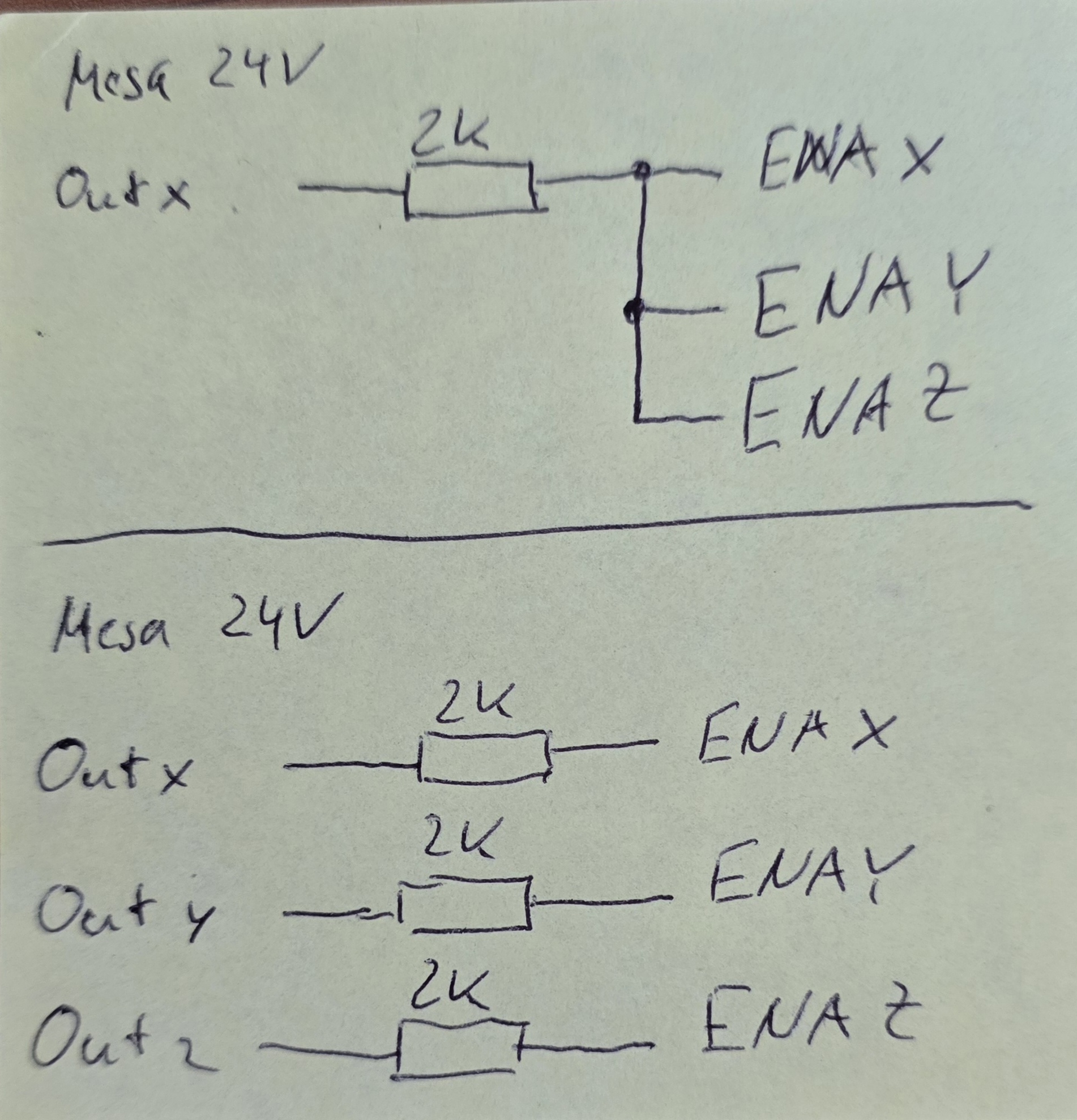

Please see attached file
Can i just use one Mesa output for all three driver or do i have to use three outputs? One for each driver. In the LinuxCNC configuration i can set enable for x, y and z axis.

11 Mar 2026 13:43 #344136
by Clive S
Replied by Clive S on topic Wiring Leadshine DM856 Ena+ and ENA- -> Mesa 7i76e
Yes you can use just one output

- Posts: 18116
- Thank you received: 5335
11 Mar 2026 17:50 #344143
One output, but three resistors...

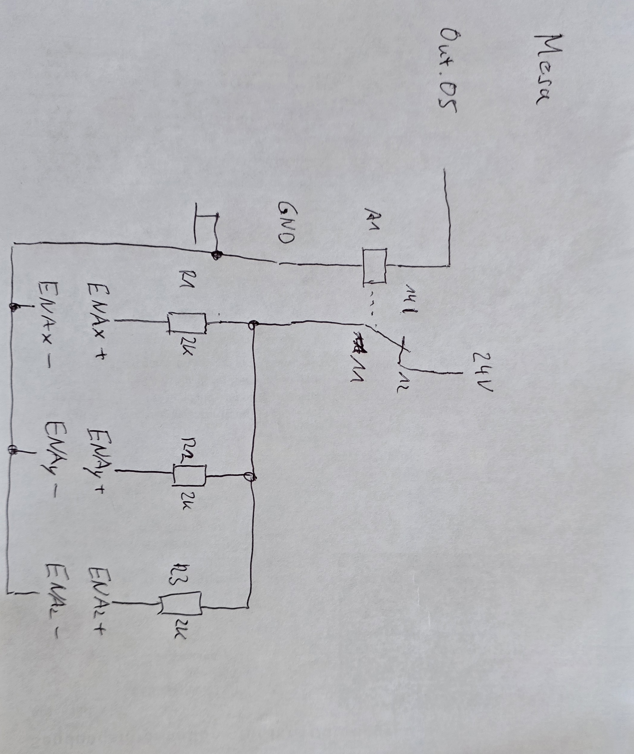

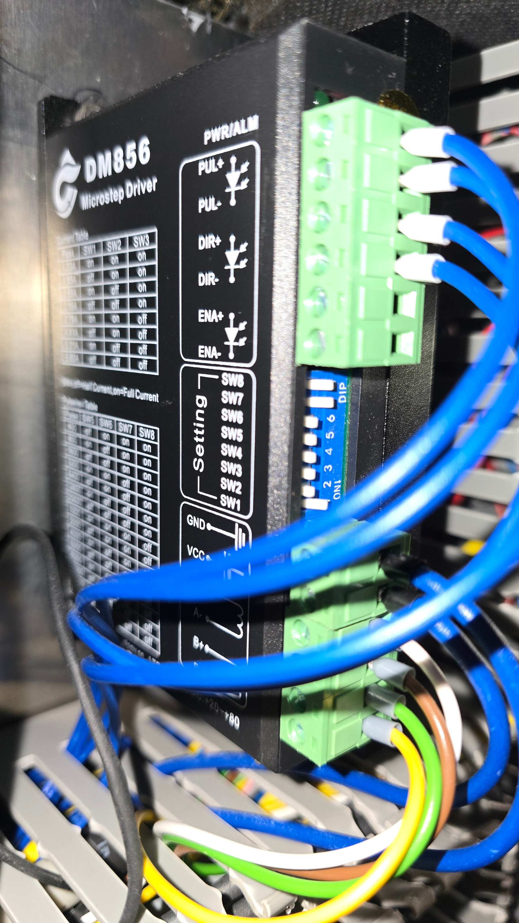

16 Mar 2026 14:59 #344359
by DerKlotz
Replied by DerKlotz on topic Wiring Leadshine DM856 Ena+ and ENA- -> Mesa 7i76e
Here is my working wiring diagram
