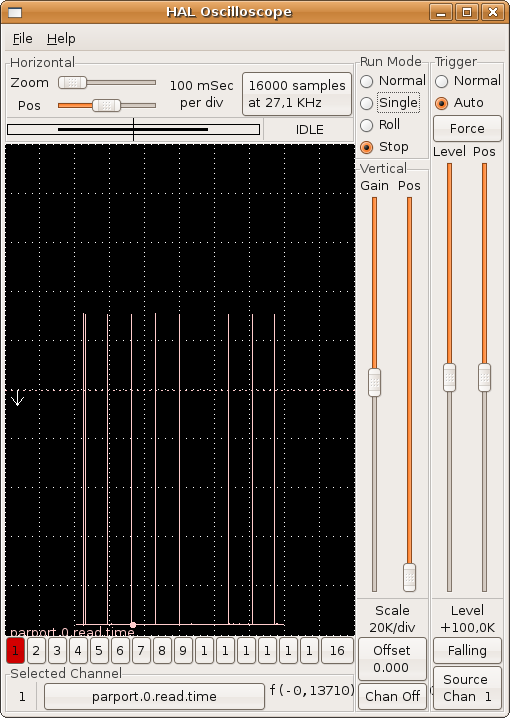

Hello everybody,
I have tested a computer, a Dell Optiplex GX280 (pentium 4 3.0Ghz 1024Mb RAM, Intel chipset and integrated video board) with Ubuntu 8.04 + EMC2, using latency test tool it seem a good HW, the result is Max Jitter (25 us thread) < 20000, but when run EMC2 have an Unexpected realtime delay; check dmesg for details
I have made a test with halscope reading parport.0.read.time and the result are some spike of 130000...
I have just loaded the module rtai_smi, may depend by the integrated video card? there is a solution?
Have you any idea?
Thank you for answers
Bye
Dino

Hi
See wiki.linuxcnc.org/emcinfo.pl?TroubleShooting
for an overview of all the possible issues.
If you run a latency test in a terminal from /user/realtime-(kernelnumber)/testsuite/kern/latency/run it will give a scrolling display with timing.
SMI spikes are very periodic and are usually 32 secs or multiple thereof apart (64 has been seen) .
If I am reading the halscope properly, these spikes are about 70 milliseconds apart?
I don't think Dell (or at least some of the models) enjoy a good reputation when used with EMC, we don't see too many of them in the UK, I expect John or one of the US members can advise.
As a comparison, without meaning to sound smug, my P4 2.8gHz Fujitsu Siemens boxes return a steady 10500 latency on 8.04 without any changes (save turning off power monitoring etc in BIOS.)

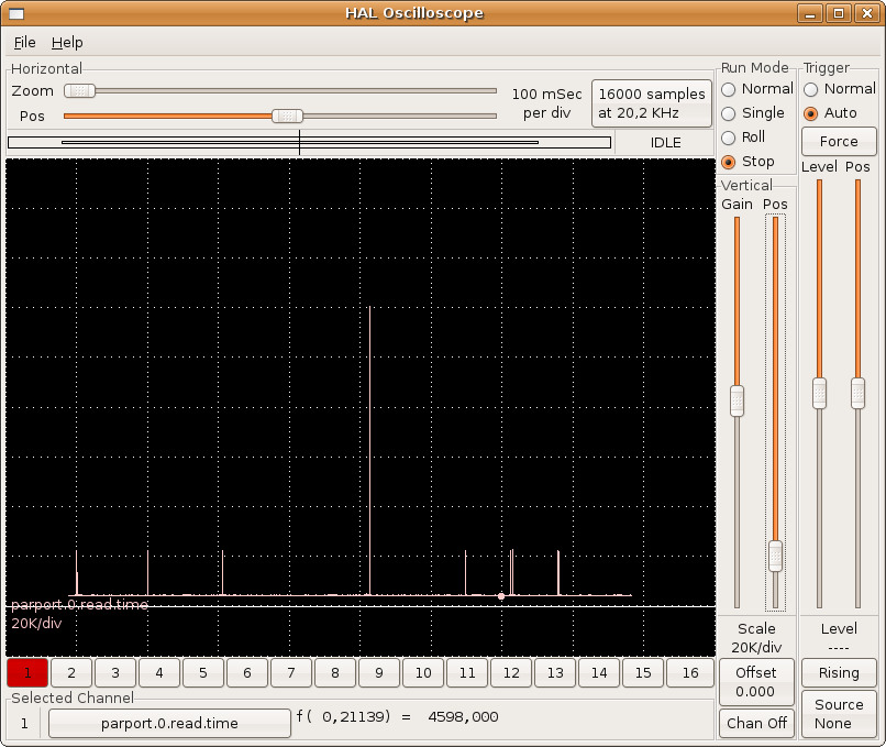

Thank you so much for answers.
Today have made some more tests:
======== by /usr/realtime-2.6.24-16-rtai/testsuite/kern/latency without SMI workaround:

======== by /usr/realtime-2.6.24-16-rtai/testsuite/kern/latency with rtai_smi.ko module inserted:
root@emc2-dell:/usr/realtime-2.6.24-16-rtai/testsuite/kern/latency# insmod /usr/realtime-2.6.24-16-rtai/modules/rtai_smi.ko
RTH| lat min| ovl min| lat avg| lat max| ovl max| overruns
RTD| -1690| -1940| -905| 5849| 39193| 0
RTD| -1819| -1940| -773| 5845| 39193| 0

BUT when run emc2 with stepper/stepper_mm configuration have unexpected realtime delay

Yesterday I have tested the PC with mine configuration, with
BASE_PERIOD = 37037
and
MAX_VELOCITY = 128.250
today have used a standard configuration with
BASE_PERIOD = 50000
and
MAX_VELOCITY = 30.48
i have noted that when the CPU fan increase or decrease velocity in halscope have a shot, someone know if it is possible set manually the fan velocity highest?
I have the possibility to change the pc with an other, always Dell Optiplex but GX270 not GX280, from wiki.linuxcnc.org/cgi-bin/emcinfo.pl?Latency-Test it seem better then the PC I am using, someone know if it is really better?

Thanks!
Dino
I have tried to change the video card with one in PCI bus but in BIOS there is no possibility to switch off the video card integrated, only "AUTO" and "ON BOARD" choice, in AUTO the output are displayed on both video cards, in ON BOARD only in on board of course, not tried yet to config linux kernel to use only one video card.
The BIOS of this PC have no possibility to set options for power-save, only AC-recovery, Auto power-on, suspend-mode and remote power on.
The Hiperthreading are disabled, but I think that have no importance becouse the kernel is compiled without multiporcessor features.
Tomorrow I will try to turn off network card (audio is turned off in BIOS) and configure kernel to use only the PCI video card.
Please check the code of your Dell for me!
Thanks!
Dino
