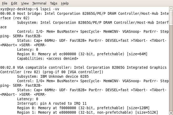

After failing the latency test with 3 laptops, even after disabling auto update and power mgmt. , I installed the latest linuxcnc on a desktop.
About every 30 seconds the jitter goes from 8500ns to over 200000ns. So I tried ubuntu 8.04 and EMC2 but the same thing happens.
I tried Ispci-vv but I get "command not known". Am I condemned to buying PC's till I find one that works with linuxcnc or is there a cure.
The desktop I have is a IBM with a Pentium 4 Intel 828 IEB Ultra Chip. and 1 GB of memory.
Any help would be appreciated.
John.

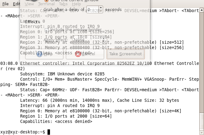

11 Aug 2013 22:12 #37565 by johannbuck
Replied by johannbuck on topic change latency by open a new window

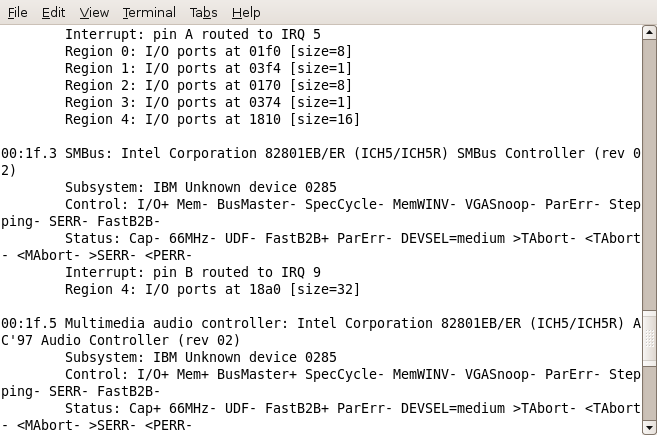

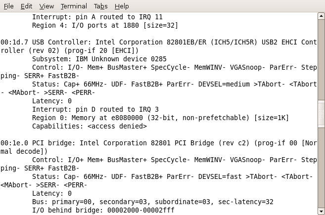

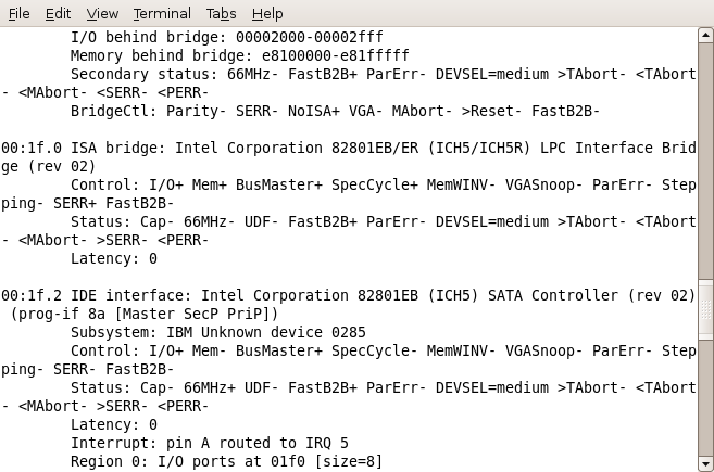

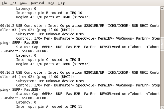

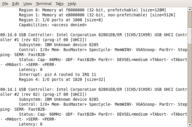

HI ArcEye,
I had installed the latest linuxcnc from Linuxcnc.org. Right now I have 8.04 installed.
The latency problem happened with both . Finally managed to make lspci -vv to work
but not lspci.txt . I get "command not found". Probably something I am doing wrong.
Managed though to make screenshots from terminal. I will attach them.
Thank you for any help you can give me.
John.
11 Aug 2013 22:30 #37567 by ArcEye
Replied by ArcEye on topic change latency by open a new window
Hi
It is not a command. lspci -vv is command to list pci devices and -vv means at max verbosity (detail)
> lspci.txt means direct output to a file called lspci.txt
So running lspci -vv > lspci.txt should produce nothing at the command line but a file called lspci.txt will be created in the current directory containing the output
I have managed to piece together from the various truncated screenshots that you appear to have a 82801EB/ER rev02 chipset
If you read the additional post on the latency solutions FAQ
www.linuxcnc.org/index.php/english/forum...me-latency-solutions
you will see that I specifically mentioned this chipset.
It does not have the SMI problem, but exhibits similar behavior unless you turn off all power management, hyperthreading and set the fan to full speed all the time.
Read the post and then go into BIOS and locate and set the various options accordingly and hopefully it will stop the spikes
regards
