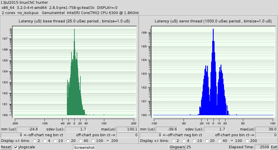

Received some advice from user PCW to try my hand at preempt as he thought that I might see better results, sharing histograms from a few machines he'd tested with latencies averaging ~20uS with an E8500 similar CPU (more GHz and larger cache than mine). Not knowing what preempt was when first suggested, it took me a few evenings of piddling around before getting lucky and finding a way to get it to work. All installations are now made from DVDs burned in Windows as it has been the only method I've been able to get to work thus far. Installed Wheezy 7.8 x64 and then added the key and repos for the preempt branch and used Synaptic to install.
Now getting peak latencies of no more than 50uS. There are a few residual problems that I am still working through:
1) Display will momentarily blackout on a random basis. The PC is in my garage and it's been pretty hot in North Central Florida these days so not sure if I have driver issues or if something is overheating? Haven't been able to identify if it happens in cooler ambient temps. I tried the proprietary ATi driver and got a black screen so went back to the xserver radeon driver.
2) Running the histogram latency test only allows me to open no more than 4 instances of Glxgears before no longer opening new instances. The system does not allow opening of other applications at this time either, CPU is at 100% so guessing it's working as hard and as fast as it can, and can't get to other threads. Latency is holding under 50uS in these testswith an average of 20uS.

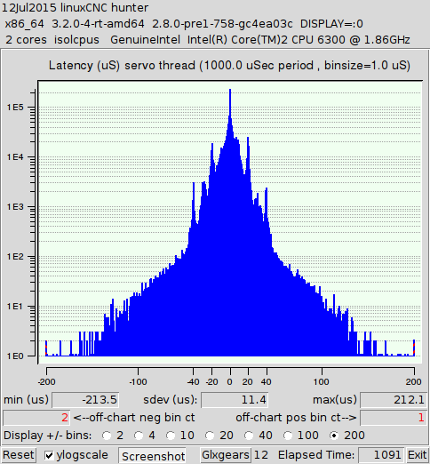

After debugging the problem with the limit on Glxgears, I came across this message in dmesg:
[drm] Loading R200 Microcode
platform radeon_cp.0: firmware: requesting radeon/R200_cp.bin
radeon_cp: Failed to load firmware "radeon/R200_cp.bin"
[drm:radeon_do_init_cp] *ERROR* Failed to load firmware!
which led to a solution regarding firmware for the xserver for radeon:
$ apt-get install firmware-linux
$ dpkg -L firmware-linux | grep R200_cp.bin
which got rid of the error in dmesg, but it has ruined my latency! Now experiencing 200uS+ peaks. Really hoped that eliminating GPU problems would help latency, not work against it....perhaps I've created more. Good news? is that I can now run as many copies of Glxgears as I want. If only watching parallel copies of that animation were as fun as actually making things on a mill!
Tried isolcpus again to see if it would bring back any performance, but no luck. Histogram attached.

If you can get back to the 50uS setup that it probably adequate if you are using Pico boards.

Well I performed a few more experiments
1) Removed the installed firmware to see if I could regain the previous performance. Easy enough return to around a 42us peak.
2) Realized that it was possible that I'd installed the incorrect driver for the GPU. So went back through the firmware process installation (confident now that I can always revert) for what I knew to be for the correct model/family of board RV560. Installed, and returned to somewhat better latencies than the previous installation, but still above 100us.
3) Started to dig into when the latency was being generated: Glxgears generation, HD Youtube video, network access in general? It turns out that the Chromium browser I was using was the trigger for the 100us spikes. Dumped it and went back to Iceweasel and have now been able to run with a max of 39us! While running 25 Glxgears.
Lesson learned: Chromium is a resource hog!

Don't get too hung up on latency testing, if you are not using software step generation off a base thread, anything under 100us will probably work, certainly 50us
Glxgears is supposed to try to simulate openGL in the gremlin widget of Axis, but 25 instances whilst watching a flash video is not real world testing
