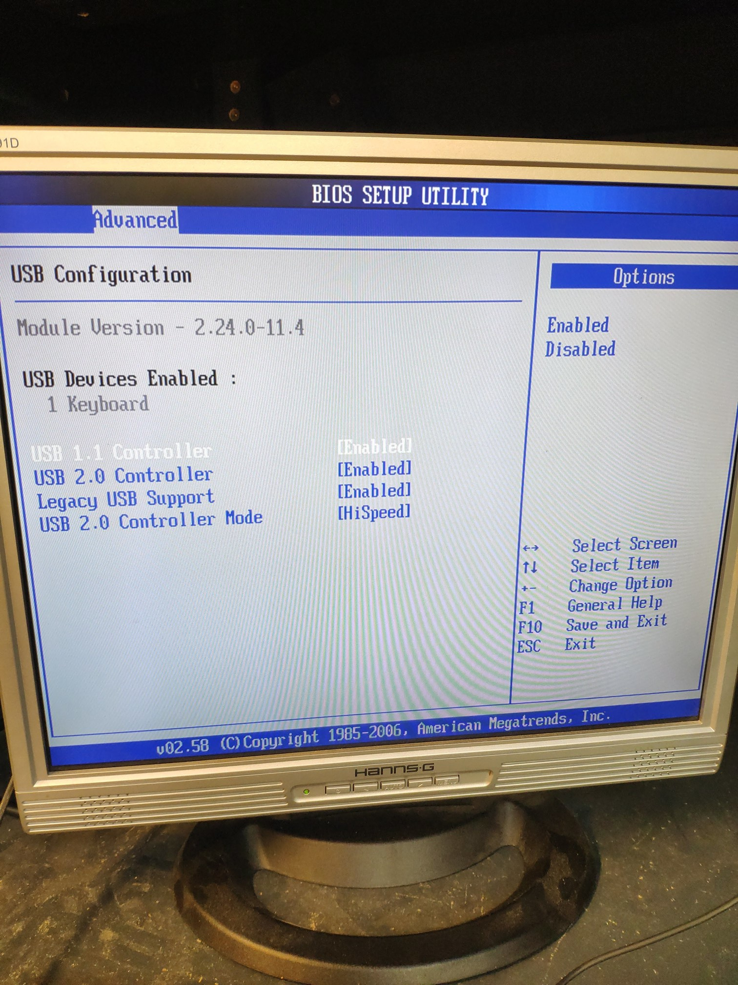

- johanneshk
- Posts: 6
25 Dec 2020 11:57 #193171
by johanneshk
Replied by johanneshk on topic Choose between two PC's, both have issues
Thank you for your reply.

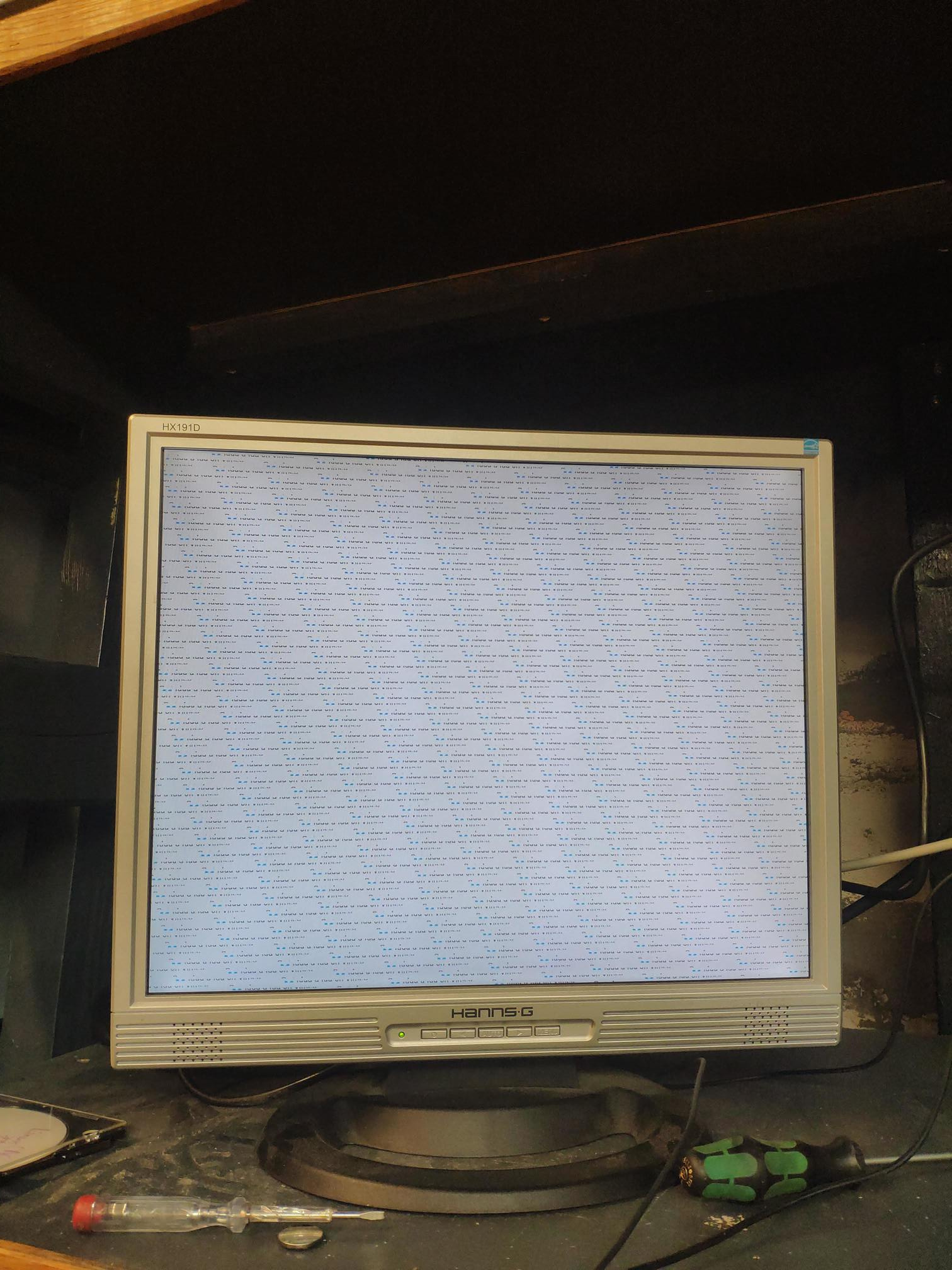

Computer 2: Legacy USB Support is enabled, see attached picture.
I also ran memtest86+ on all RAM and there are no errors. Was thinking an error in RAM might have caused the instability on computer 1. Check the second picture for how the screen looks when it freezes when I run the automated latency check on computer 1:
Maybe it's the internal GPU on computer 1 that's somehow broken?
- Posts: 22002
- Thank you received: 7488
25 Dec 2020 15:15 #193180
Replied by tommylight on topic Choose between two PC's, both have issues
Yup, that should be it. Find an old GPU and see if it works, preferably Matrox G400 or 450, or ATI/AMD.Maybe it's the internal GPU on computer 1 that's somehow broken?

- johanneshk
- Posts: 6
06 Mar 2021 16:29 #201197
by johanneshk
Here's the result for the latency test script for computer 1 after putting in the Quadro 4000:
Seems like I'm on the right track now (?).
