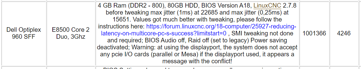

After many tests i get mad and i see this:
So i search for a Dell Optiplex 960SFF and got one.
The test shows: Jitter arround 30k - so what should i do?
The Dell is not the same than the one in the wiki.
Here the Values:

Workstations from Dell, HP, Fujitsu, have good latency, but for the same price you get a bad PC and a 5i25 or 6i25 or 7i92, or stretching a bit even a 7i96 and get rid of all the issues you are trying to solve.
It is just not worth wasting so much time and energy, been there done that, i found i Fujitsu-Siemens Xeon workstation that can do 55KHz pulses, cost me way more than a 7i92 that can do 1MHz pulses, a lot of time fiddling and tuning etc, now collecting dust in the shop as it uses 300W of power at idle running two xeons and 32GB of ECC ram and other stuff.
