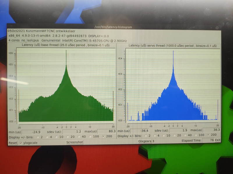

I'm currently working on a Kunzmann retrofit. I'm using a Lenovo M93z with Mesa 7i97+7i84. I'm trying to get the latencies as low as possible. See the attached photo.
The ethernet ping latency to the 7i97 is mostly between 0.126 and 0.175.
Are the latencies good enough, or can/should the be improved?

Latency looks good but that is to short of a timeframe for anything useful.
Do not bother much with laytency since you have everything wired, just leave LinuxCNC running and do whatever on the PC, watch videos, copy files, move windows around, etc, if it does not complain about latency excursions you are good.

Currently tuning the servos and programming the HAL file. So far so good, no latency errors.
