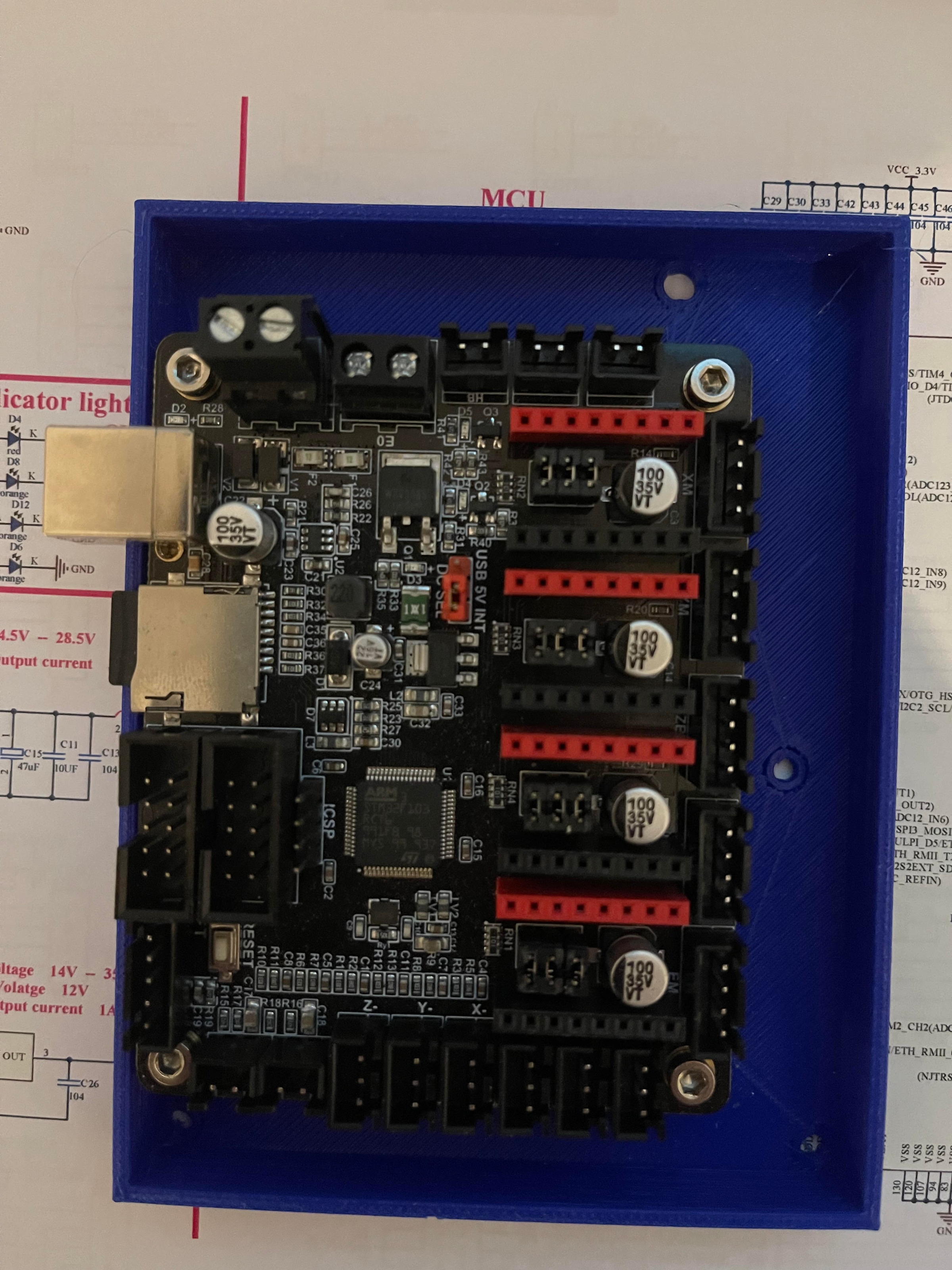

I think it could work on F417 but i didn't own a dev board with this MCU.
For the F1 i'm using a BTT SKR mini 1.1, paid 10$ for it on Aliexpress, i bought 2 at the time, i can send you one board if you are located in Europe. It's a STM32F103RCT6

Thanks for the offer, but I'm in Australia so a little too far to ship. I've just orders a Mks Robin with the same MCU. It should be hear in a couple of weeks I hope. Extending to more STM32 chips does not look to onerous.
