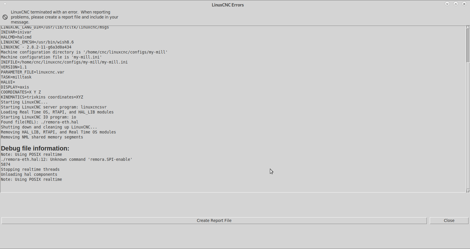

Ok. I managed to download and install it. I rewrote Hal as I wrote royka. I don't understand what you mean (my ini file). Royka: In which file did you overwrite the output for the spindle? Now I stopped setting up a static IP. I tried different ways according to the instructions from the web, but without success. Another question: what then? How did you install mymill for remoru? Via Applications-Linuxcnc (axis) or via some wizard? For example, for a mesa card? Because only there it is to write the IP address. I guess I really should have bought a Mesa card. But I liked this board (simple, described inputs and outputs, communication speed, ethernet and of course the price). And I like to try new things. And when I came across this thread, it seemed easy to me. But it is not so. At least not for me.

And I don't understand why it's not all as easy as in the deebian wheezy I used on the LPT port before. Now I have installed Livecd LinuxCNC Deb 10 Buster and the terminals are missing some components like wget and so on.

Your ini file is the configuration file. You can find everything on this forum, wiki, google, youtube. The things you're asking is mostly the beginning basic, start reading please. You say you like to try new things, but then you ask why it's not as easy as it was with the lpt port....
linuxcnc.org/docs/html/common/linux-faq.html#faq:terminal
linuxcnc.org/docs/html/getting-started/running-linuxcnc.html
linuxcnc.org/docs/html/examples/spindle.html
When you created a configuration with the wizard it creates a shortcut on the desktop. You could right click on it and choose (something like) "Edit launcher" and you will see which ini file it loads. In the folder of that ini file you have to copy the hal file to. Then in the ini file type the name of that hal file (instead of the default one).
In short with the launcher, you start LinuxCNC with the configuration file, so LinuxCNC knows which configuration to load.
In your configuration file (.ini) you can tell which hal file to load.
The spindle configuration in my post probably needs to be inverted, in the manual of Remora you could find how to. When I'm ready I will post my config

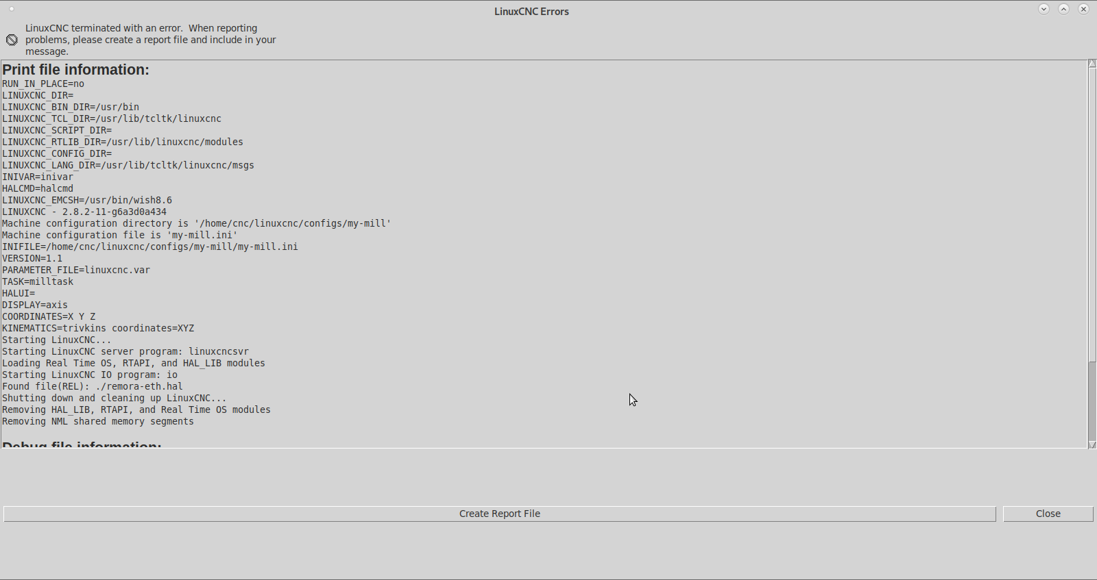

I also adjusted the lines 12,13,14 according to royk but it doesn't work. Then I used the original but it still doesn't work. It gives an error. Can't advise where to bounce?

Read, it says unknown command "remora.SPI-enable". So you didn't change that line
