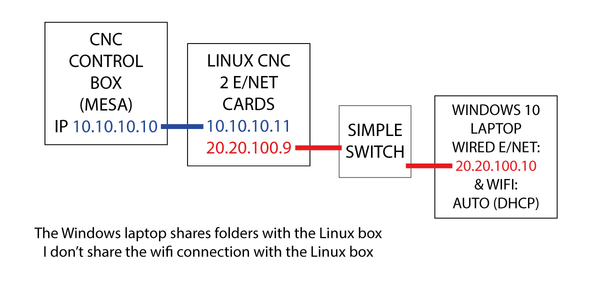

So I've dropped a second network card into my Linux box so that I can access a shared folder over on my Windows CAD machine (and do away with the somewhat tedious USB stick file transfers...)
All working very nicely, but one thing that I'd like to do is set the Linux OS to automatically select the correct network for the intended purpose - for example: occasionally on start-up Linux will assign the Ethernet Connection to Mesa 7i96 config to the network card that's connected to the local network and the Ethernet Connection to Laptop config to the network card that's plugged into the Mesa card.
It's simply a case of assigning the correct network config to the relevant hardware to fix this at the start of the session, but it would be nice if it was all set correctly on start-up.
Any ideas?

Mesa boards should be wired dirrctly to the PC, never through a hub or switch.
That was my initial thought on the issue, but skipped as it should be mentioned everywhere.
Apparently ut is not mentioned enough.
Also, use two subnets, meaning, set the Mesa board to 10.10.10.10 and edit the PC accordingly.

Sure thing - the Mesa is directly wired to the on-board ethernet and the additional card is doing the biz for the networking side of things.
Mesa uses the 10.10... network ID and the networking config is on something totally different. It all works wonderfully, just the luck of the draw when it comes to which config the OS assigns to which card on startup.
One way around this is to not power up my control box (which houses the Mesa card) until the OS has booted, that way the system always assigns the networking config to the card that's connected to the network and the Mesa connection goes active when I fire up the control box and the Mesa card gets power. It's odd that this happens, but it's no big deal, I was just wondering if you could force a network card to adopt a config (the same config) on startup.

I'll make a video to let you see exactly what's going on. Again, it's not causing me any issues whatsoever in terms of functionality, everything works how I expect it to, just odd that it swaps configs between the two cards, which I can assure you 100% that it's doing. Look, here's a video to prove it:
Prior to the restart, note how the Ethernet Connection to Laptop is assigned to the RTL810xE network card and the Ethernet Connection to Mesa is assigned to the RTL811//etc. After re-boot they've swapped.
Once again, the configs use entirely different IP addresses - the Mesa is on 10.10.10.10 and the network card that connects to it is on 10.10.10.11 (and this network card connects directly to the Mesa card with no intermediate switch/router etc.) whilst the config for the card that does the networking uses an entirely different IP - ie. 20.20. and connects to the laptop via a switch (I would have used the standard 192.168 but when I tried that Adobe CC over on the laptop decided to start trying to use the wired (private no internet) instead of the readily available wireless. There's absolutely nothing that you can configure in the Adobe software to change this (I've asked Adobe). For clarity, here's a diagram of my set up.
