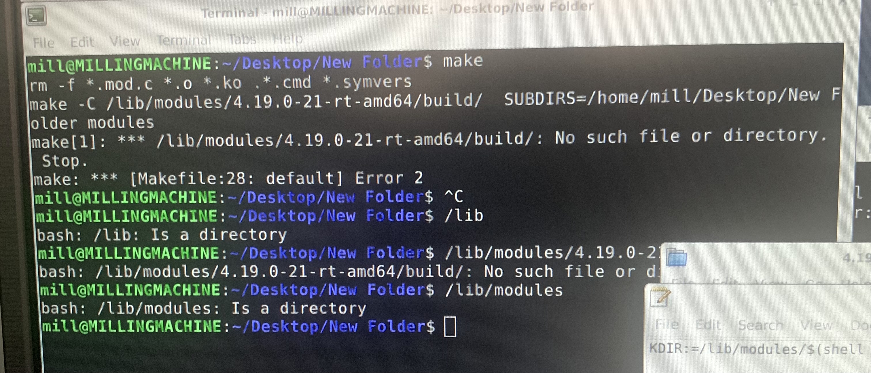

im trying to run the make file for a non-serial parallel port card. this is my first experience with linux. it gets an error in the make any advice would be great.

No need to build or compile, it should just work.
You just need to get the address for it and edit that in hal.

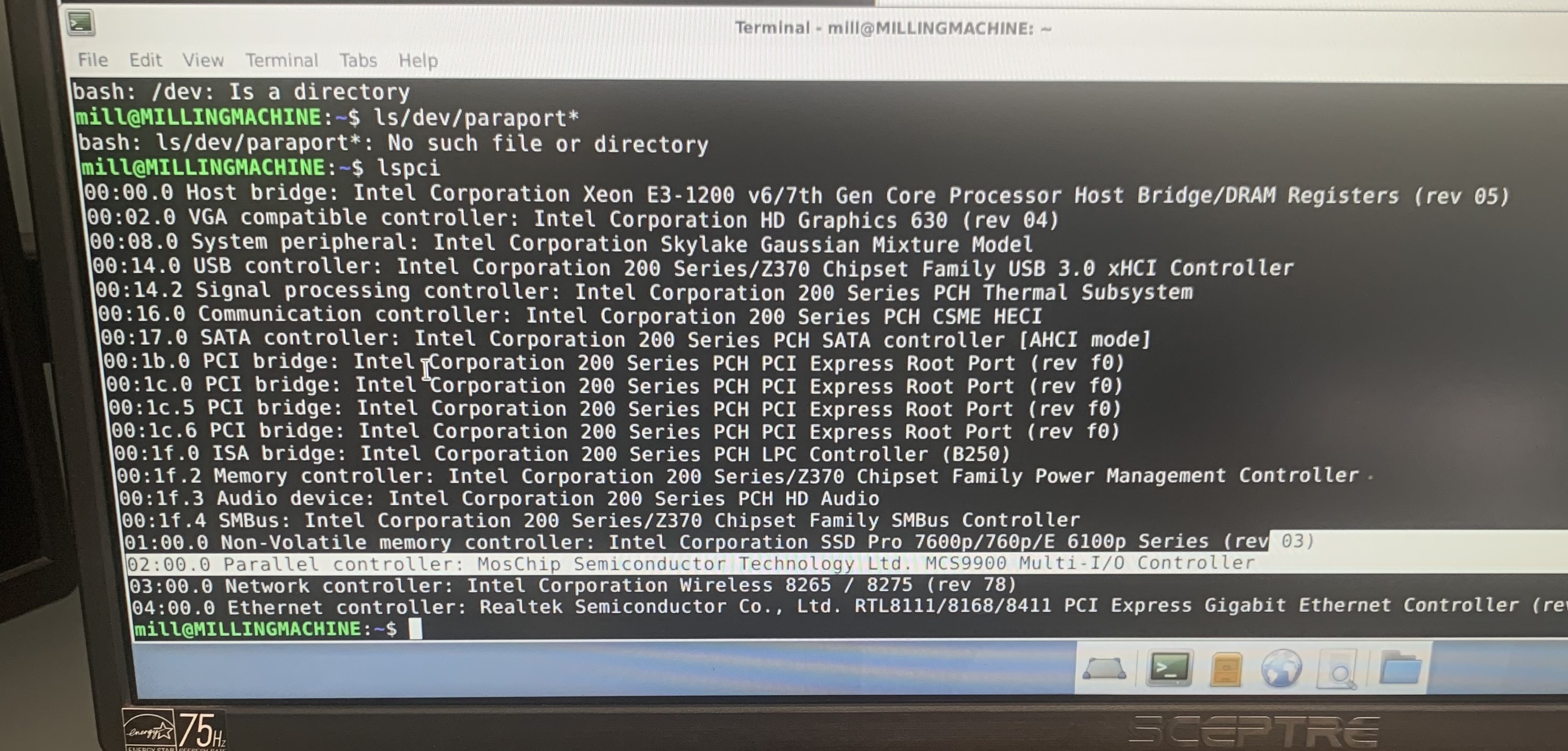

sudo lspci -v
will show also the address and probably the driver in use.
