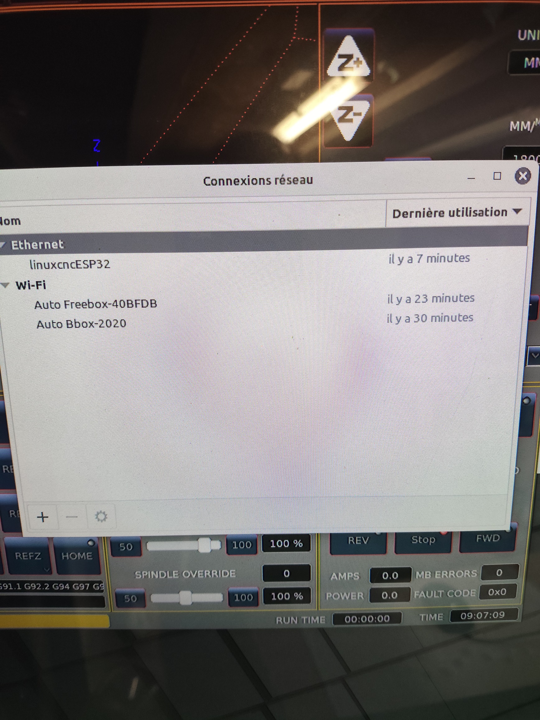

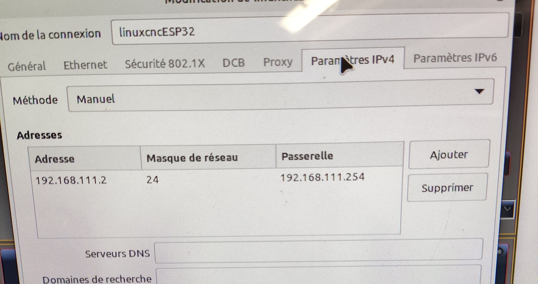

Set the networking as described in the readme, connect stuff, open the included config folder, right click on the ini file and choose "open with" then linuxcnc.

I modified the network settings, I think I am connected, I cannot open the .ini file with linuxcnc because I do not have the option,
the 2 hal and ini files must be copied into a configuration created by stepconf wizard?
if I copy them in I switch to qtdragon?

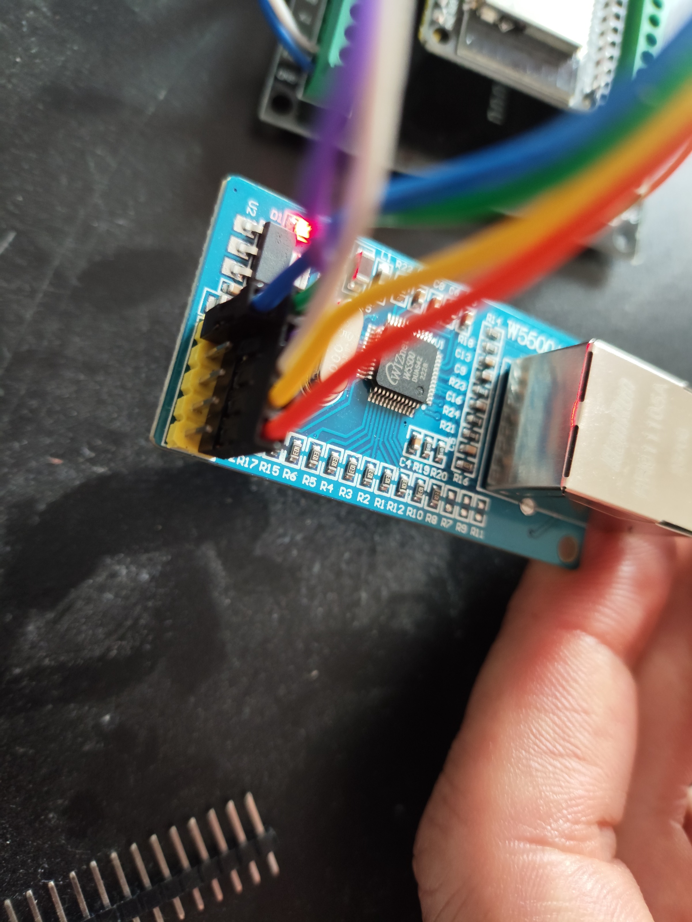

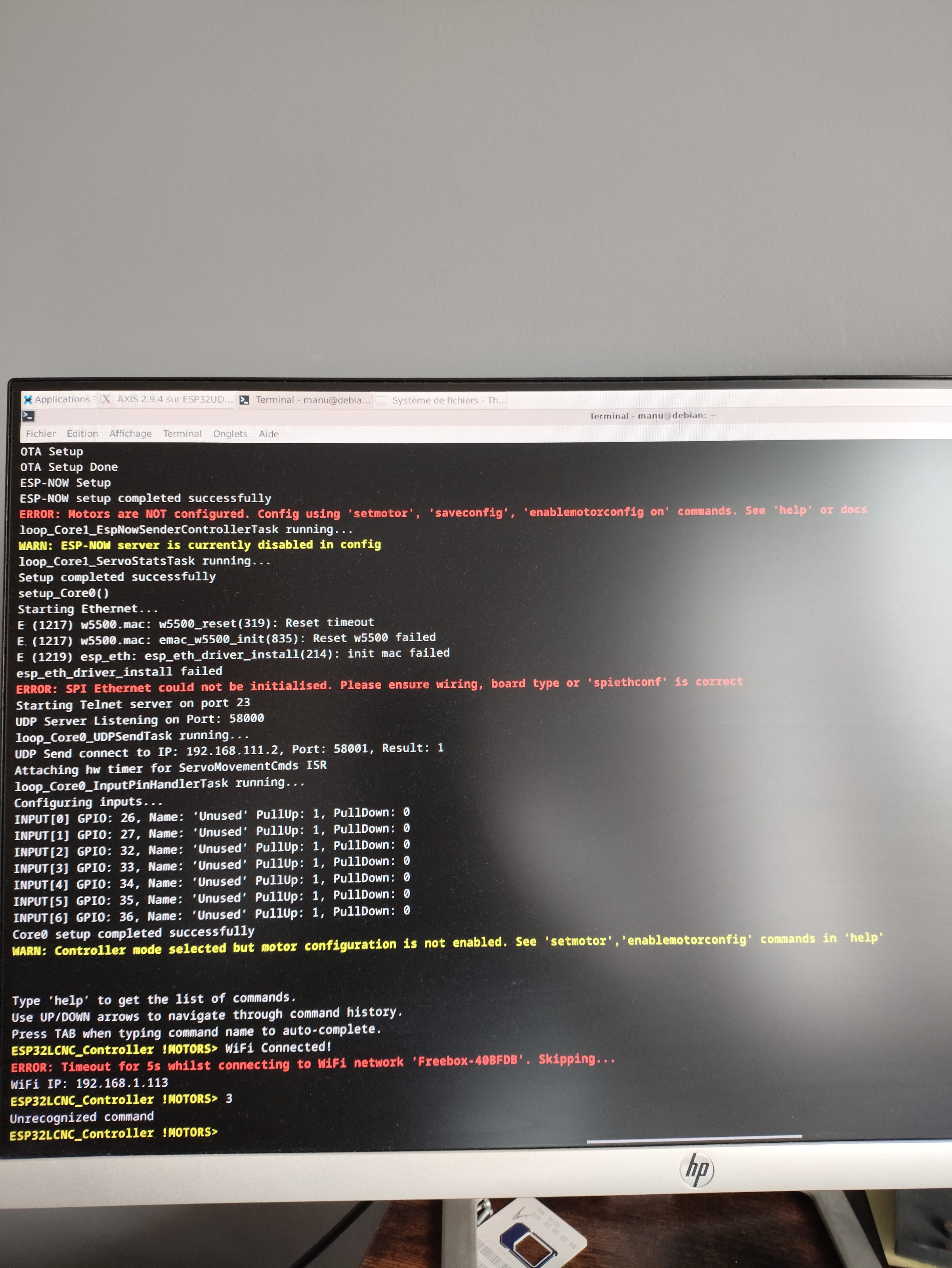

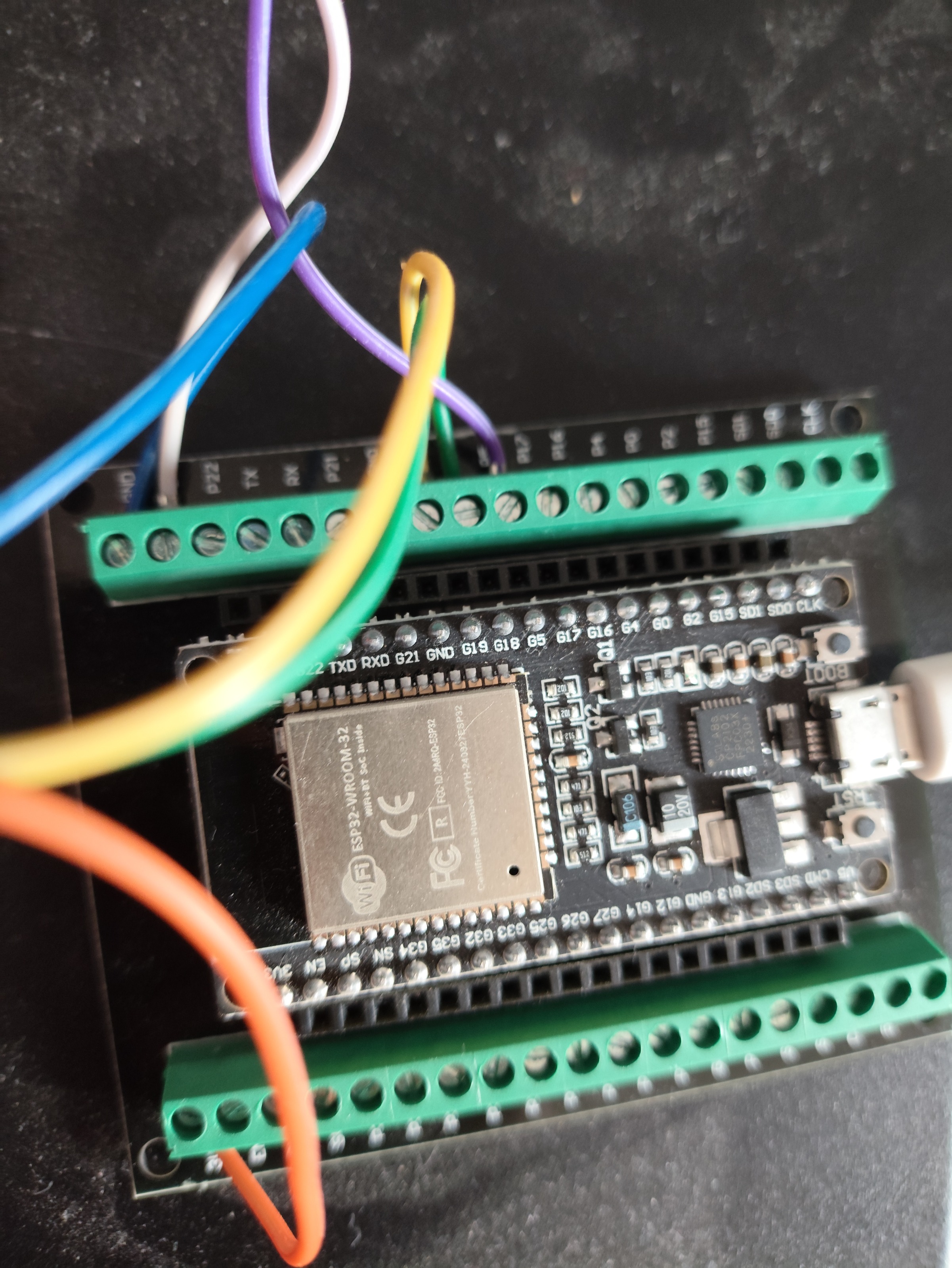

Hello,I don't understand what's wrong. I think I connected the card to the ESP32 correctly, but I get an error message.

Try to set networking from serial, if it reboots do not bother with it as it will not work.
Something got left unfinished, the developer has not been around for a year or two, so short of you forking it and fixing it, there is not much use.
It also does not work with ESP32S3 despite him posting everything running on it, it will not compile at all.
Use the hal2udp version of it, the older version worked fine on ESP32Wroom, but the new version also has issues. You can get the older version on github, or try the new version as this one is being developed still.
