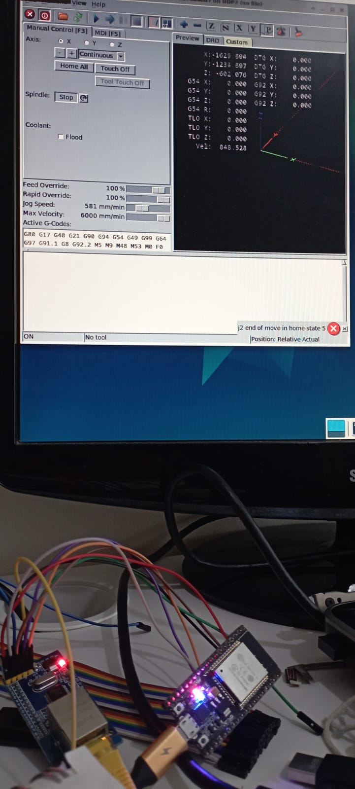

Hello, I just started working on the linuxcnc esp32 W5500 setup and I ran into some issues.
1. Hardware: Rpi4 8gb with linuxcnc 2.8.4, W5500, Esp32 Wroom
2. Esp firmware: hal2udp pwm
3. Motion: open loop stepper with TB6600 Driver
Issues
1. activation of spindle or flood no voltage change on esp32 pins 4 or 25.
2. joint follow error all axis3. My stepper is enable without the enable pin connection (I'm not even sure what pin to use for enable/disable on the esp32-the pin out from the read file doesn't show what pin to use.
3. udp.stepgen.1.enable (error doesn't exsist) (My assumption is that because the udp.comp file doesnt show the param or pin) maybe I'm missing something
4. is the Pid function only used for closed loop steppers to accurately determine movement
I attached my hal and ini files
thanks for the help
Issues
thanks for the help

Use the serial monitor feature to see if the ESP is connected and working.
Use ping to make sure network is set up properly, ping the W5500 on the address you set in PlatformIO/Code

I think I found the problem. I am using a straight through instead of the cross over Ethernet cable I should be using
thanks for the help
