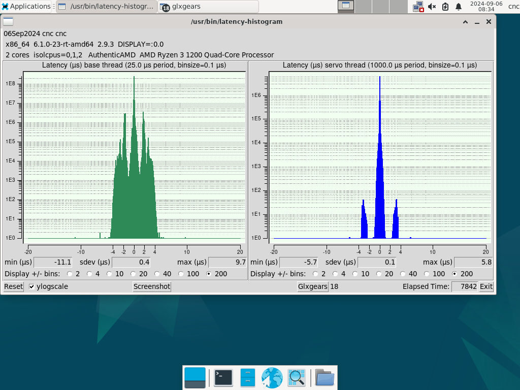

This is my first post on here so if this is posted in the wrong place please let me know.
While doing research into machines with good latency numbers for use in parallel port-based step generation I keep seeing discussions about using older enterprise hardware to get good latency numbers. After seeing that most of these systems are from a decade ago I wanted to conduct some experiments to try and find a combination of new components that are able to create a system with low latency for use with parallel ports.
I have a large collection of DDR3 and DDR4 era machines to work with so I thought that it couldn't be that hard to find a modern solution for the latency problem. I had seen on this form in a few places where AMD Ryzen CPUs were not able to create latency numbers low enough to be useful but I had not seen anyone explore using the few non-hyperthreaded Ryzen CPUs.

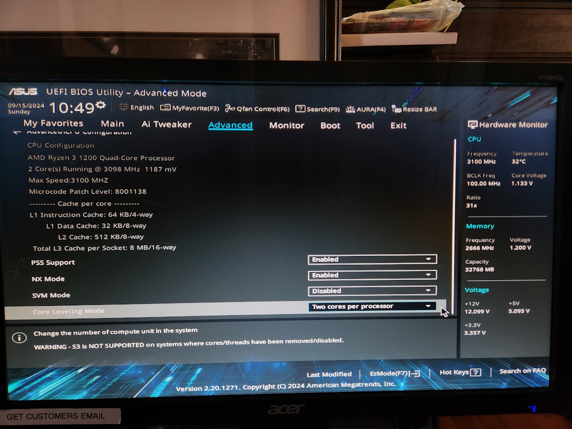

After a few months of trying different configurations, a pattern started to emerge with the non-hyperthreaded Ryzen CPUs. When they are run in Core Leveling Mode set to 2 Cores per Processor their latency numbers are greatly reduced. This effect can be compounded by isolating CPU cores 0,1,2 in the 4-core Ryzen CPUs. The results from doing this decrease the latency so much that I thought it would be worth posting here for those trying to build a new system for Linuxcnc.
If this effect applies to all non-hyperthreaded Ryzen CPUs then there are significantly more possible combinations that need to be tested. I only was able to test what I had on hand which was the Ryzen 3 1200 and 2300x, but both machines showed this trend to some extent. If there is someone else who can verify that this is not some one-off instance of this effect let me know.
The pictures below are from this machine:
CPU: AMD Ryzen 3 1200 w/ Stock Cooler
GPU: AMD Radeon R5 430 2GB GDDR5
MotherBoard: ASUS Prime B450M-A II
Storage: 970 EVO 250GB - NVMe PCIe M.2
Ram: G.SKILL Ripjaws V Series 1x16gb in DIMM slot 2
Power Supply: Thermaltake Smart 500W 80+
PCIe Parallel Port Cards: StarTech.com 1-Port Parallel PCIe Card PEX1P2
OS: LinuxCNC 2.9.3 Debian 12 Bookworm PREEMPT-RT ISO
Kernal: 6.1.0-23-rt-amd64

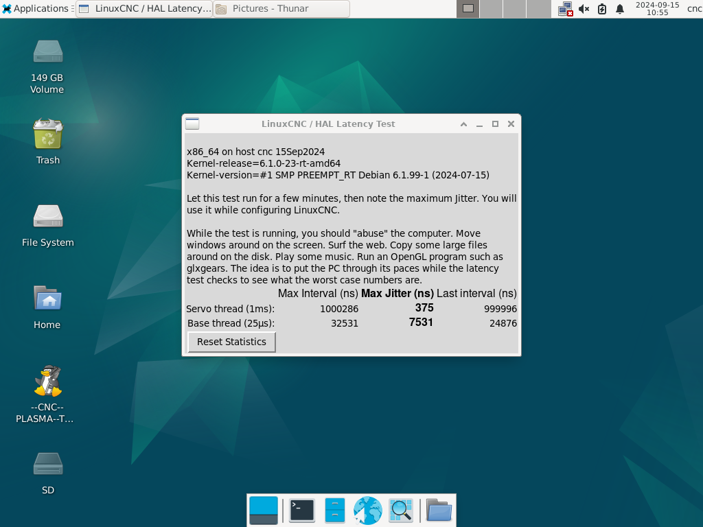

All Gixgears instances were run in full screen for the full duration of the histogram.
The Latency Test shows the results after running the Geekbench 6 stress test.
If there are any questions about this setup or configuration I'll be here to answer them.

I had a non hyperthreaded Ryzen 5 3500, it was terrible out of the box in latency on a B550 board, it was quite ok on a B450 board.
Had plenty of 3600, 3700x and 3900x and 5600X and 5600G and all are very good out of the box on both types of boards.
Mind you, i never tested with parallel port, only Mesa Ethernet and PCI and PCI-E.
I did have an MSI ATX B450 board that had a parallel port header, expensive gaming one that i got refurbisht for half the price with 3 month warranty, it had very good latency with a 5600G, but again, i did not test much with parallel port except that it worked and switched pins.
Notice i never use isolcpu, just disable stuff in BIOS.

It's good to hear that you were able to get some good numbers out of the larger Ryzen CPUs. How did you disable the hyperthreading on your Ryzen 5 3500? I always assumed it was built into the architecture on a physical level in a way where it could not be disabled.
I have tried running the above-listed parameters on the 5500 and 5900x but wasn't able to extract the performance numbers of the non-hyperthreaded ryzens. I should probably get my hands on a G series Ryzen to see how much the latency is impacted by the onboard graphics processing at some point.

Ryzen 5 3500 is 6 core 6 thread CPU, so it has no hyperthreading.
Also had a Lenovo ThinkBook 14 (i think) with Ryzen 5 5500U that was perfectly OK for use with Mesa boards, tested on a machine for several days.
Now i only have a 3600 non X on a B550i board, not tested yet, but the same board with 3700X was perfectly OK.
Use bigger coolers, although series 3 and 5 do not heat much, the temperature does fluctuate at the higher end when RT is in use, so might cause throttling and subsequently latency spikes.
And if there is no need for base period, there also no need for very low latency.
