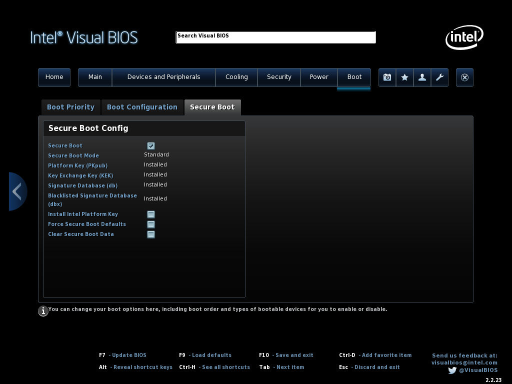

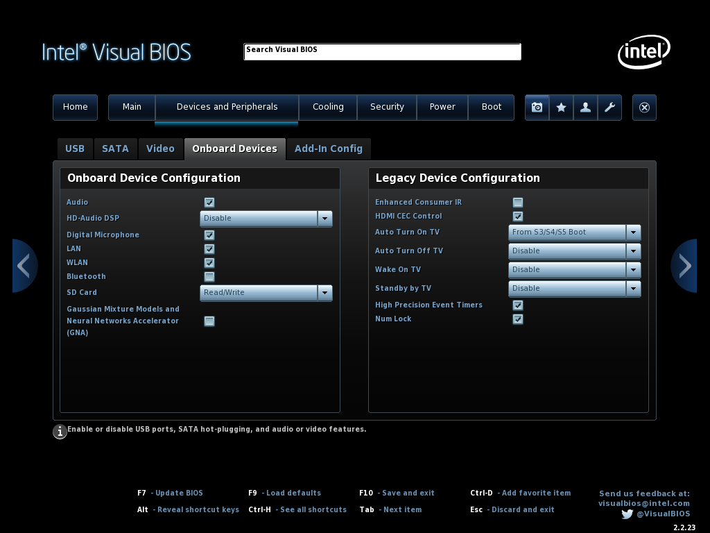

Hi, I'm new here.
I downloaded recent LinuxCNC image
LinuxCNC 2.9.3 Debian 12 Bookworm PREEMPT-RT ISO
and I'm trying to setup to INTEL NUC7 (Pentium J5005 4core /8GB MEM + SSD).
I've read many thread on this forum and I've configured BIOS and GRUB.

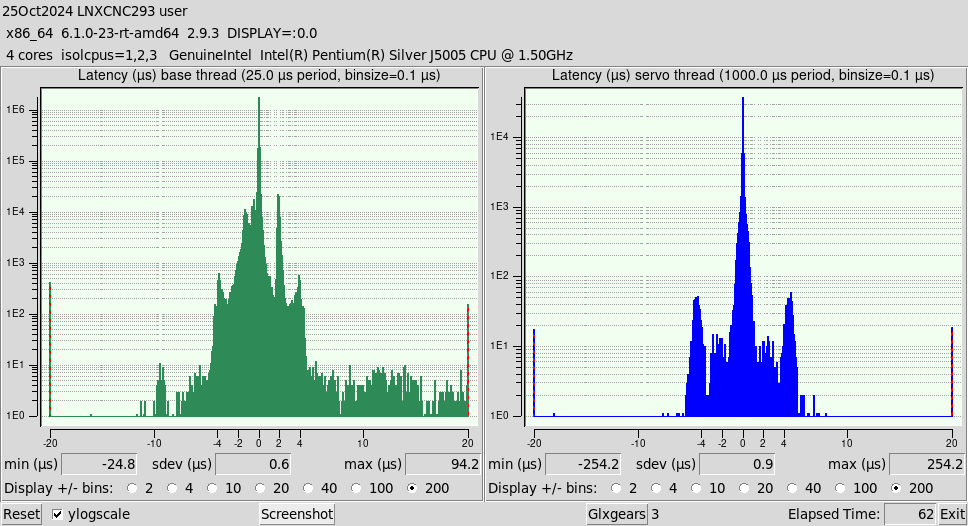

I got this big latency as a result . (latency.png)
What am I missing ?
Please help me solve this big latency.
What I did are
1) I added GRUB.
isolcpus=1,2,3 intel_idle.max_cstate=0 processor.max_cstate=0 idle=poll
2) I configured BIOS (screenshots)

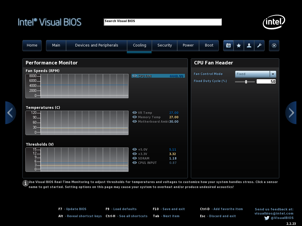

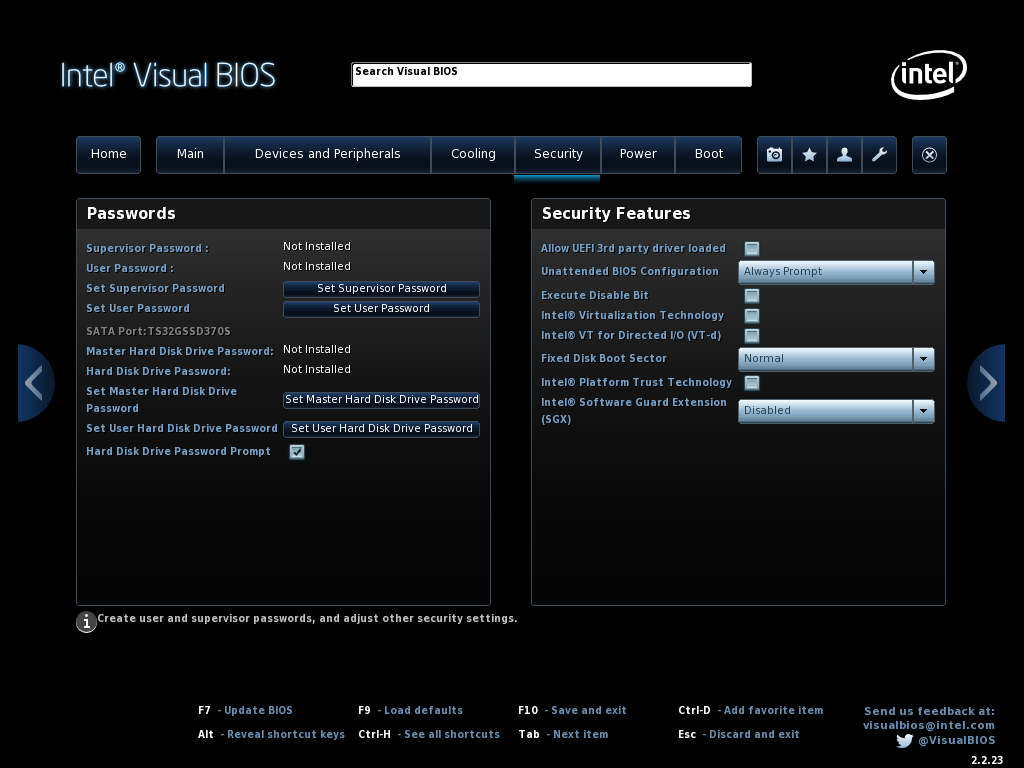

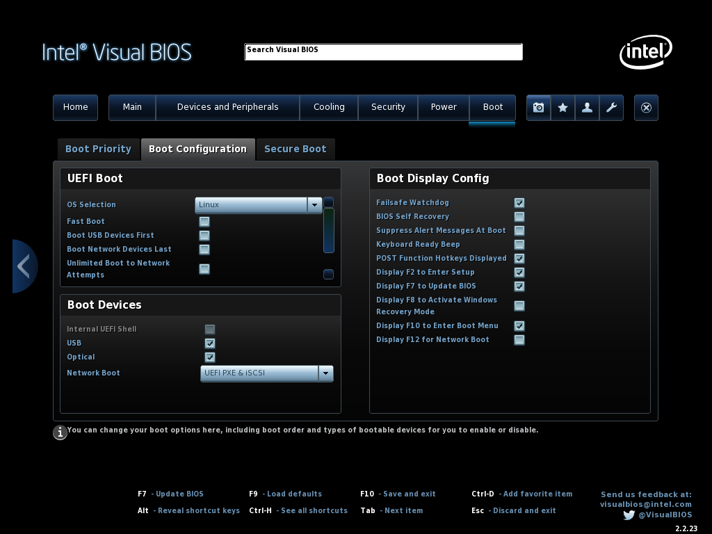

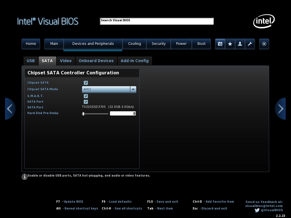

(biosN.png)
Thank you.

Replied by tommylight on topic Help me solve big latency (INTEL NUC7 / Pentium J5005 )
First, test withIf that is still bad, see if you can set the package power limit in BIOS to 0 for both sustained and burst mode,
Then try disabling WLAN it can cause huge latency spikes on some of those NUC's
latency-histogram --nobase --sbinsize 1000 --showThen try disabling WLAN it can cause huge latency spikes on some of those NUC's

by royka
Replied by royka on topic Help me solve big latency (INTEL NUC7 / Pentium J5005 )
What tommylight said indeed. HDMI CEC control off, HDD led off.
And these kernel parameters worked good for me:
isolcpus=3 intel_pstate=disable processor.max_cstate=0 idle=poll cpufreq.default_governor=performance i915.enable_dc=0 ahci.mobile_lpm_policy=1 irqaffinity=0 nomodeset quiet
Bad memory can also be a cause. You can check the following command to see if there are interrupts of other devices on the isolated cpus: cat /proc/interrupts
Did you check the temperature?

Replied by tar_san on topic Help me solve big latency (INTEL NUC7 / Pentium J5005 )
Thank you for your advice, everyone.

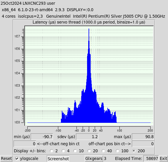

I got this result so far. (90 μsec jitter) really improved.
My question is " Is 90 μsec jitter is good enough to run LinuxCNC with MESA(Ethernet FPGA Stepper) ?
Yes it is good for Mesa, so if you have the Mesa, wire it, pewer it, connect and do some tests, might need some network tweaks, but might be all good.
