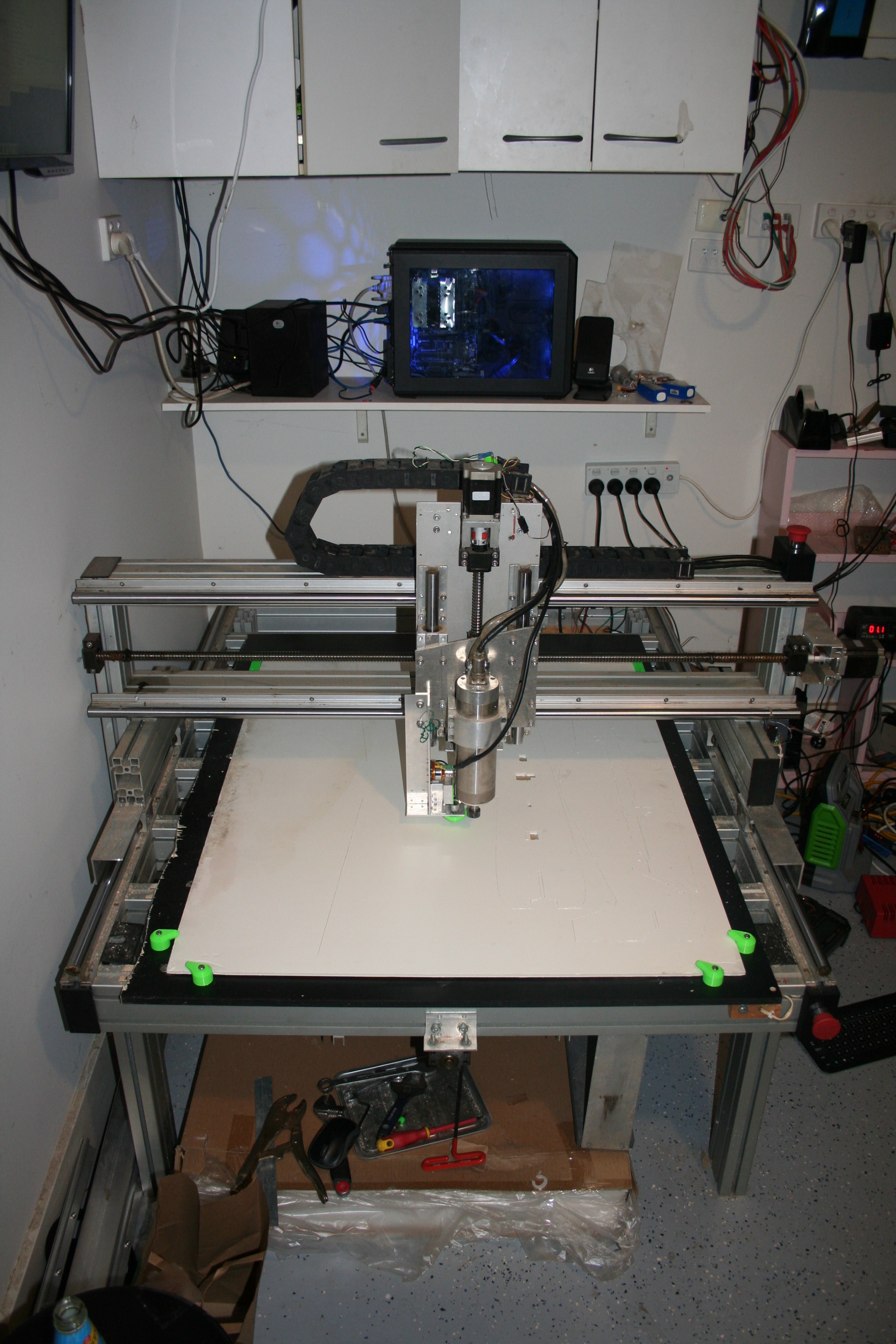

I’m also old school here too with a direct (LPT port conected) gecko G540 . Ali with its very cheap recycled parts, now have my setup which I have been using for the last 10 years. A h81m board with a G3258 CPUcan be overclocked for a even lower latency. The G3258 is 2 core only and fully unlocked. I have overclock set to 4.2 from the 3.2 default with no extra CPU settings.
vi.aliexpress.com/item/1005003864471753....ller%7Cquery_from%3A
A modern N100 board is the way to go but its 4 times the price. forum.linuxcnc.org/18-computer/54979-new...asrock-n100dc#318470
